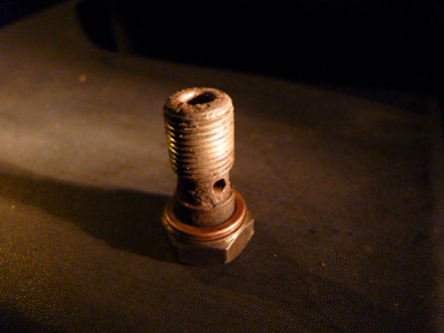

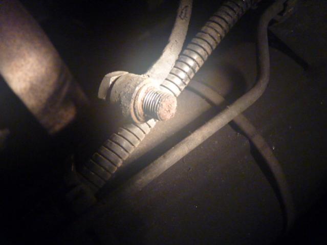

Old Apr 1, 2012 | 11:36 PM
Posts: 16,322
From: Savannah Georgia
And the banjo bolt that holds the lines gets clogged with mud or just dust and condensation (man-made mud).
Attached Thumbnails Coffee-Colored Differential Fluid-p1030610.jpg   Coffee-Colored Differential Fluid-p1030613.jpg
Old Apr 2, 2012 | 06:49 AM
steveo2000's Avatar
Joined: May 2011
Posts: 92
From: Metro-Boston
Thanks again SB. Sounds like I just remove the bolts and clean them out?
Old Apr 2, 2012 | 08:00 AM
Posts: 16,322
Yep - and blow out lines with some air from a can or compressor.
