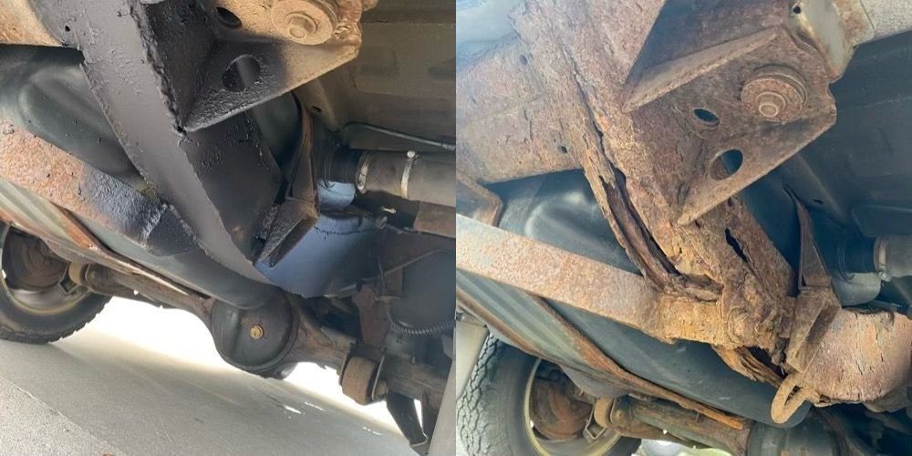

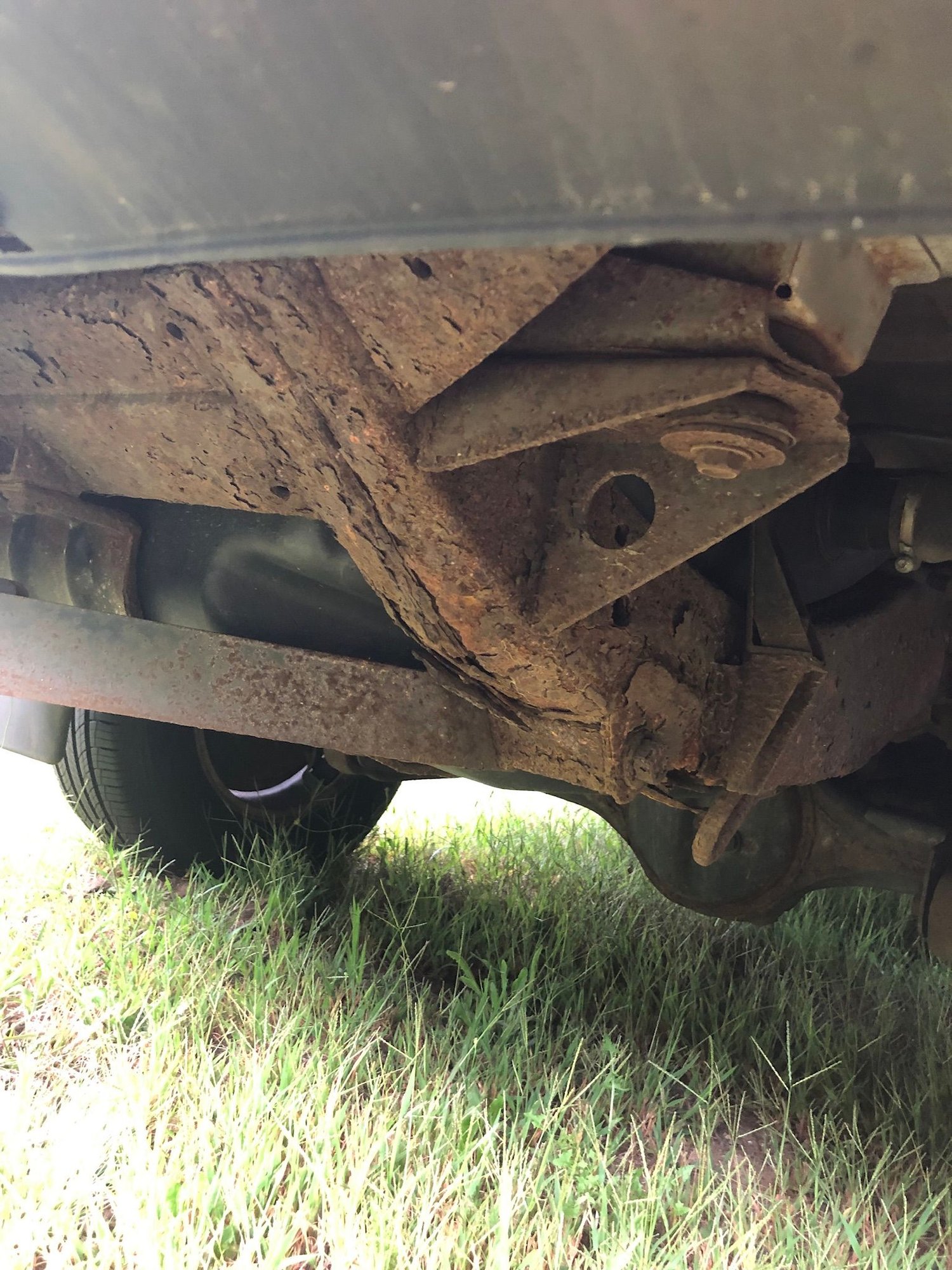

99-02.
1st thing to do is crawl under the rear and look at the frame. Any kind of swelling and it's going to be a problem.

Re: frame swelling. This was over the course of one year.
