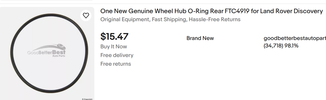

Removed the caliper and is as dry as can be. Its rubber gasket is also dry. No leaks at all there. The disc and the inner brake pad are oily probably leaking from the axle.
Back to page zero, now with an extra trouble. To replace the o-ring behind the rear hub besides the disappearing brake fluid.
Which one is the robbery...

Did you say "rubbery"?
