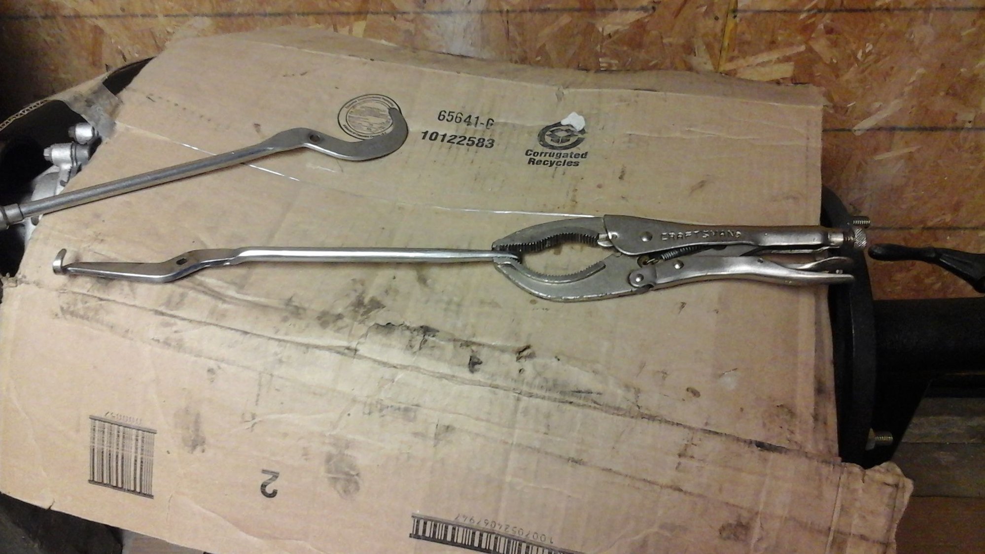

If you use a 1/4 inch drive ratchet, swivel and extensions, you can get nut closest to block easily, outer one is easy to begin with.
Made a tool, out of an old brake tool - but could be made from a piece of steel rod, to hold the upper portion of the connection, it slips around the harness wires and top side of plug and allows you hold upper portion, then use your other hand to push CPS plug in. Since it impossible to get two hands up there at once.
Put a set of visegrips on it to give me more leverage to pull upper plug down. Slipped the tool between inner fender and frame to achieve mission impossible.
Also, it's easier to remove sensor if you are laying with your head towards front of vehicle and legs towards rear, you can get a good eyeball at things this way.
The previous poster is talking about the two spacers that go on the studs, if you install then wrong, CPS will go into the flywheel to far and bend end of sensor. Rendering it useless.
