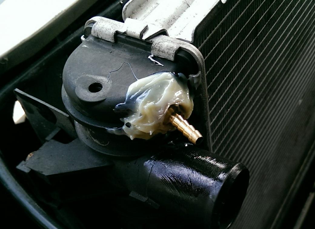

So I've been pretty annoyed to have to get a new radiator just because a stupid plastic nipple broke off. Everything else about the radiator is fine and as I mentioned it is a Nissen and looks very new in terms of overall grime compared to the rest of the truck.
I found this thread:
Could this be a possible radiator nipple repair? - Land Rover Forums : Land Rover and Range Rover Forum
and decided to do the same as what the guy did at the very bottom. Disco Mike (what happened to him BTW? He does not seem to post anymore) says brittle plastic will bite you in the butt, but in my case the plastic is newish and as I was drilling, it was not brittle at all. See final product below.
I figure worse that can happen is the fix does not work and I need to order a radiator anyways. But if it does work, it is only cost me $3 at home depot and a bunch of epoxy I had lying around. This saves me money, but also time, as radiator removal/install seemed to be the biggest part of the job.
As of right now I have shroud, hoses, thermostat, fan and viscous clutch on order. Still need to order an air box top and an intake tube since both of those are damaged beyond repair. I'm pretty sure my BOSCH MAF is still good since I just got it and I managed to fix/solder the connectors.
Once my parts arrive, it should not be a long job at all to put the fan and the hoses back. Then comes the part of figuring out how to fill the thing with coolant again.
