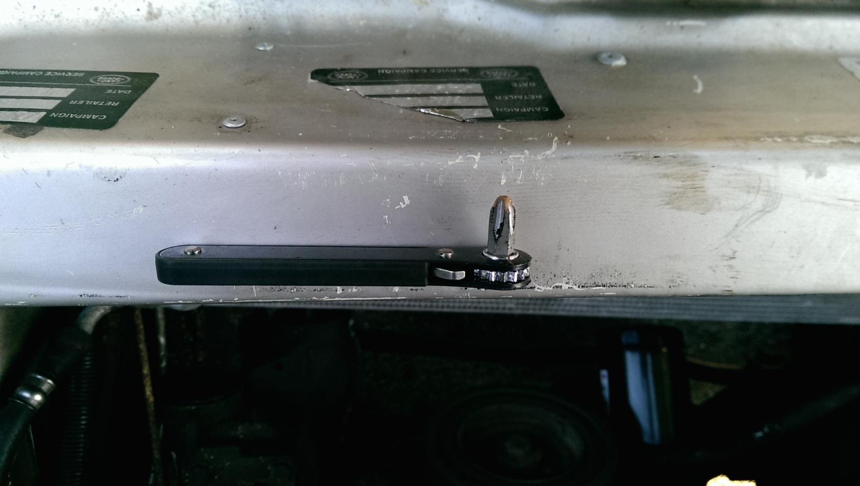

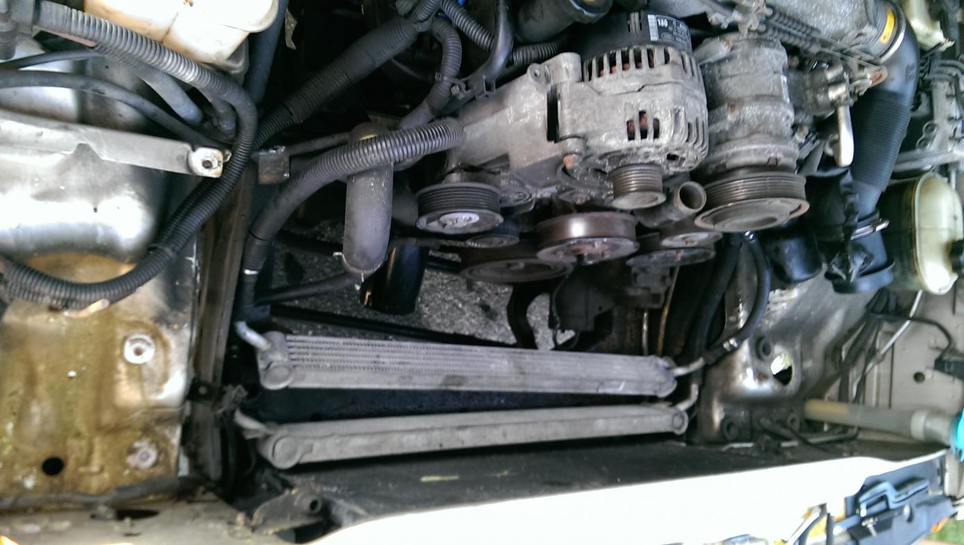

Well, I decided to take the old radiator out today while waiting for the new one to arrive. After reading just about every thread on the subject, I decided to ignore the RAVE manual approach and use the "remove air box and battery box" approach. The primary benefit is that it seemed easier and did not involve disconnecting the oil lines which I wanted to avoid doing at all costs. I followed the pics in this thread:
https://landroverforums.com/forum/di...uestion-58055/
Great success! It took me about 1 hour to get it all out and about 30 minutes of that was dealing with a single nut that was stripped and would not loosen. Now that I've done it once, I could do it the second time around very quickly. It was no where near as hard as I had imagined.
The tool of the hour was this little 90deg ratcheting screw driver that I have that allowed me to un-screw the screws bolting the oil coolers to the radiator. See pic below. Made the job a breeze.

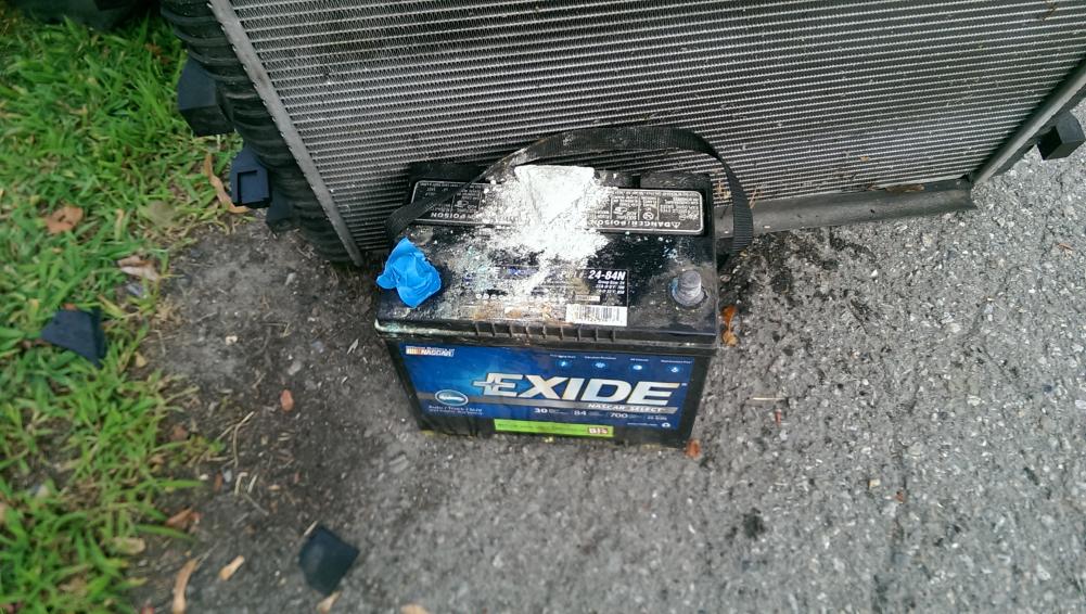

Of course the money pit issue continues since I discovered that my battery was leaking and was covered in all kinds of residue. I never changed it since I got the truck, so I need a new battery. Will it ever end?

You can remove the radiator without removing the battery box, air box and coolers. I don't understand why you need to remove the battery and air box. All the bolts and screws are accessible from the front.
well, keep in mind that I've never done this, so I chose one way to do it that was documented here on the forums.
It seems like you either remove the air box and battery box, or you remove the front grill and horns to get to the radiator screws. I did not want to remove the grill, so I choose to go the battery and air box route and keep the grill in place.
Now that I've done it, I can see that if one had a very long phillips screwdriver, you could do it from the front without removing the grill or air box or battery box but you'd be fishing in the dark in terms of getting the screw driver to align with the screws and I'm not sure how you'd get them back on again.
A few plastic screws at the top and the grill just lifts right out, horns are one nut on each but, you got it done, that's all that matters.
