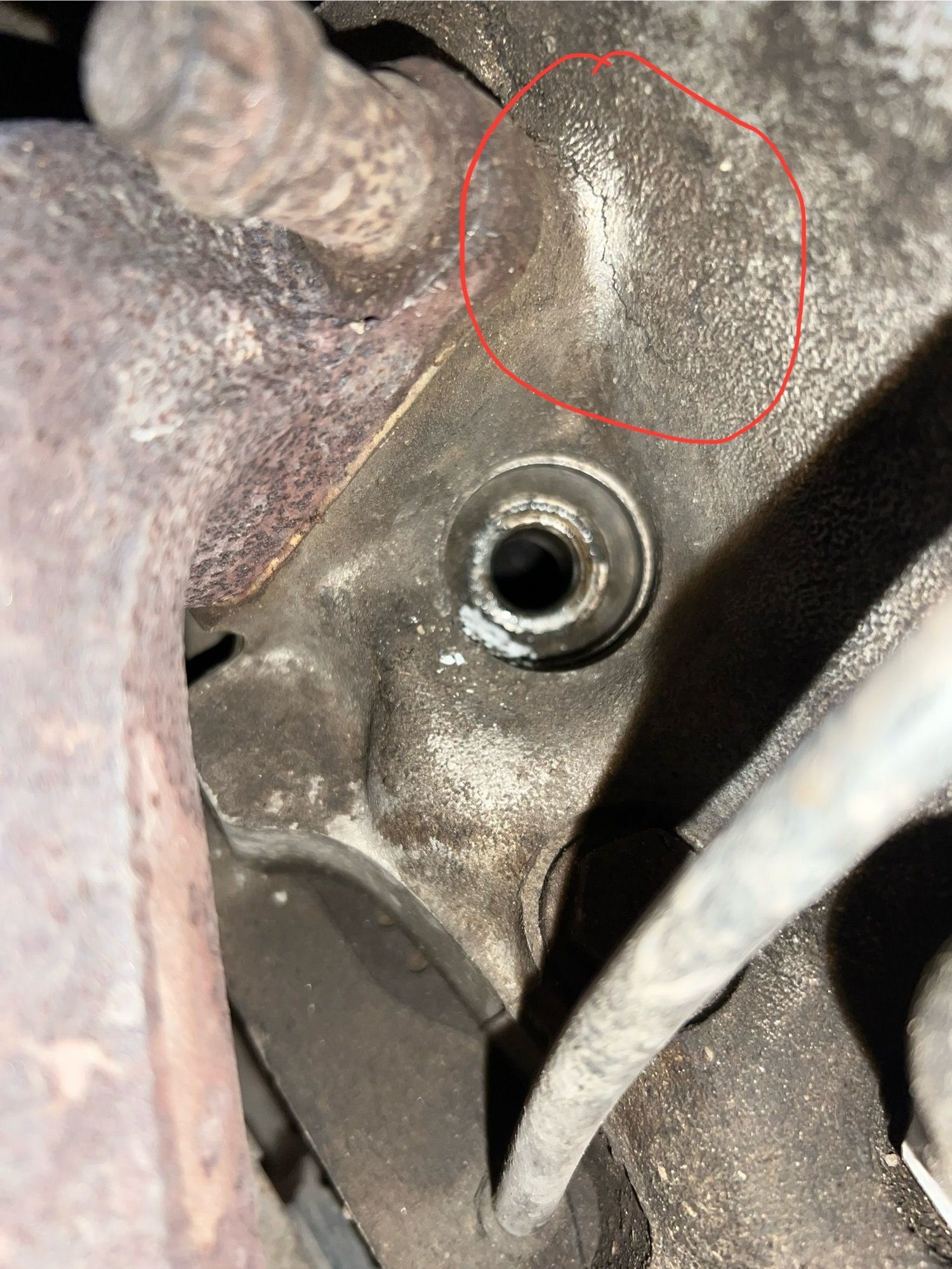

I have switched the spark plugs and nothing changed. Wires are good too. Only concerning thing was wet and black spark plug at cylinder 7. Other plugs were clean and dry.
I bought new knock sensor yesterday to be sure its working and not showing fake values. it should arrive at monday.
Second thing I noticed was a lot of white smoke coming from the exhaust when idling, though it disappears when I start driving. Could this be a problem with the valves strictly at cyl 7?
And the last thing and probably the worst is crack i found near cylinder 3. How bad is it?

How bad is the crack? The good news is nothing is leaking out. The bad news is a boiling coolant reservoir could be from exhaust leaking into the cooling system, for example a bad head gasket, or a crack between the exhaust and coolant passages in the cylinder head. Maybe try using a tester with the blue liquid chemical that turns yellow if exhaust gas is detected. At least, a compression test is in order.
PS White smoke could also be from coolant in combustion chambers.
Try scraping the crack with something. I had something that looked similar and I thought it was a crack, but it was just oil residue.
