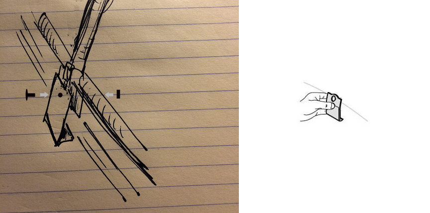

I missed how it attaches. I see the steel tabs inside the rain gutters, but don't see clamps.
Amazing write up. Love that it's square tube as well.
For $175 I can imagine you would get takers for a "weld it up yourself" kit.

Awesome write up. I too am interested in the clamps you devised if you have any additional info.

Default Roof Rack Anchor
Here is how I recommend to anchor the roof racks. These door clamps are worth a couple dollars each at Princess Auto or Canadian Tire. As an alternative, you could bend a piece of steel and that'll do the job too.
Attachment 24022
I had an "urban off road" rack and the roof clamps would hit the top of the window frames when opening the doors. Do you have any clearance issues with yours?
Attachment 24022
Hello,
Can you add pictures of the clamps attached and clamp dimensions please?

Default Adding clamps to design
Originally Posted by LSwain
Hello,
Hello all,
Backed by popular demand, I will be modelling the clamps and adding their dimensions and completed photos this week. I will release V1.1 .PDF as soon as that's done.
