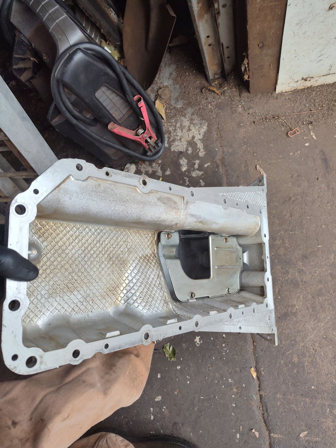

Did get some cleaning done. All the rods and pistons have been ultrasonic cleaned. Got the oil pan clean, surprisingly enough the pain is an aluminum finish and not black. Why are all my rover oil pans black? Is it an active rust prevention system???
Heres an oil pan not covered in gunk.

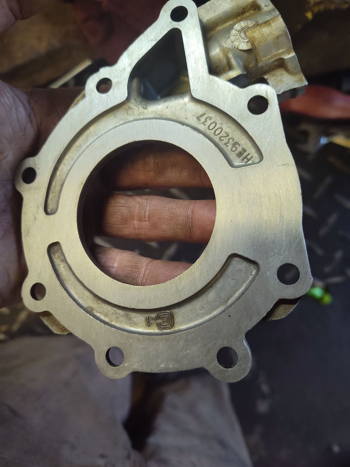

No shocker that I had some oil pump housing scoring. Laid some 220 down on a true workbench, covered it with dawn and water, cleaned it up pretty quickly. Much more on the cover than inside the housing.
