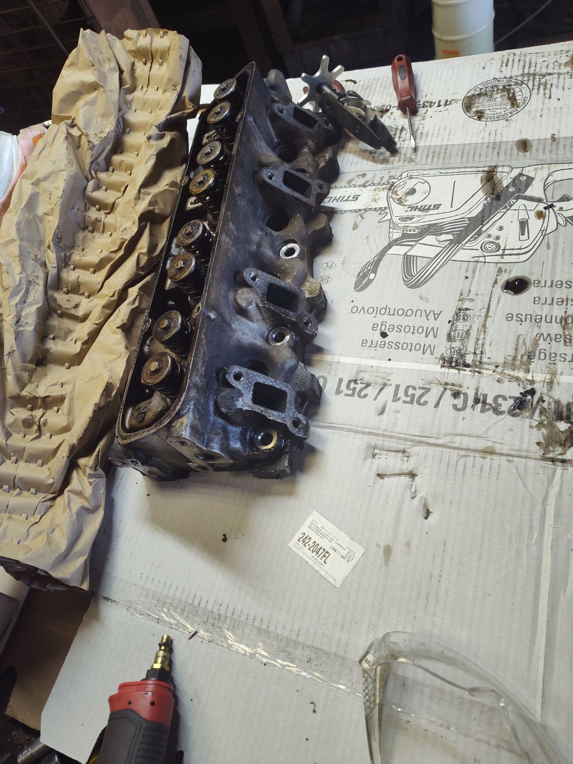

A little more progress

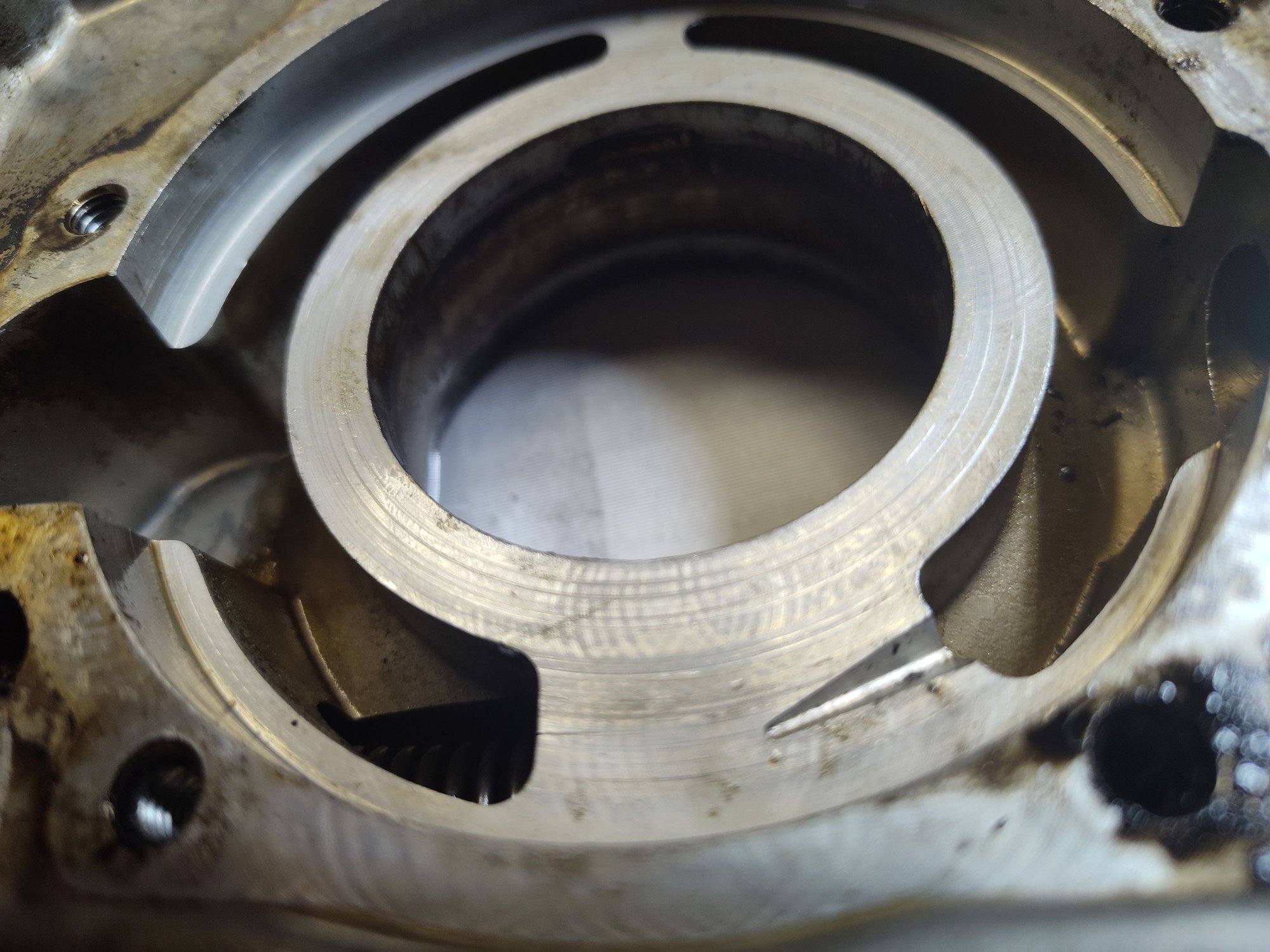

The 4.6 goes to the heat vat tomorrow. Finished cam bearings coming from Turner in the UK next week. Looked into purchasing a cam install tool but after looking at block I think I can use seal install tools. I have a 6ft piece of 3/8 all thread I use from installing the front inner axle seals in my Ford excursion. I believe I can do the same with these. May freeze them to make them slide in much easier.
Any opinions on removing timing cover dowels? Leave the dowels?

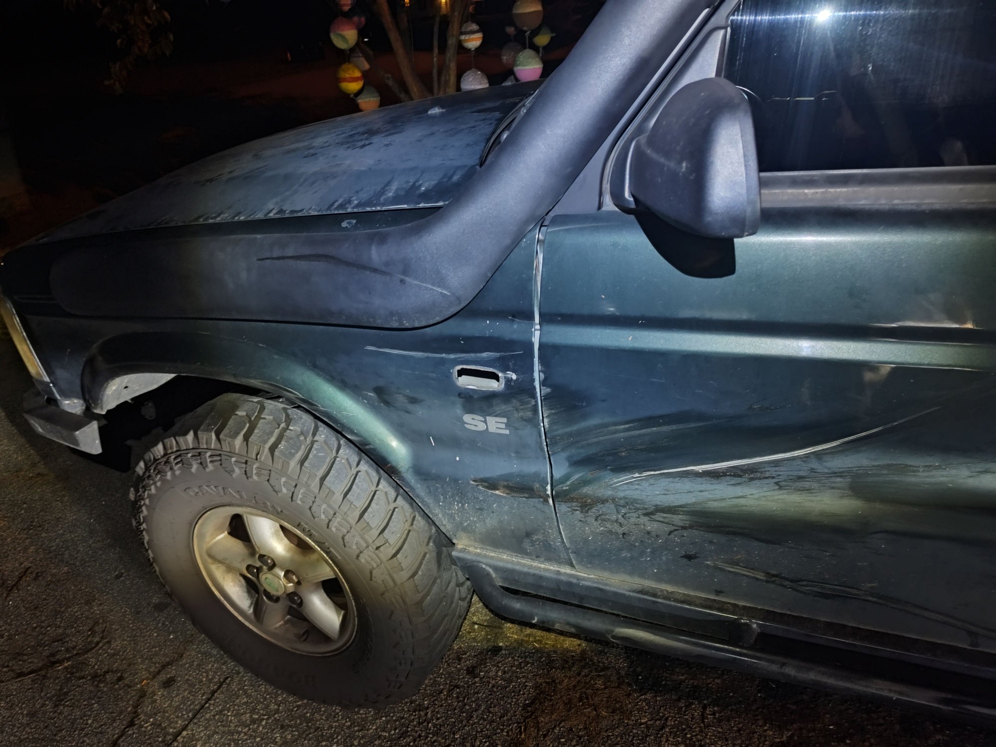

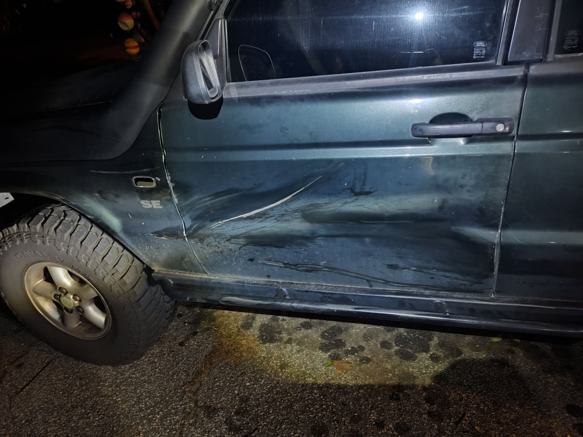

Now I really need to find another parts rover. I have a good green door I can take from the 03 but this was already the good 03 fender.
The deer was mad I kicked the mice out of their engine home.

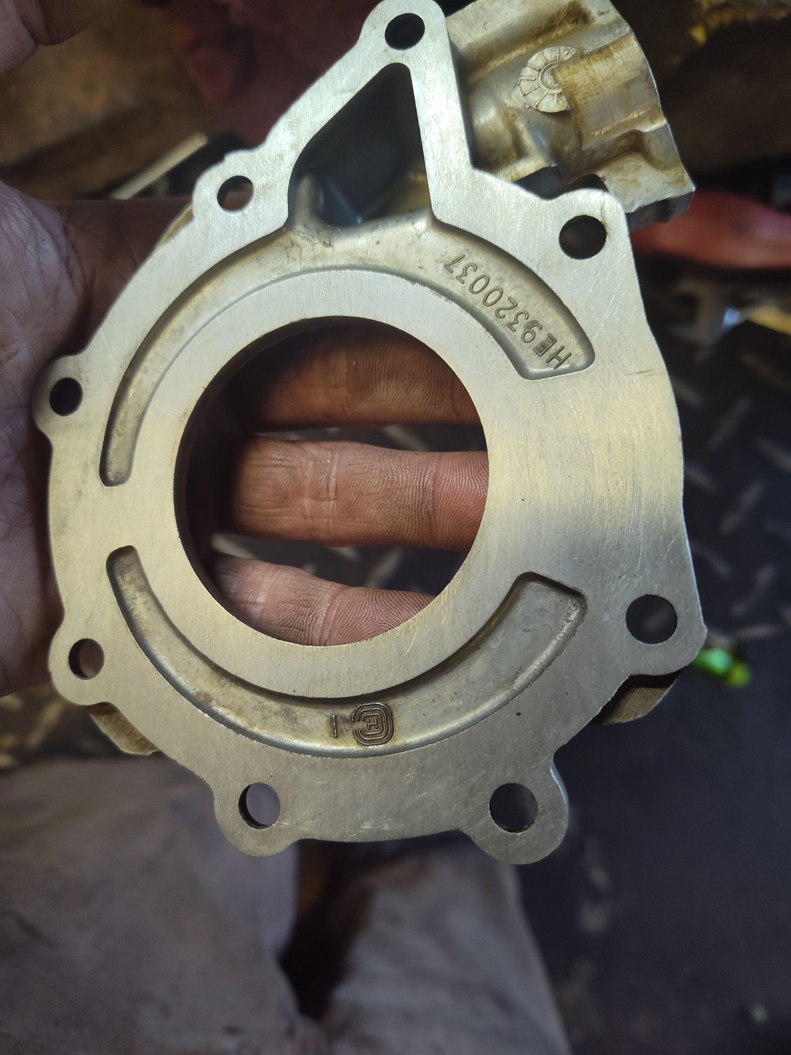

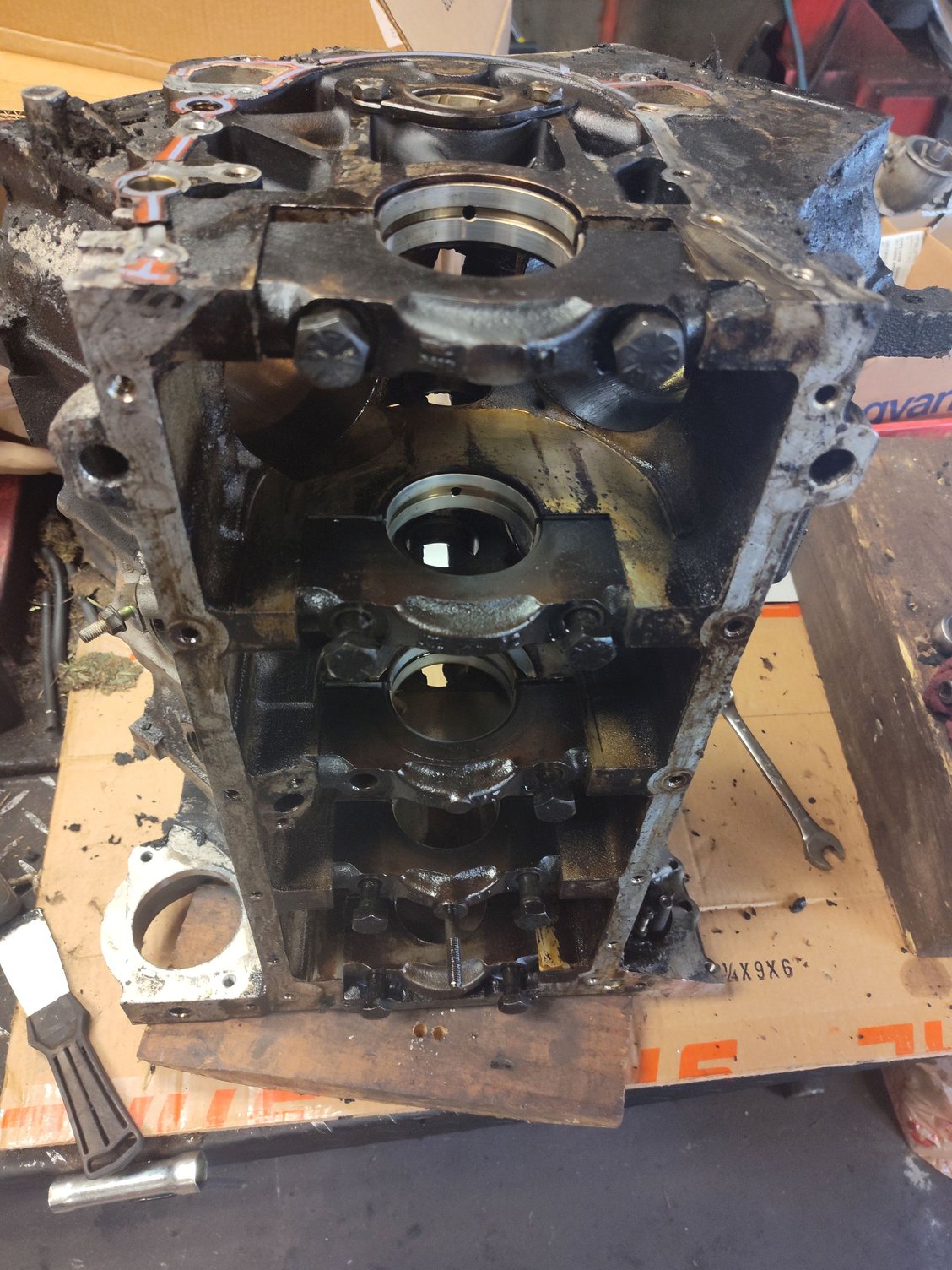

4.0 daily driver. Cold oil pressure is spot on. Warm 2k only oil pressure is good. Idle oil pressure is sub 10 psi. Recent OEM oil pump install. No coolant loss. 240,xxx or so miles.
Heads recently done.
Warm idle knock. Goes away as oil pressure rises with rpm
So long as the main and cam bearings didn't completely go and damage the block she's getting the low mileage 4.6 rotating assembly with all new bearings.

Maybe only use one dowel for front cover, if worried about alignment issue. Thicker oil for knock at idle? Thanks for all the photos.

I'm planning on using the 4.0 block for this one. The 4.6 block is a bit of a gamble. I have actually removed both dowels from the 4.6 block. Still contemplating what to do with it. Another disco purchase is in our future when another deal comes along. I've found a few but been too busy to make a 2-3 hour drive.
