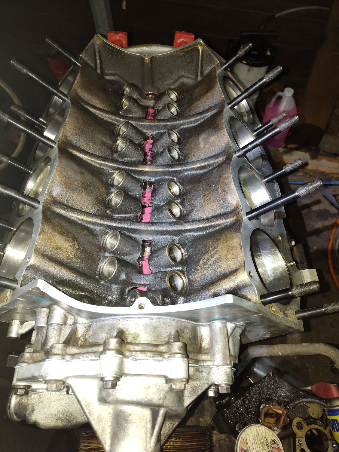

P
Pistons installed. Getting the ring gap properly set while minding avoiding the thrust side of the cylinder is fun....to do 8 times.
It will be much easier to install the pistons without the head studs installed. I'm too lazy to fight them in sub freezing temps so they stayed minus one that came out with the nut. I never bother to loctite head studs in place. When assembling in the vehicle you can't have the studs in place unless you want to raise the back of the transmission and even then you might not have the room to raise/lower the head especially on the NA driver side.
I have new lifters to pair with the low mileage 4.6 cam.
If the snow holds off this weekend I hope to get the transmission set back in place and reinstall the interior.
Really wish I had time to get the block hot tanked before reassembly but the race shop has had my 4.6 block for over a month and she's still not done.
I may do a seafoam treatment or two after the break in period along with a few frequent oil changes.
