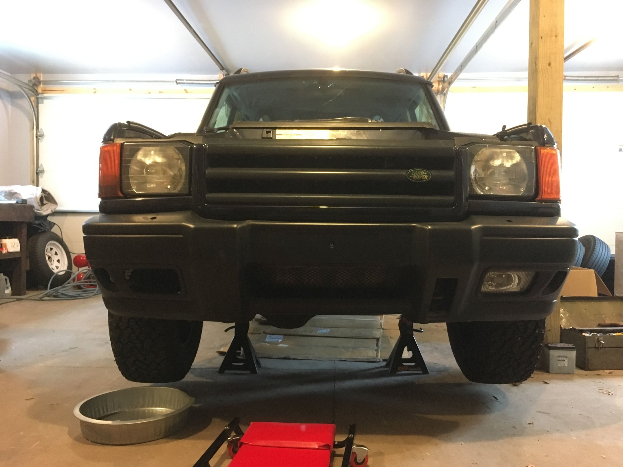

Hi Folks. For those who have done your head gaskets, did you drain the coolant from the drain plugs in the block per RAVE or can you get enough out with the lower radiator hose? I'm digging into it this weekend.
