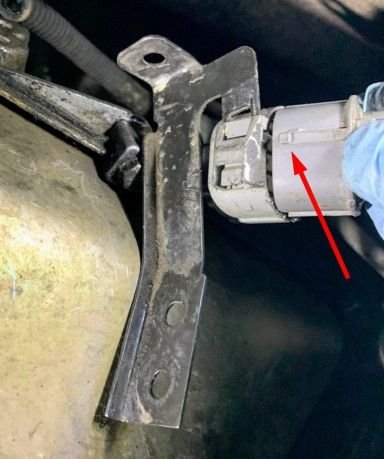

+1 for cleaning the switch. Loopy, I hope it was faulty, not just dirty.
I found that HandyHowie has a nice write up, but he omits one critical detail: The plug (on my 2000) won't release until it is taken off the bracket, which locks the plug in place.
In fairness, Howie's is a '99, and may not have this bracket. His images show the internal gasket, and a little silicone grease will refresh the seal.
-g
