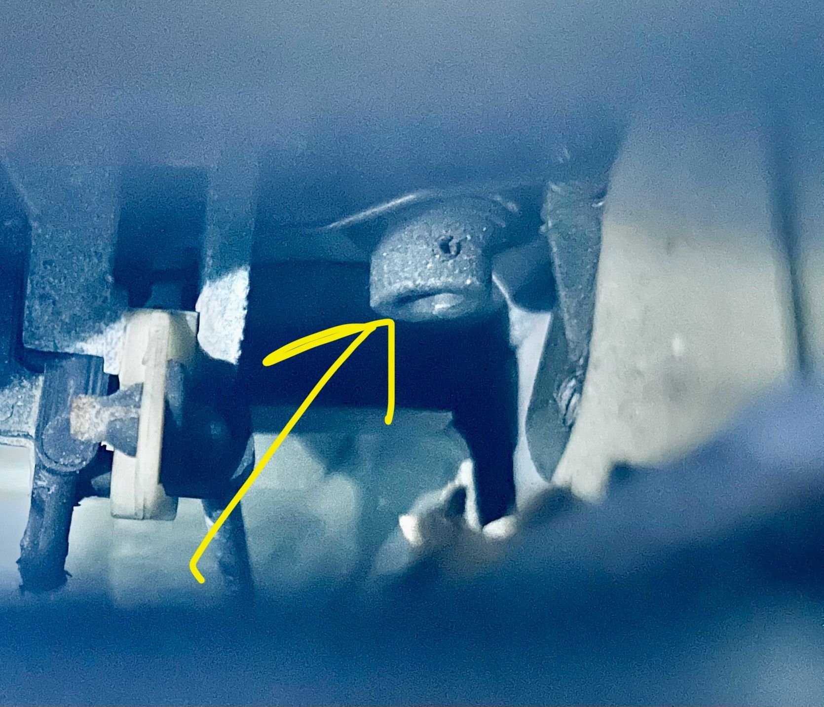

My 1st post. Pls go easy on me. I am new to all of this. I have read many D2 related threads, D2 manual & workshop manual. Need advice before do something that makes problem worse. D2 is Grand Cayman. I split time FL & Cayman2000 Land Rover LT Discovery Series II
Right Hand Drive
Style / Body: Hardtop 5 Door
Engine: 4.0L V8 MPI
Country of Assembly: United Kingdom
Problem Description:
  1. Accidentally locked Driver-side Door with door sill lock button and can’t open the door.
  2. non working RHD driver-side door lock with Door lock pin removed prior or sheared off.
  3. Won’t unlock with interior door handle
  4. Key doesn’t turn clockwise or counterclockwise in the door lock, not sure if can insert all the way
  5. Working Ignition key
  6. no working FOB/Transponder
  7. CDL Switch doesn’t work
  8. Front passenger, left & right back passenger doors & rear taildoor all lock with door sill locking buttons and unlock with interior door handles
  9. Since we owned, we Never lock Driver side Door. Seller said “Alarm was disabled” but how he disabled I do not know.
  10. Car starts & drives ok but have to climb over the passenger seat to get in & out; a real pain especially during hurricane season
  11. Since door doesn’t open, can’t access the Door Handle Lock screw on Door Jam
  12. Can’t remove interior panel to access the door actuator to disconnect electrical connector, or interior parts remove door handle or replace door lock pin.
  13. We need to get the Driver side Door open without triggering a SuperLock, AntiTheft System or Engine Immobilization and without damaging the door or window.
How could we expect LR technician with all the right tools & diagnostic/programming computer to unlock? I've heard some interesting solutions I'm afraid to even try (ie, destructive to door &/or window, has stumped our auto mechanic with some LR experience & the auto locksmith. Some promises to fix for $300 or more with no details on the how, scarier. Hence the question. I'm not very trusting.
Will this work? Or do I not need to worry about any or some of this?
  1. Open front driver & passenger windows, unlock & open the 4 remaining doors, including taildoor, & bonnet & fuel flap. BCU inputs should be Front Left & Right Windows switches - Down, All Door latch switches Open except Driver Door, All Door lock switches Unlocked except Driver Door. If car tries to lock, it should trigger Mislock if car tries to Superlock, trigger Alarm or enabling engine immobilizer.
  2. Put key in ignition. Do also need turn to position II or III?
  3. Not sure if key will go into door lock. For sure it doesn’t turn. Not sure how BCU handles key in ignition same time key in door.
  4. Slip tool to simulate door lock pin down inside of door to engage the door actuator where the Door Lock Pin should be and turn to counter clockwise to unlock the door.

looking down into driver door, missing door lock pin

If you are able to borrow a Nanocom or other sophisticated OBD unit, you can easily disable Superlock entirely. That will remove the concern entirely.
Aside from that, your biggest problem is going to be:
  1. Slip tool to simulate door lock pin down inside of door to engage the door actuator where the Door Lock Pin should be and turn to counter clockwise to unlock the door.
The door lock pin goes in horizontally. You're going to have to craft something that can rotate the lock pin socket, possibly by "straddling" the retaining pin that you can see is still in place. Even if you can get something in there, it needs to rotate by about 90 degrees to unlock the door.

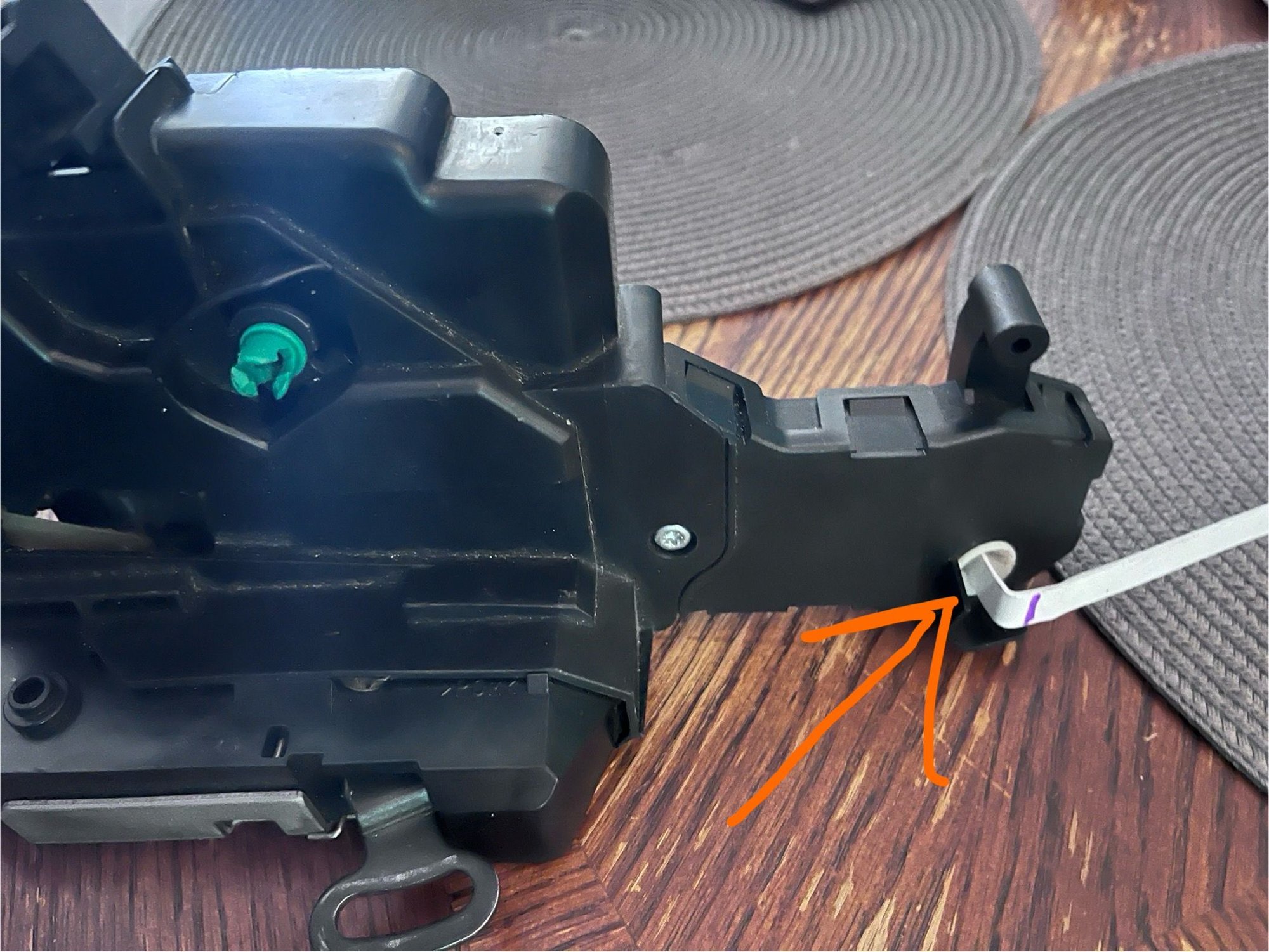

Default LHD Door Lock Actuator w/crude tool
I have simulated unlocking with hand made tool & screw driver on a spare LHD door lock actuator. See pic. Not much space to work with in situ.
Unfortunately, can't borrow a Nanocom or other OBD unit. charge is 150 per hour, min 1 hour. 250 for one guy who says he has tools & OBD unit to unlock but can't guarantee won't inflict more damage.
May have to pay, but darn, where is the satisfaction in that?
Thx for your help!
