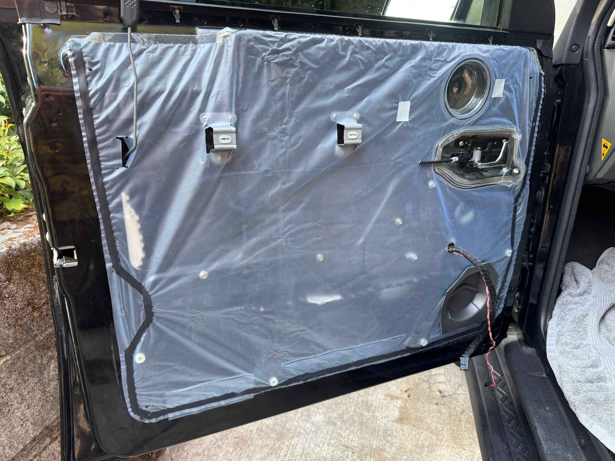

Original door water membrane held up pretty well, usually they are way more thrashed than this. From service history, I think this door has only been open once to replace the regulator in 2014

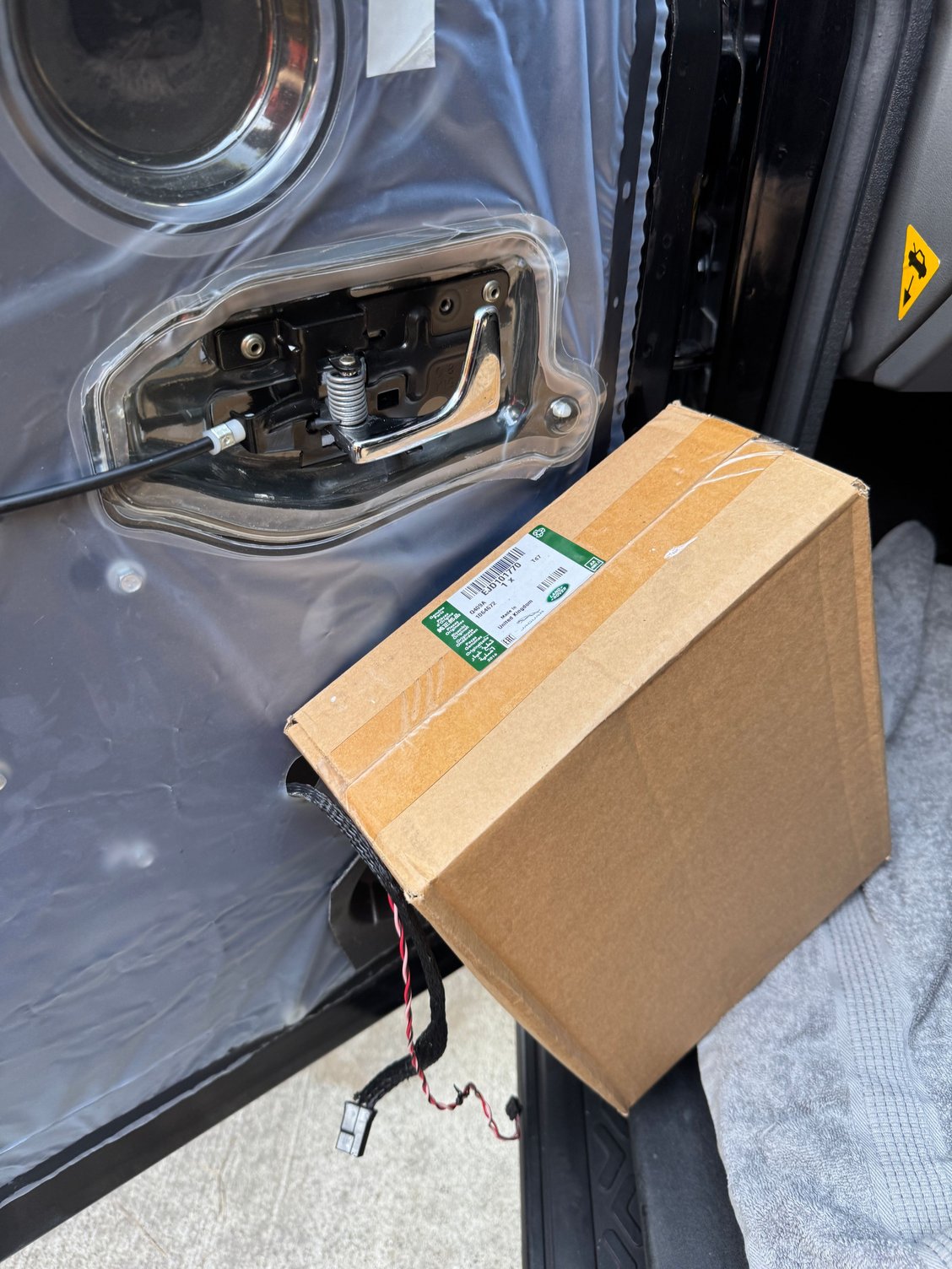

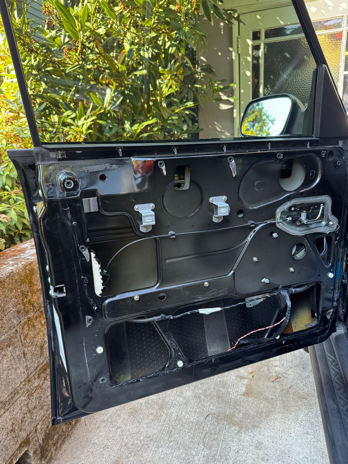

Reference photo of door with water membrane removed

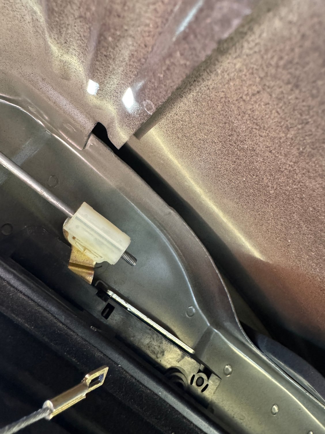

Clip holding rod from Exterior Door Handle to Latch

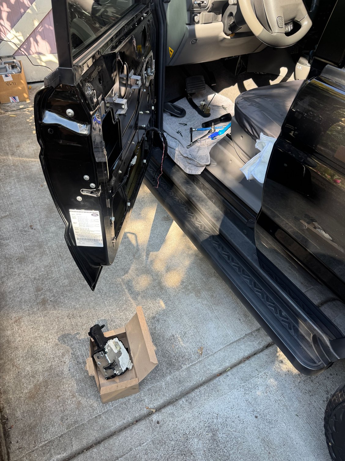

Old latch on ground
Old latch on ground

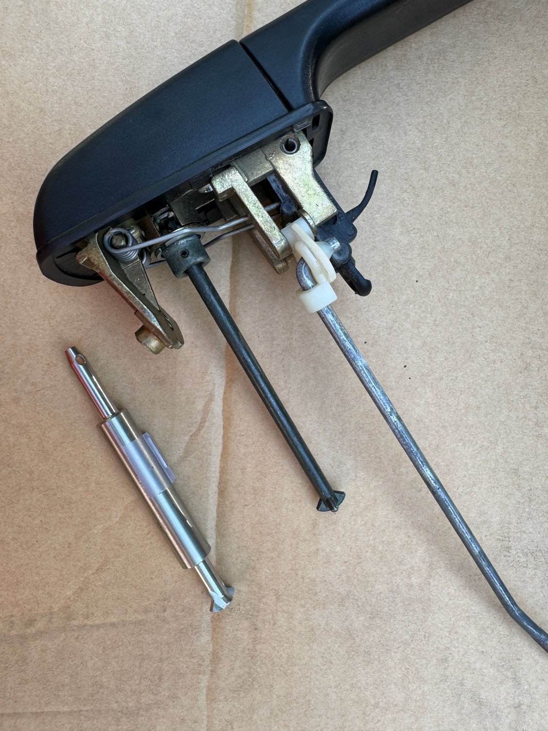

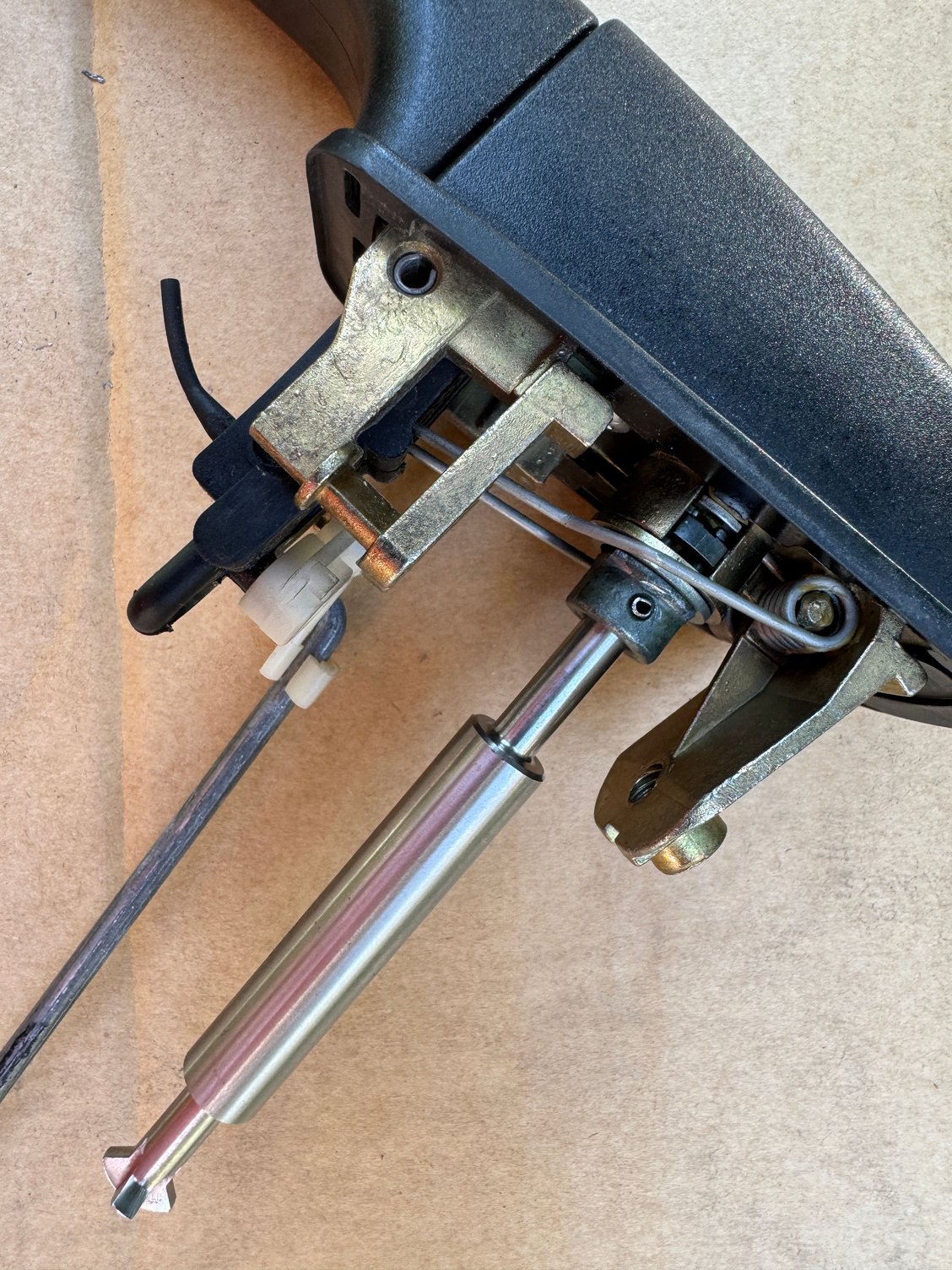

Rod with Pin
Rod with Pin
Carrs4x4 steel rod done

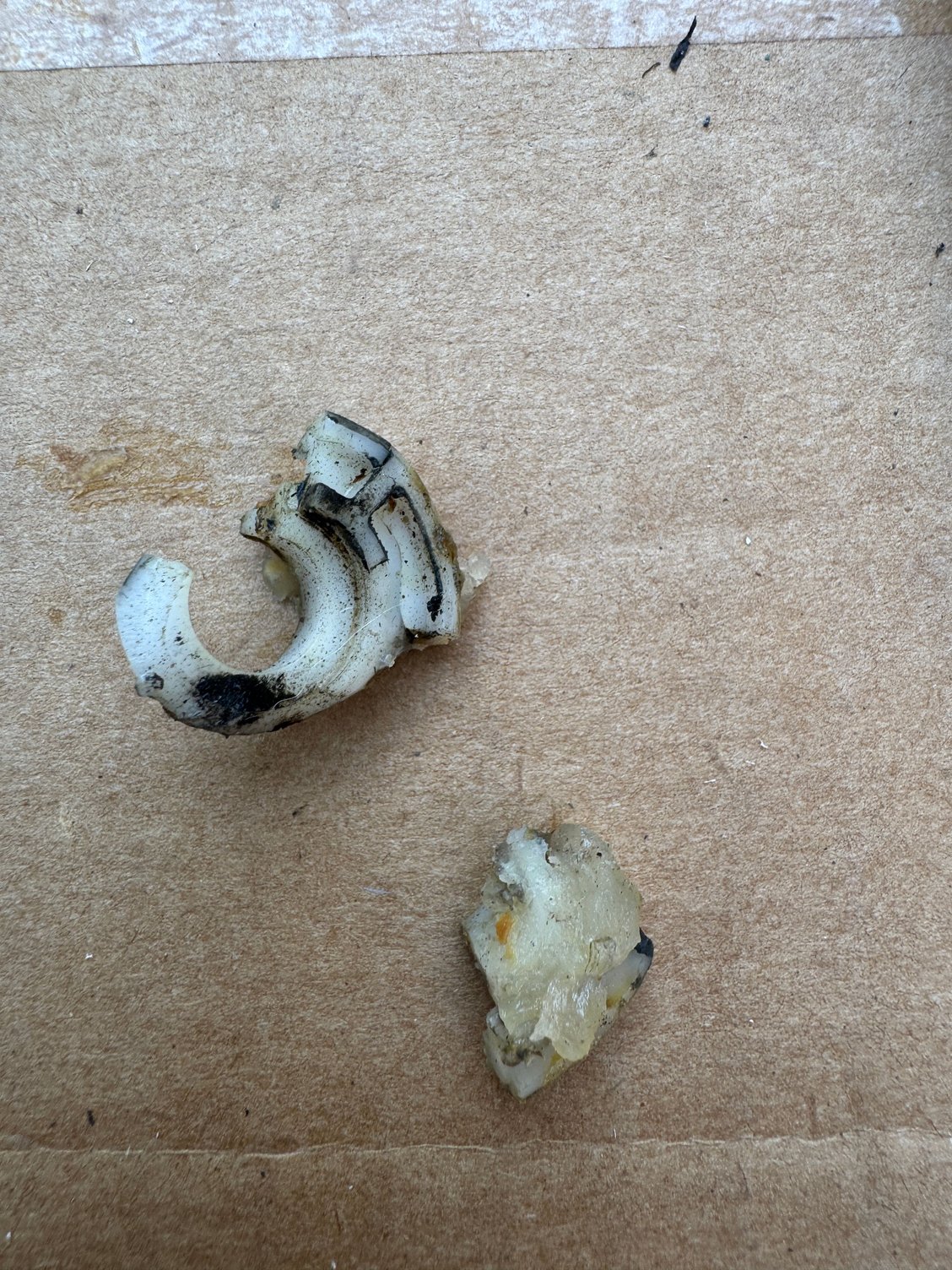

Broken window rollers from dealer repair over 10 years ago in bottom of door

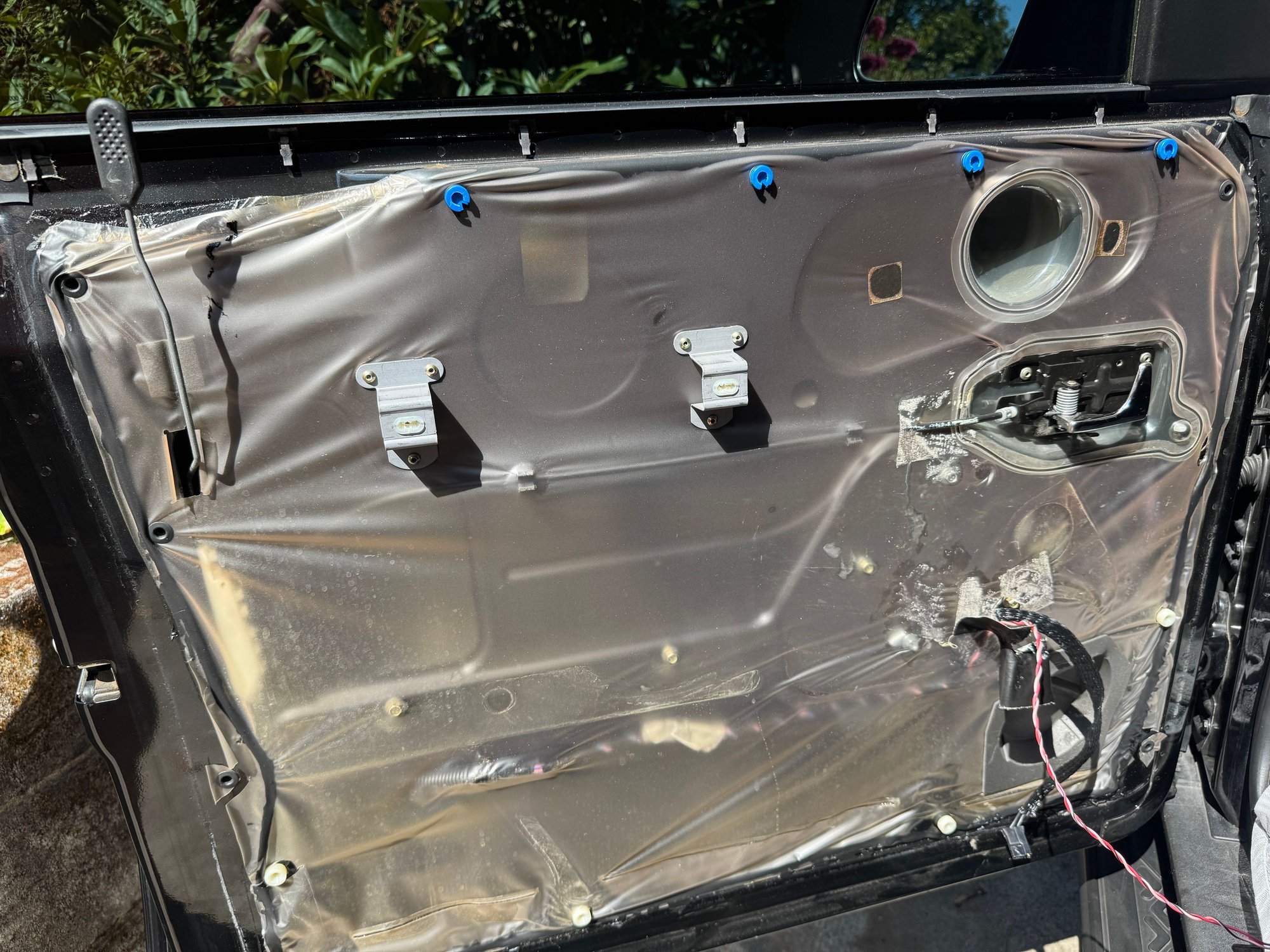

I didn’t actually remove the door pull and those mount points for the handle mounts - that would require re-riveting - waste of time - I carefully cut around them, good enough.  I also just punched thru the clip / screw holes...

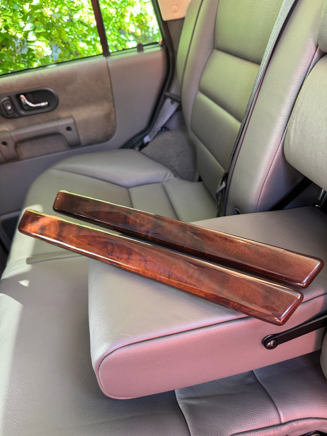

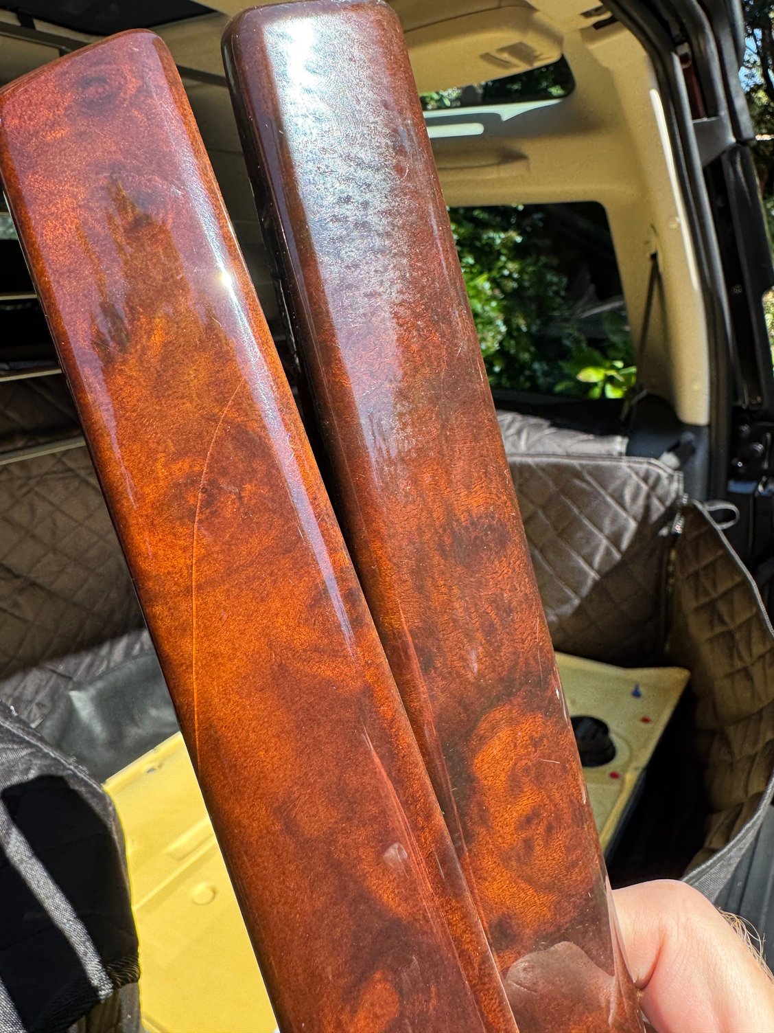

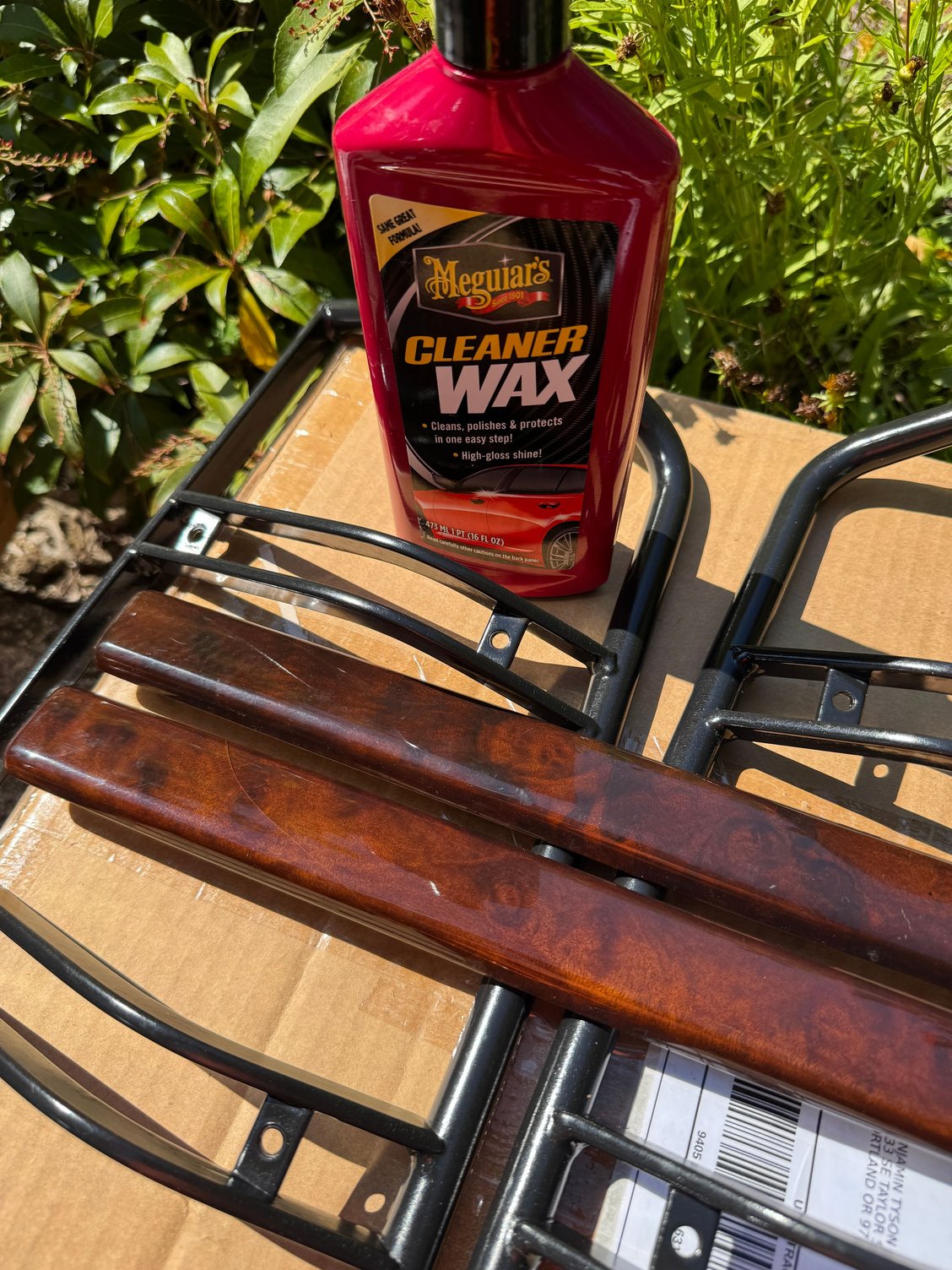

Original 1999 / 2000 wood on left had a crack
Cleaner wax took junkyard wood piece to new looking btw.
