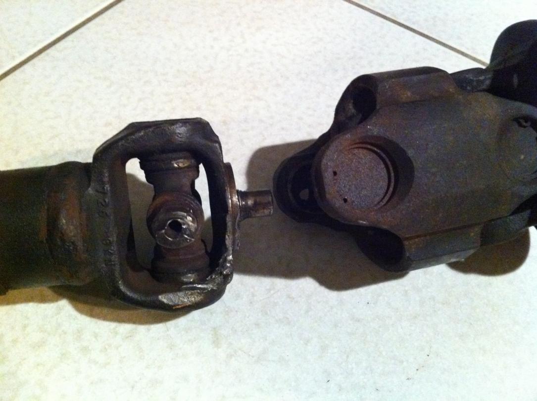

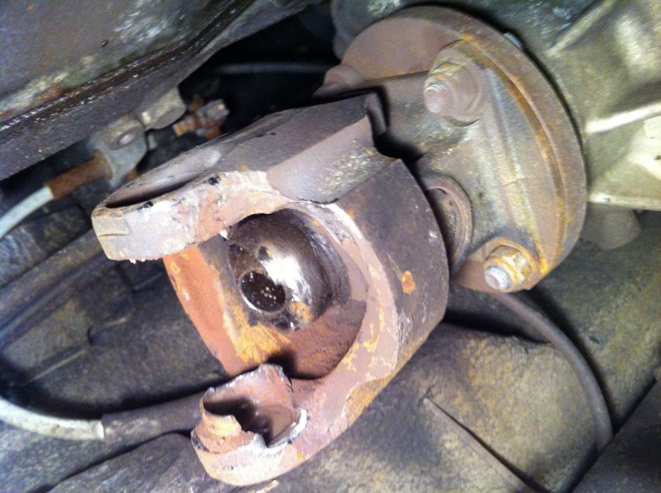

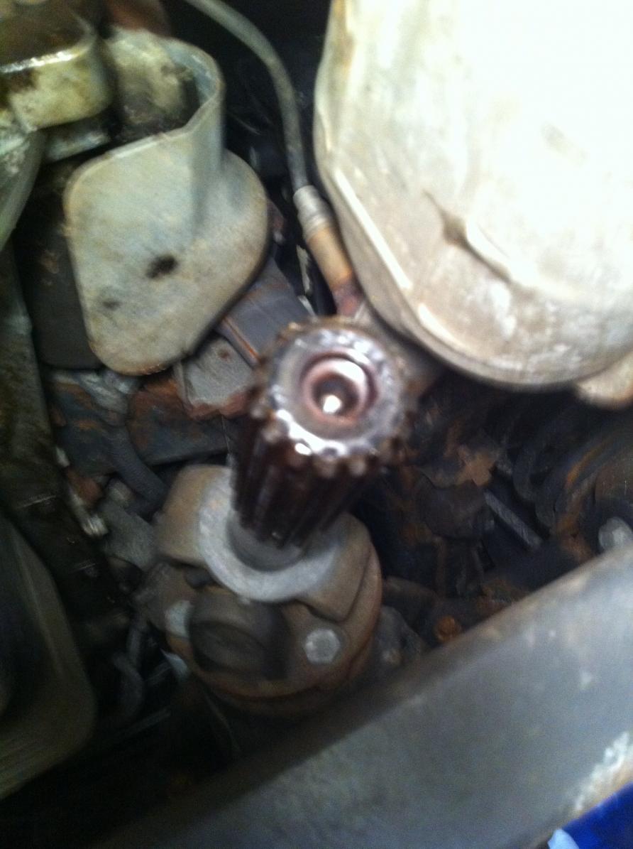

This is what they're talking bout. I got real lucky. Mine let loose 4 weeks ago. No damage to transmission. Just had to be towed ( $ 265 ). Too much damage to be fitted with new
U joints. Had to buy rebuilt Front drive shaft. Go to " Sticky: Write Ups, How tos, ....."
under Drivetrain. 2 good write ups by Antman and Antichrist.
