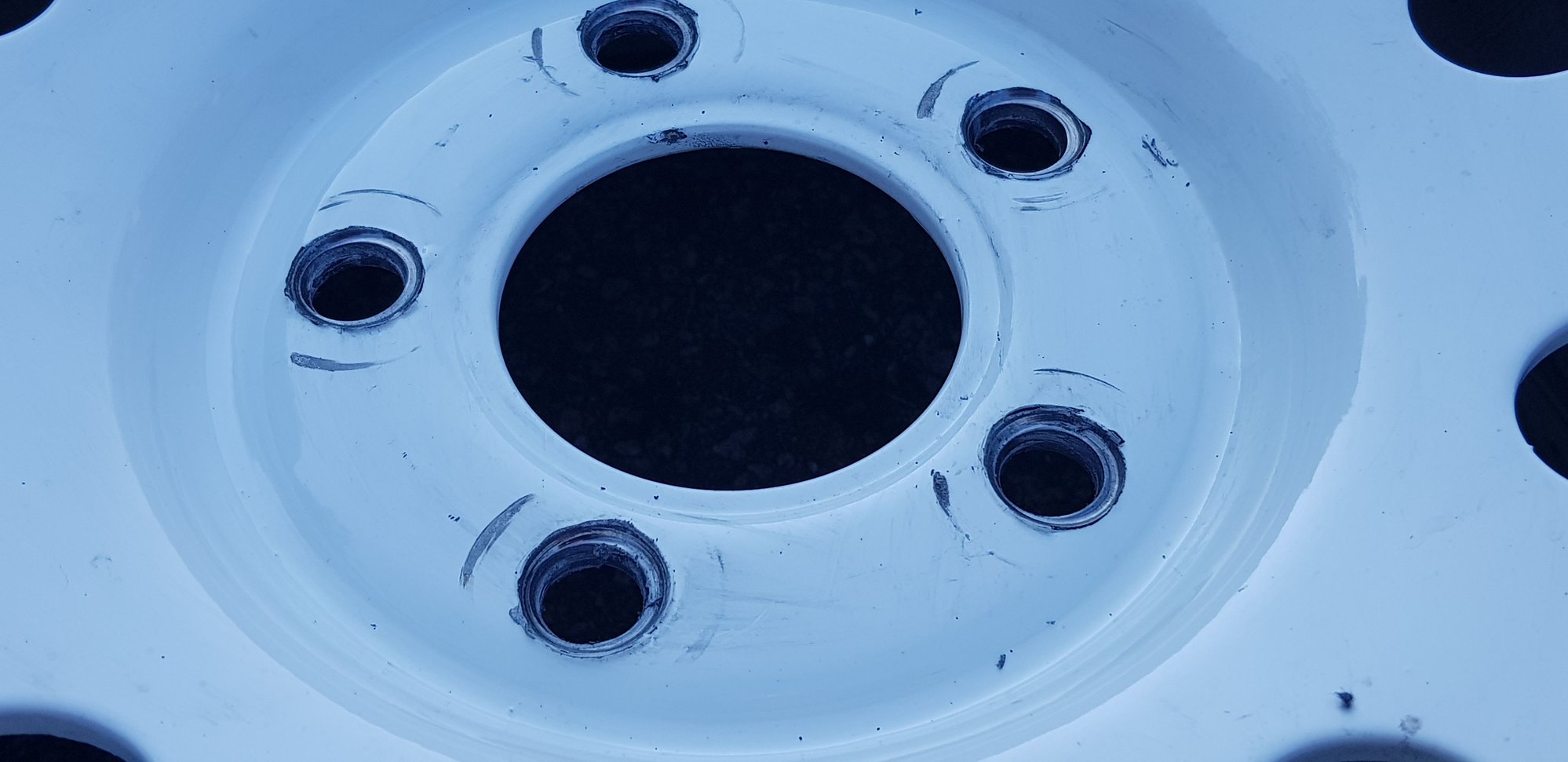

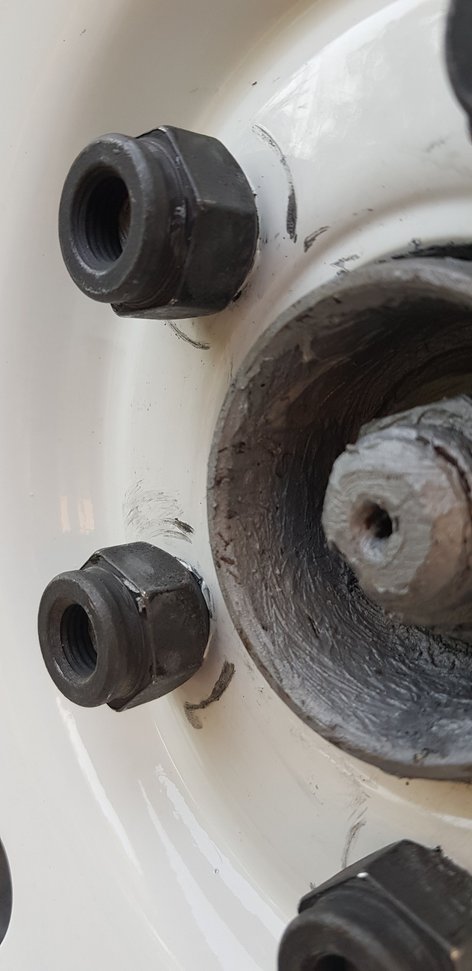

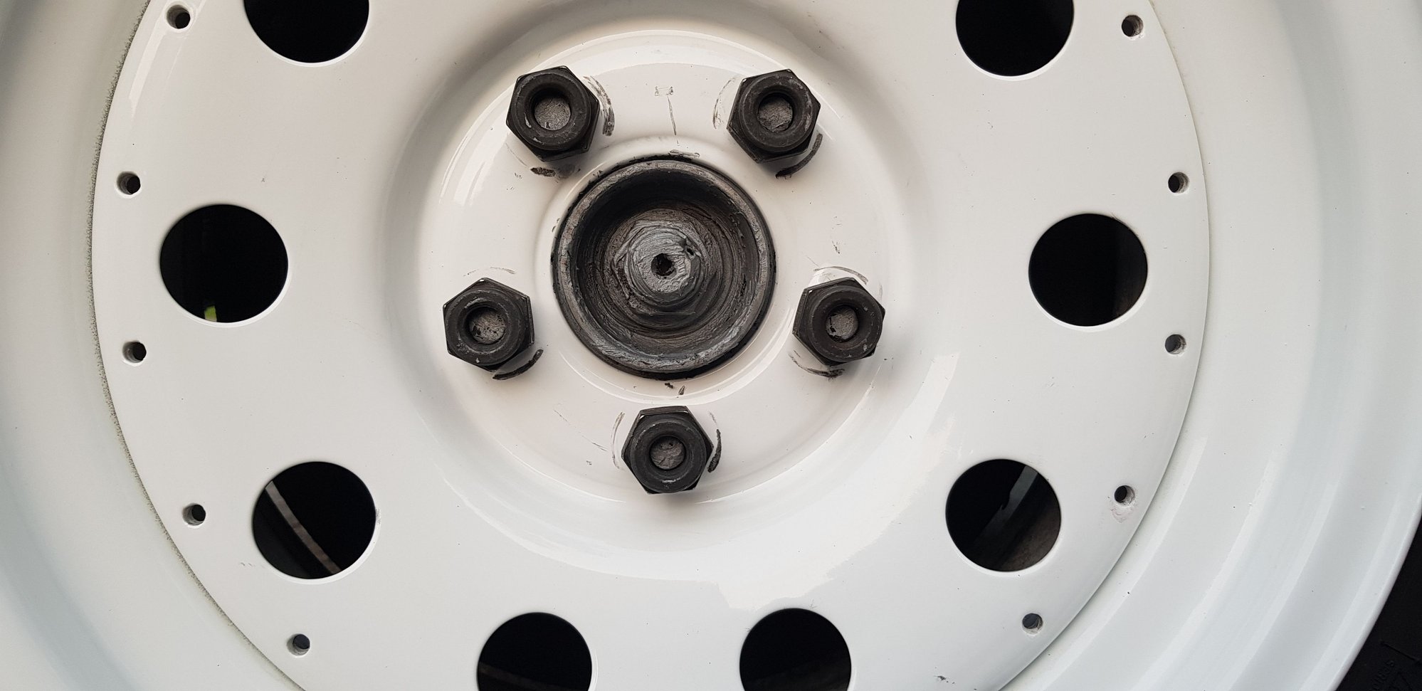

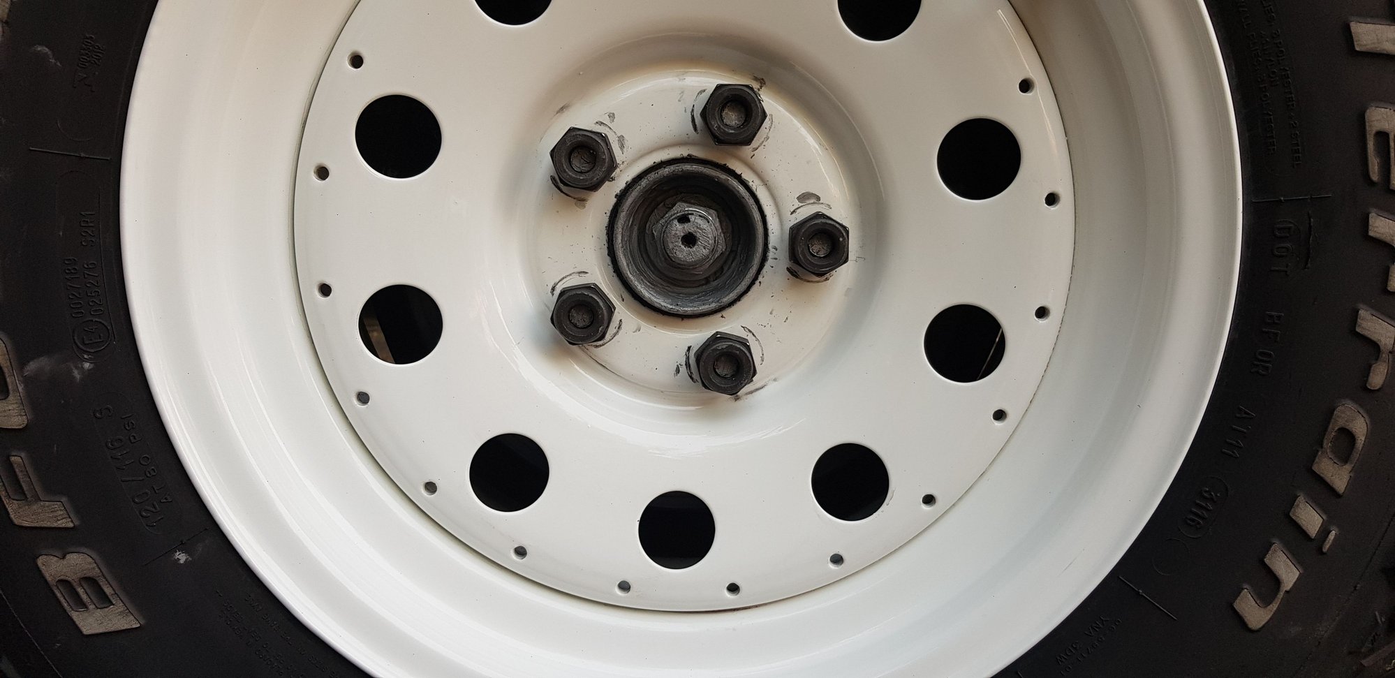

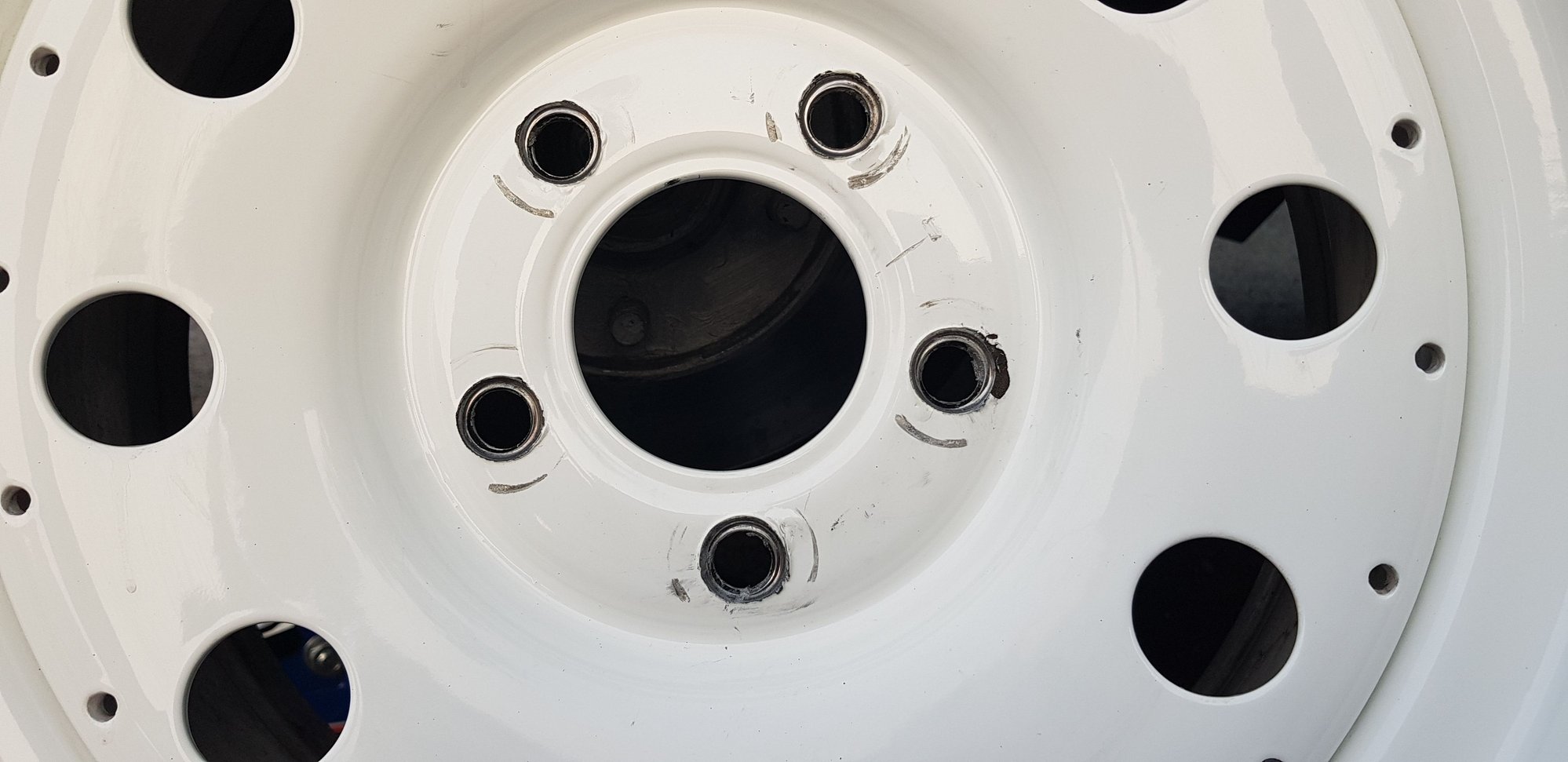

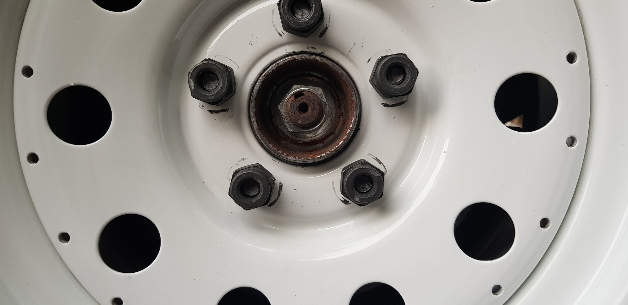

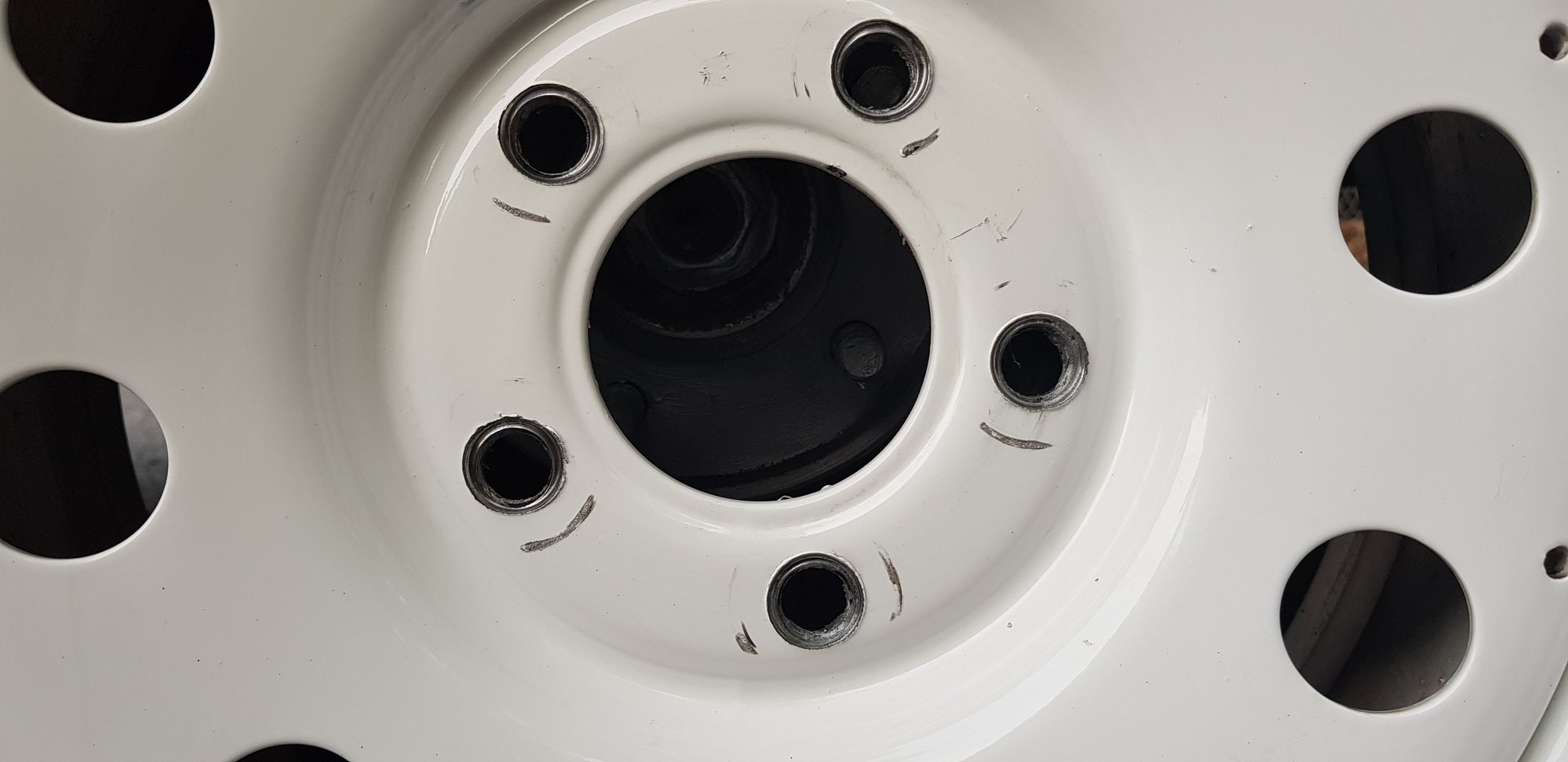

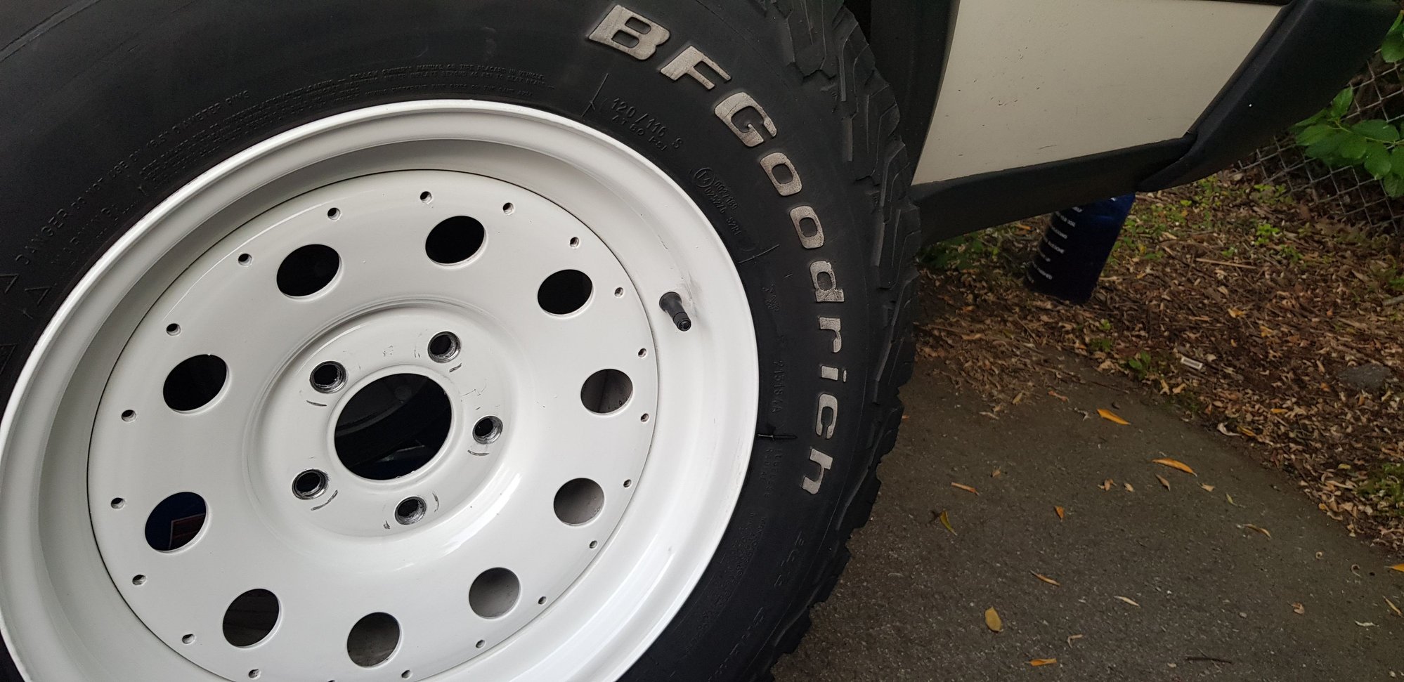

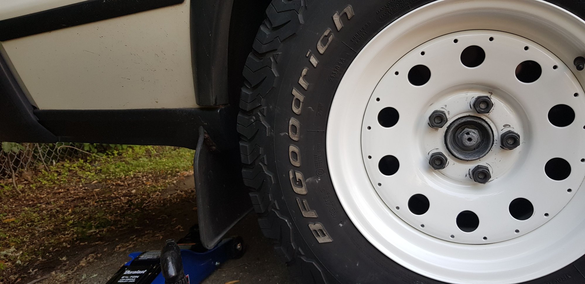

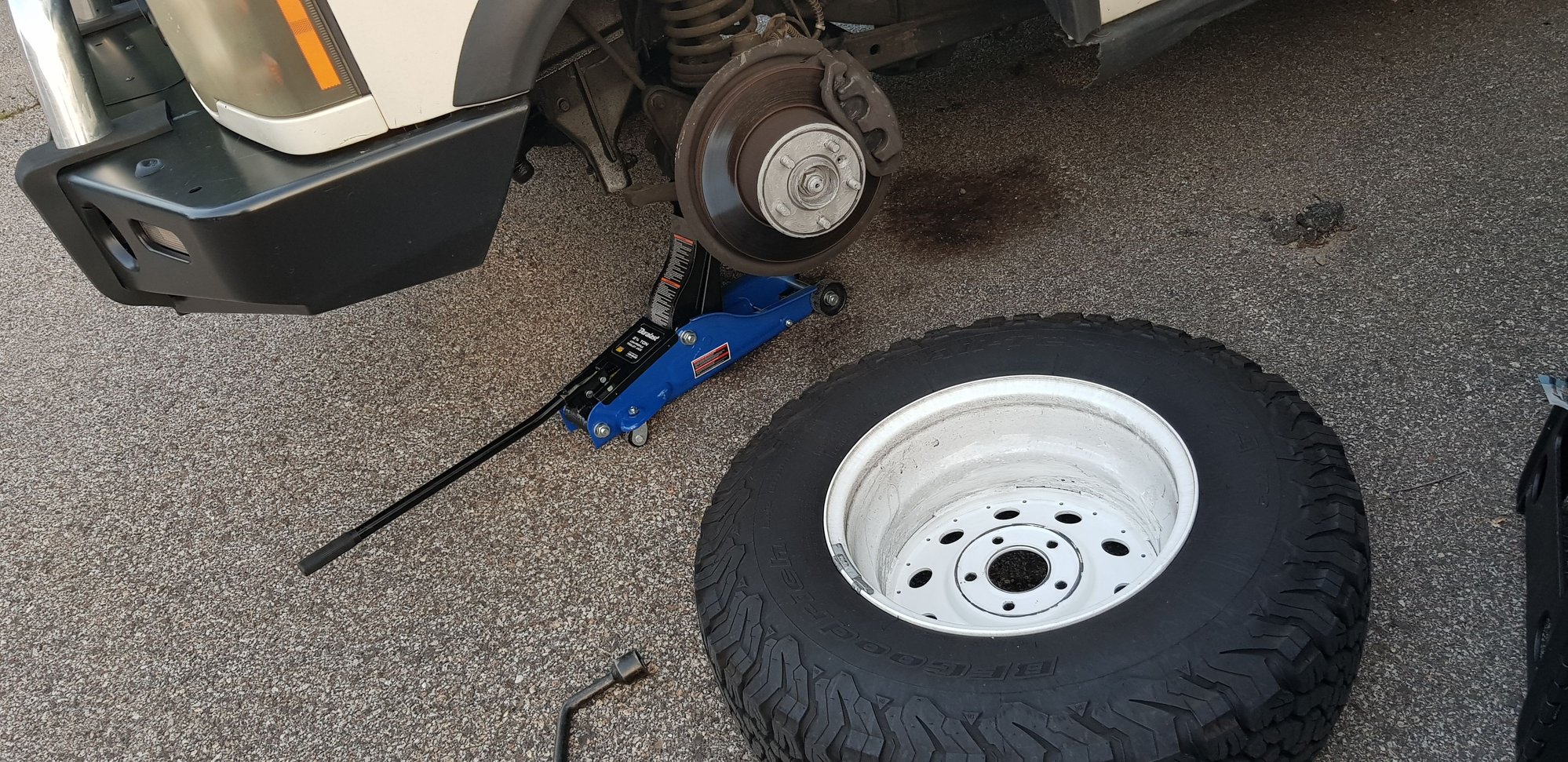

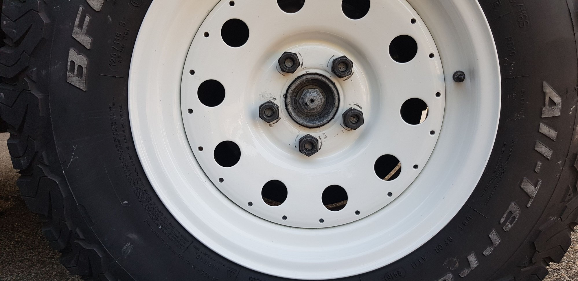

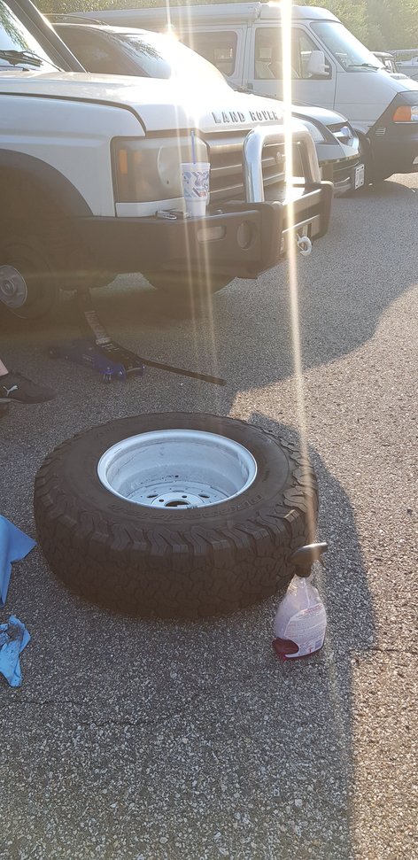

Today I removed each wheel, inspected the lug holes then remounted each wheel one at a time; doing my best to make sure each wheel is properly centered around the hub. I ended up using a flat head screwdriver to manipulate the wheels into the desired position then slowly tightened one lug at a time. When examining the lug holes I could definitely see where the powder coating is peeling off where the lug mates with the wheels. But the holes themselves dont appear to be warped or oval shaped. However Iam not an expert and I do not know what is acceptable or what is red flag. I took pictures of each wheel after I cleaned them up and mounted them back on the truck.
After words I tested the truck on the highway and noticed a difference. The steering wheel does not vibrate at 65-70mph anymore but occasionally around 45-50 when you let off the accelerator. But as soon as you apply the brakes or accelerate the vibrations in the steering wheel go away instantly. I do feel some minor vibrations in the wheels though. I cant really tell if its normal considering the k02 tires and heavy steel wheels iam running or if it's a sure sign of an issue. It's also worth noting that when I had the wheels first mounted the guys at the tire shop asked me of I wanted the balancing weights applied on the inside of the wheel or the outside. They said some folks with steel wheels put them on the inside and it looks better so I thought it over and told them to put the weights on the inside of each wheel. Could this be an issue? Perhaps these lug centric wheels require the balancing weights to be applied on the outside of the wheels?

Weight placement should not matter if they did it right.

TF has not responded as of yet. But a couple other LR parts merchants in the UK has been in touch with me and have also indicated that these tf steel wheels need the ANR4851 lug nuts. These lugs are bigger than the lug holes on the wheels though and when you torque the lugs up tight there is still a concern because the studs dont even go all the way through the lugs. Maybe the studs need to be longer?
The wheels are centered as best as I could make them. Even had a helping hand stand back and eyeball them to see if they looked centered. But the wheels still vibrate up through the steering wheel at 45 mph. At 65 all is well again.
