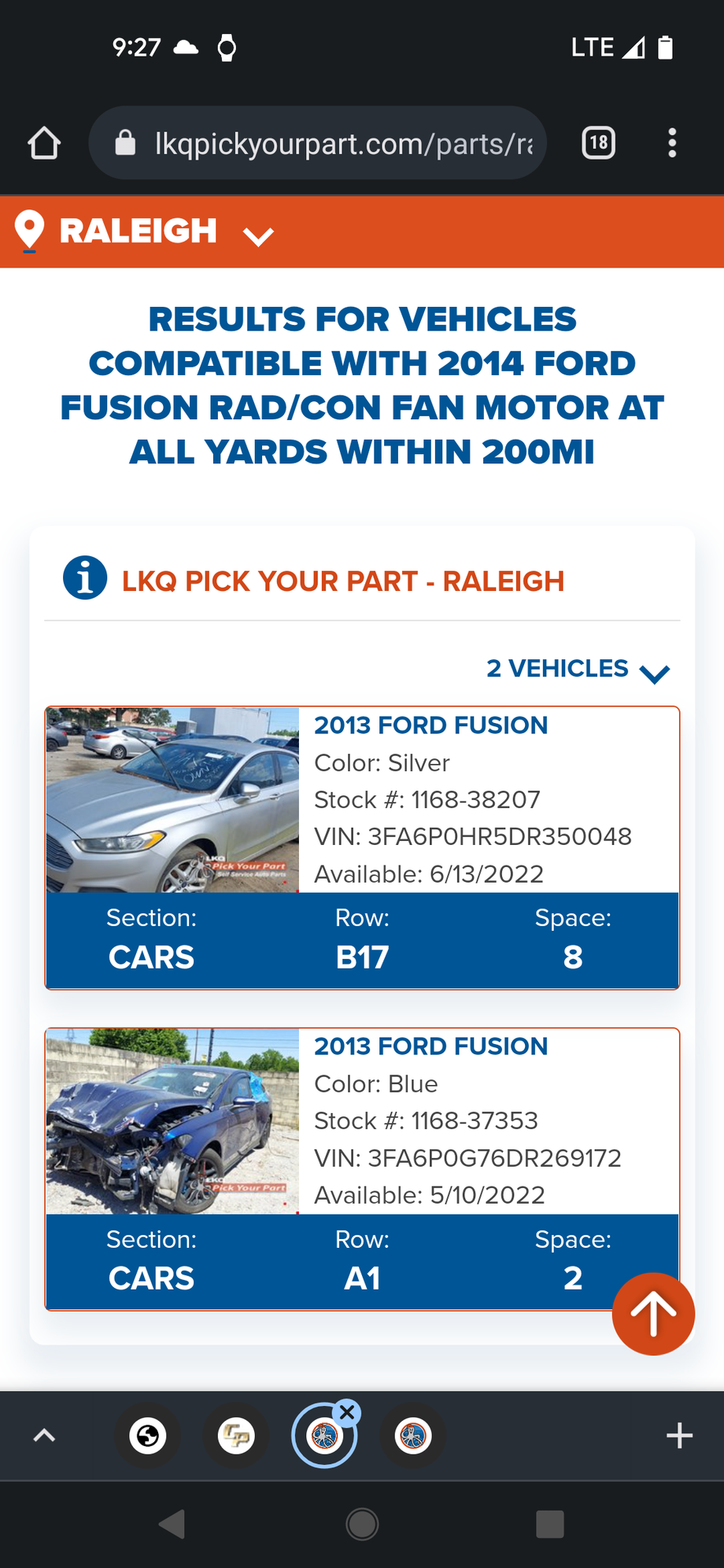

From: Raleigh, NC
Originally Posted by Mntnceguy
found that the Ford Fusion cooling fans and shroud for the 2.0 turbo and 2.5L were a near perfect fit. Its about 1/2-3/4" larger than the radiator core on the D2, and with a 1/2" rubber seal, it literally attaches to the core like it was made for it. OE p/n DG9Z-8C607-D. It's a dual 13" fan and shroud setup, with hwy flaps, wiring, and hose clips. From my research, I estimate it to pull around 2500-3000cfm, which should work even with an LS swap.
2014 Ford Fusion fan, junkyard with wiring $80
Well well would you look at that.. One minor difference and it doesn't fit.. I had searched for a 2014 Fusion and apparently LKQ cross reference thinks the 2013 fan is the same, while it may fit a fusion it won't fit Rover, why don't they understand what we're trying to do here I guess I have to return this or make my own shroud.. I guess I got excited and jumped when I saw one pop up in the local lot.
Edit: With some more searching and comparing part numbers the correct one is indeed from a 2013-2020 Fusion with 2.0 or 2.5L engine
SKU: DG9Z-8C607-J
Other Names: Fan & Motor, Motor And Fan Assembly Engine Coo
Fusion. 2.5L. 2.0L turbo.
Applications: 2.5L. 2.0L W/O HYBRID.
Replaces: DG9Z-8C607-D, RF-287-

Originally Posted by Sandman614
2013 1.6L Ford Fusion fan... Wrong fan orientation
At least it was only a $3 mistake. Luckily they got a 2.0L fusion in since my last visit to the junkyard. The 2nd time extracting the fans is much faster lol.
I did learn that the fan motors themselves are the same, the main difference is the fan orientation.
