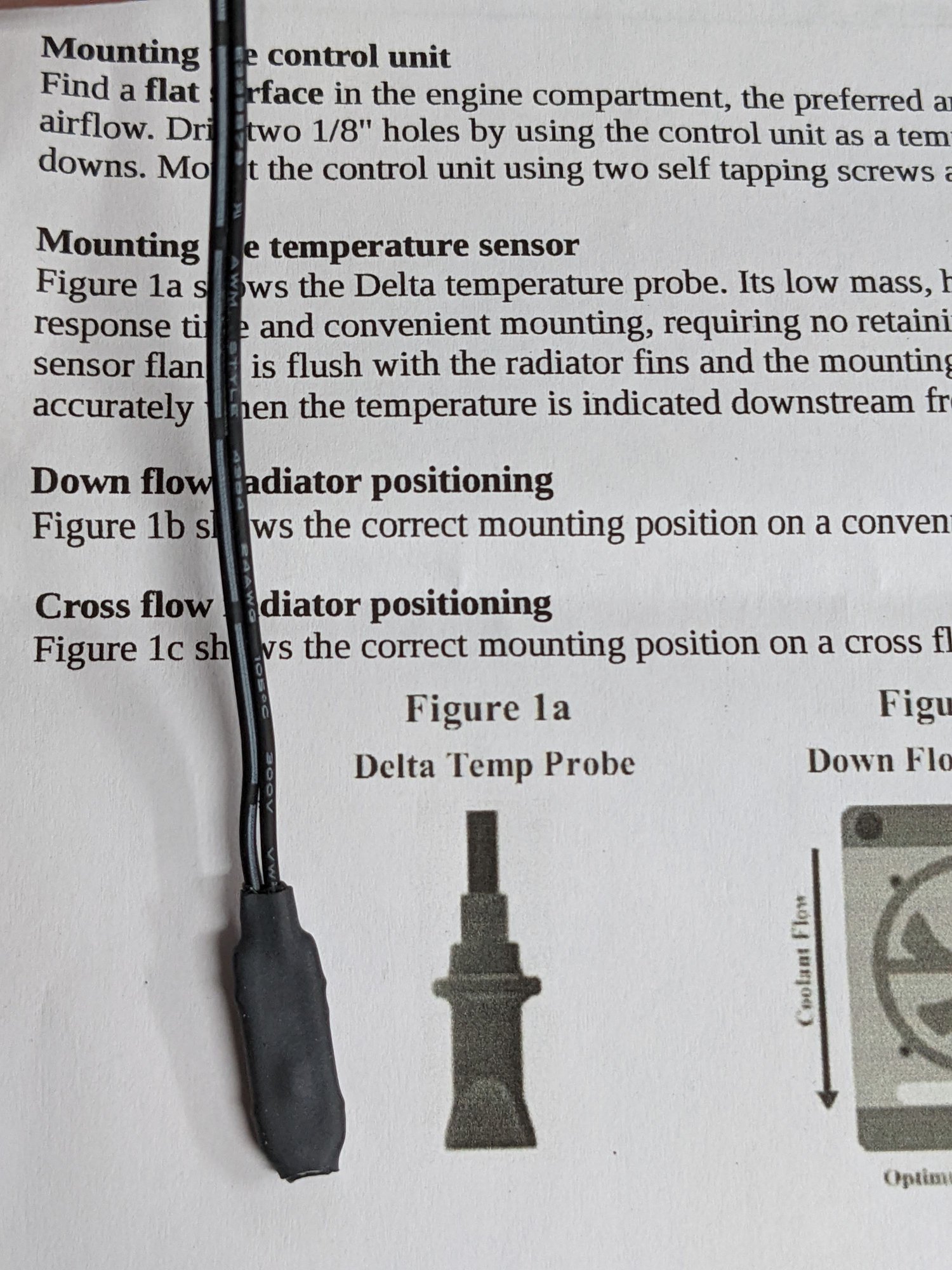

Working on my install today. Only question so far is which outflow are the D2 radiators? *That's a dumb question* I just looked at the orientation of the tanks on the pic.. Cross Flow
Looking great! You're doing a lot more trimming than I did, and it's fitting REALLY nice! You may not need the rubber seal with it all trimmed in tight like that, cool idea, nice work
Seems like you figured out the D2 radiator is crossflow, with inflow at the top and outflow at the bottom. I'm curious what kind of sensor does your controller have?
Just a little thermistor wrapped in heat shrink
The temp sensor info for what I did with my setup will pertain only to the Derale PWM controller style. Other methods of controlling the fans will likely have a different type of sensor and will need to be mounted according to their specs. I would also like to let folks know the Derale is a screamer, lol. It makes a squealing noise at low fan speeds that can be a little odd at first. Like I said in my original post, I may try the DCC controller brand if I ever do it again, both for the easier sensor it has, and the lack of squealing noise it supposedly does not have. But, for what I did......
Nope don't change a thing! This thing whines and squeals like an ambulance too.. Seems like it's at it's worst below 1amp and the fans get to be louder than the whine after that point.
