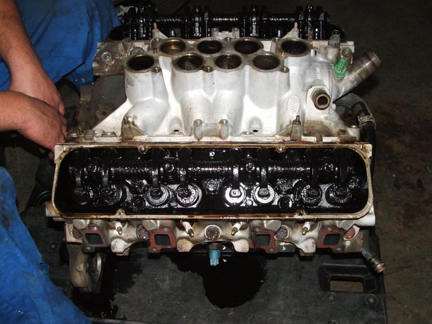

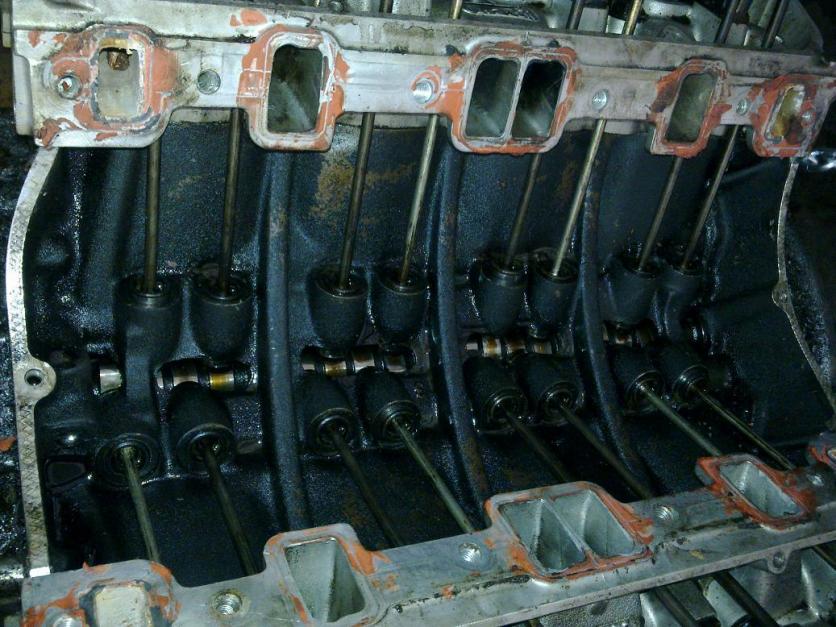

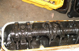

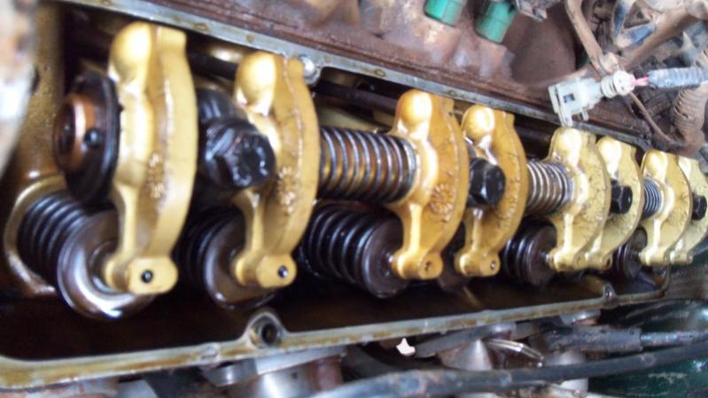

WalMart and auto parts stores and truck stops sell it, about $12 a gallon, 15W40 conventional, also comes in 5W40 synthetic. If you look at the oil chart in the Rover manual, 10W30 is rated for use only up to 90F. You really want the "40" on the end.
Here's a pix of a Rover engine at about 190,000 run on Castrol (to start with) and Shell Rotella, with logical oil change intervals (5,000 or less). And one that wasn't. And they guy who wins when you do oil changes at 7,500, 15,000, 25,000, or just when you feel like it.
Change early (before the factory spec - which was invented by ad weasels) and often.
Attached Thumbnails End All answer to stupid oil questions.-100_0313.jpg   End All answer to stupid oil questions.-eng-1a.jpg   End All answer to stupid oil questions.-03032011189.jpg   End All answer to stupid oil questions.-eng-1.jpg   End All answer to stupid oil questions.-bad-mechanic.jpg

Rotella 15W40 conventional, if in an area with temps below 15F consider 5W40 synthetic Rotella. Check your shop manual, 10W30 only rated for use up to 90F. Main thing is change at 3,000 - 5,000 intervals. Not 7500 or higher.
If in an area where Rotella is not sold, seek out a high quality diesel truck oil. The lads in a lorry will know where to buy it.
