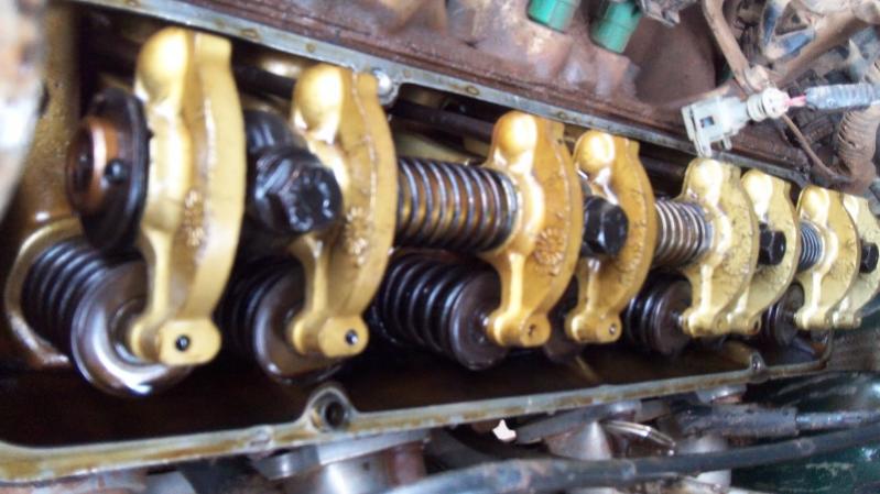

This one is about 190K miles with Rotella....
