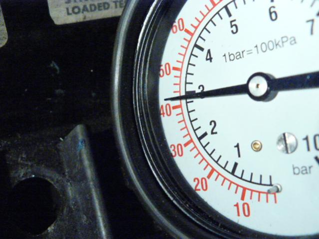

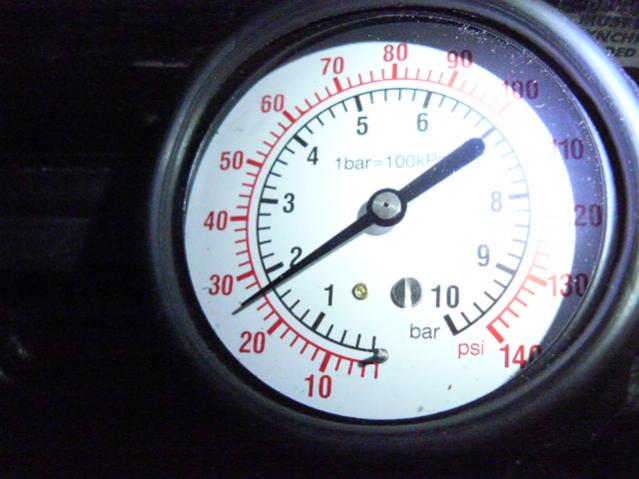

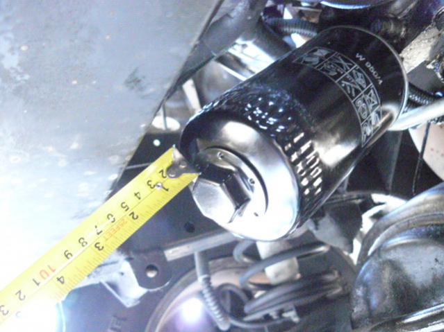

Posts: 16,322
From: Savannah Georgia

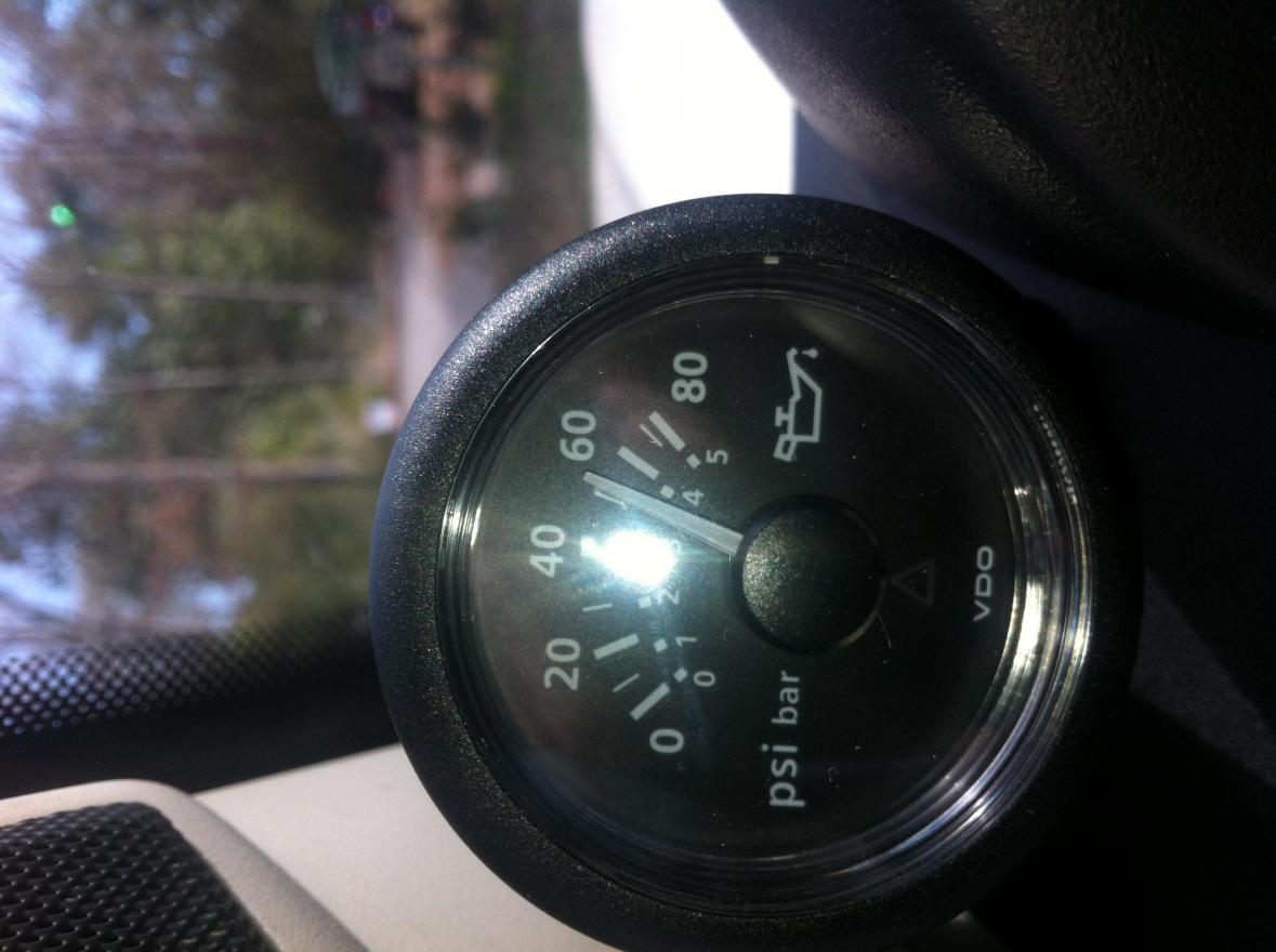

The MANN/Purolator or the same size "long" WIX filter adds about a quart of capacity. WIX even makes a two quart filter, but the micron filtration level is about 35. Pix of mine with PSI readings, almost warmed up, the low idle went down to 24 PSI. Rotella 5W40 syn. 170K+ D1. I think I was leaking a little around test gauge adapter, so high number might nudge up a little. Was 45 cold.

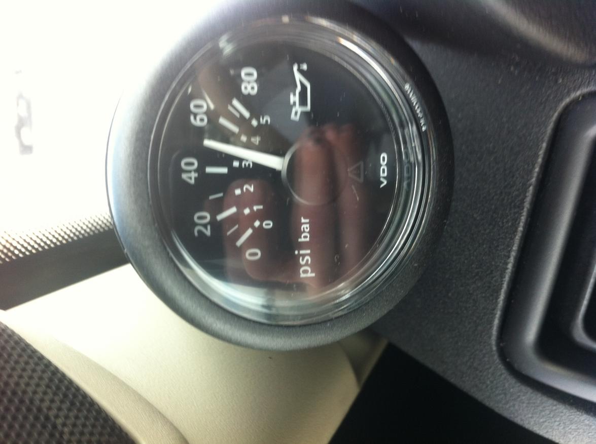

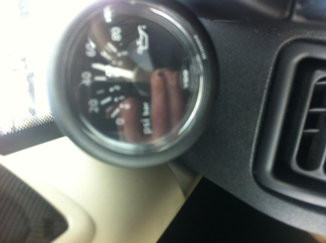

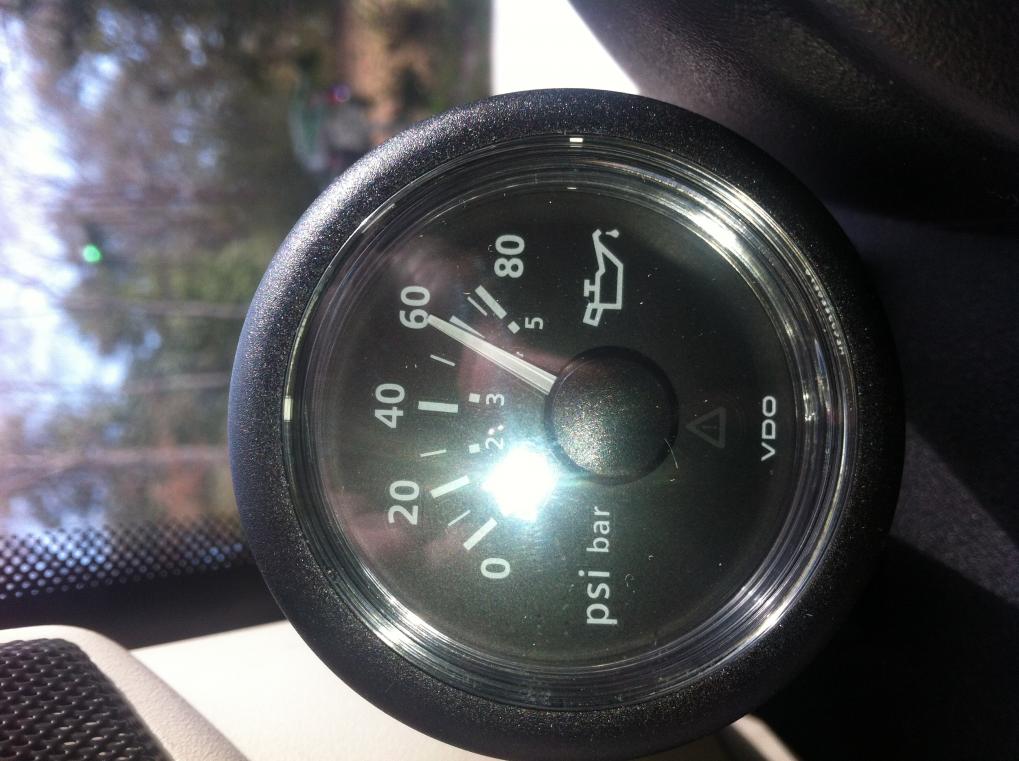

Just had to give it a go. Cold pressures are after setting overnight.
Stats: 88,000 miles; Mo1 0W-40 or Motul 300V 5W-40 since mile 1 W/ LR Genuine filter.
Before: LR filter & Motul 300V 5-40 with 698 miles on oil and filter. Ambient 76 degrees
After: OP Purolator and Rotella Syn. Ambient 78 degrees
Cold Idle: Both dead on 50psi
Cold 2K : 50psi - 58psi
Pressures after 40mile run.
Hot Idle: 18psi - 19psi
Hot 2K: 50psi - 51psi

one more
Attached Thumbnails End All answer to stupid oil questions.-shellhotidle.jpg
