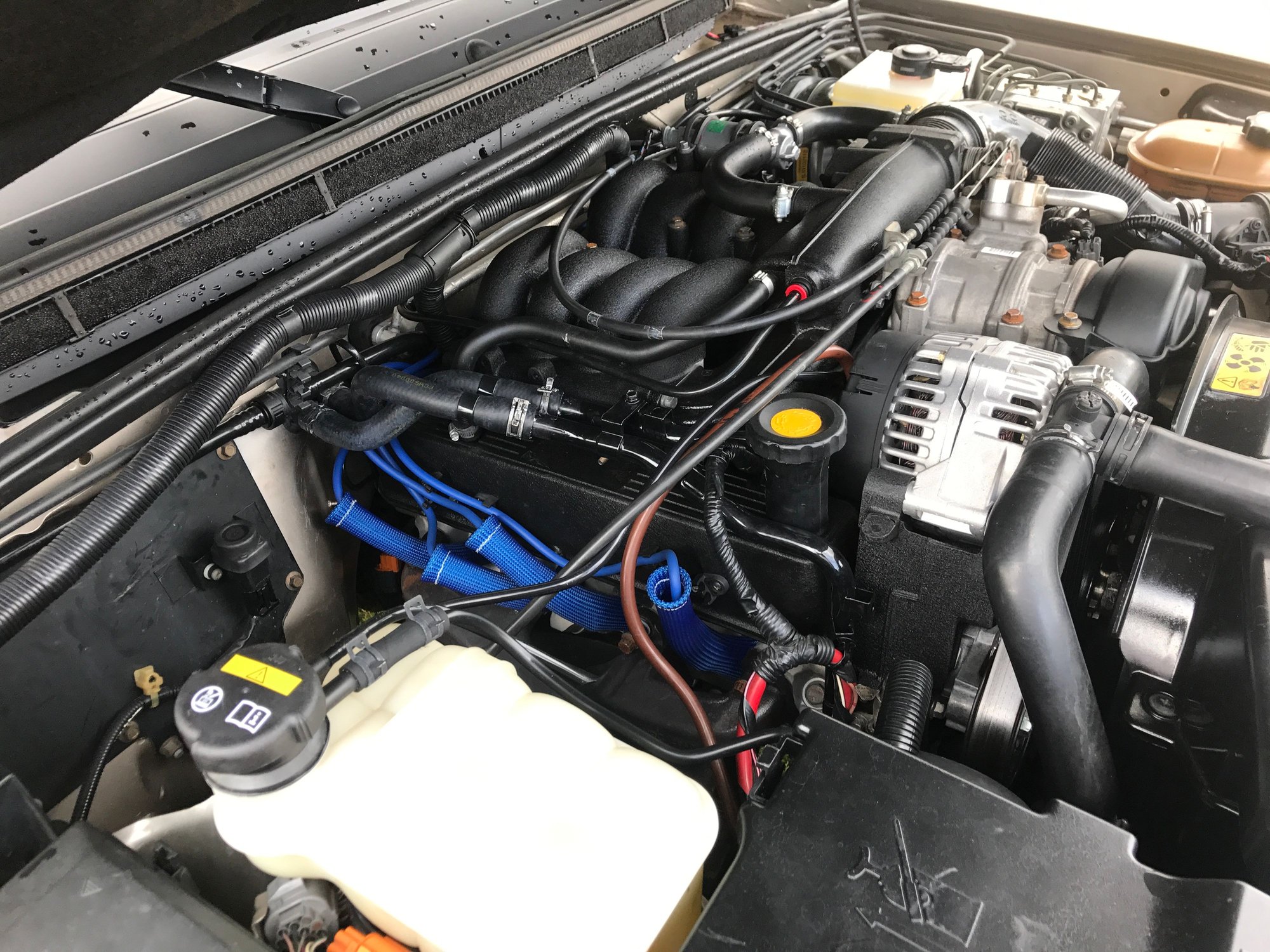

Most of us run shell rotella t4 15w-40. I know it's made for Diesel engines but works great in tappet engines and will help with some of that noise. As for the plugs, a lot use and swear by different ones. I use either ngk platinum or champion platinum. I don't use the +4 or anything like that. I personally run kingsborne wires and the high heat spark boot covers(snake oil but that's just me)
