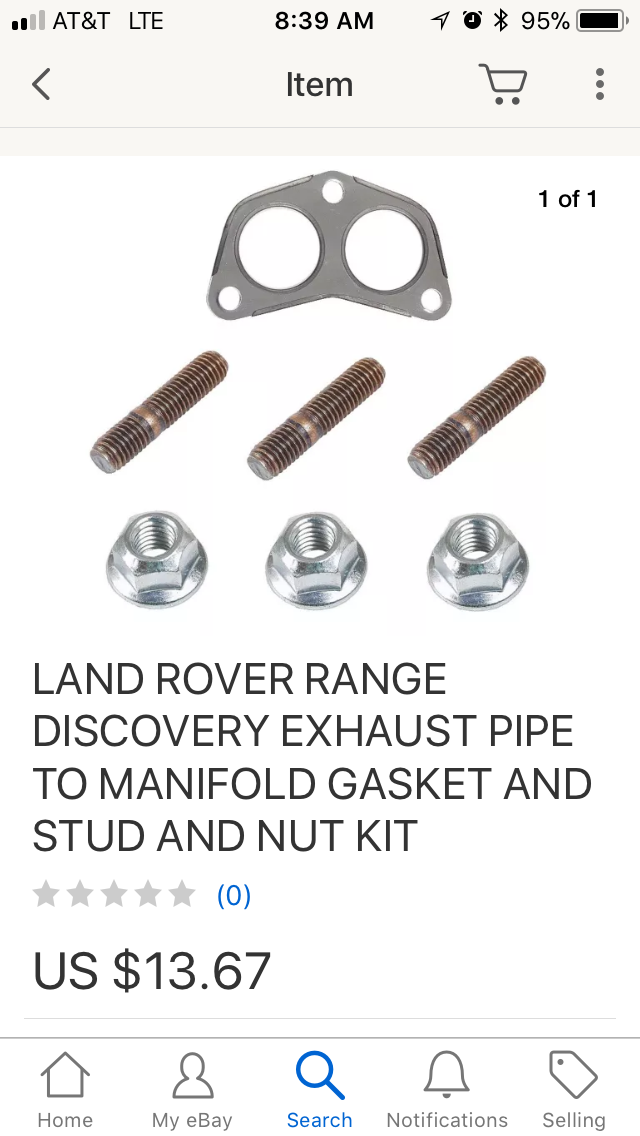

Is this the one youre looking for? Plenty on ebay.

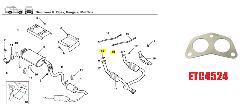

ETC4524, but as mentioned get the "kit" the studs break real easy.
