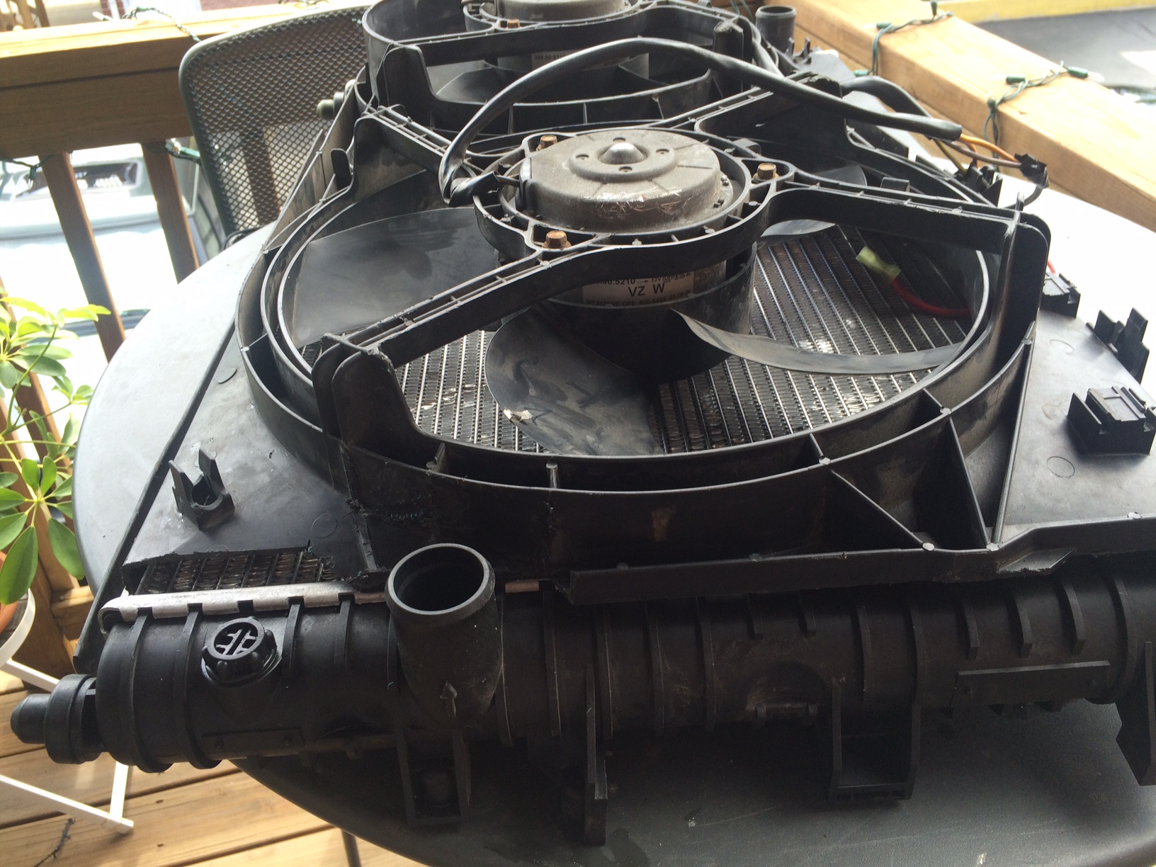

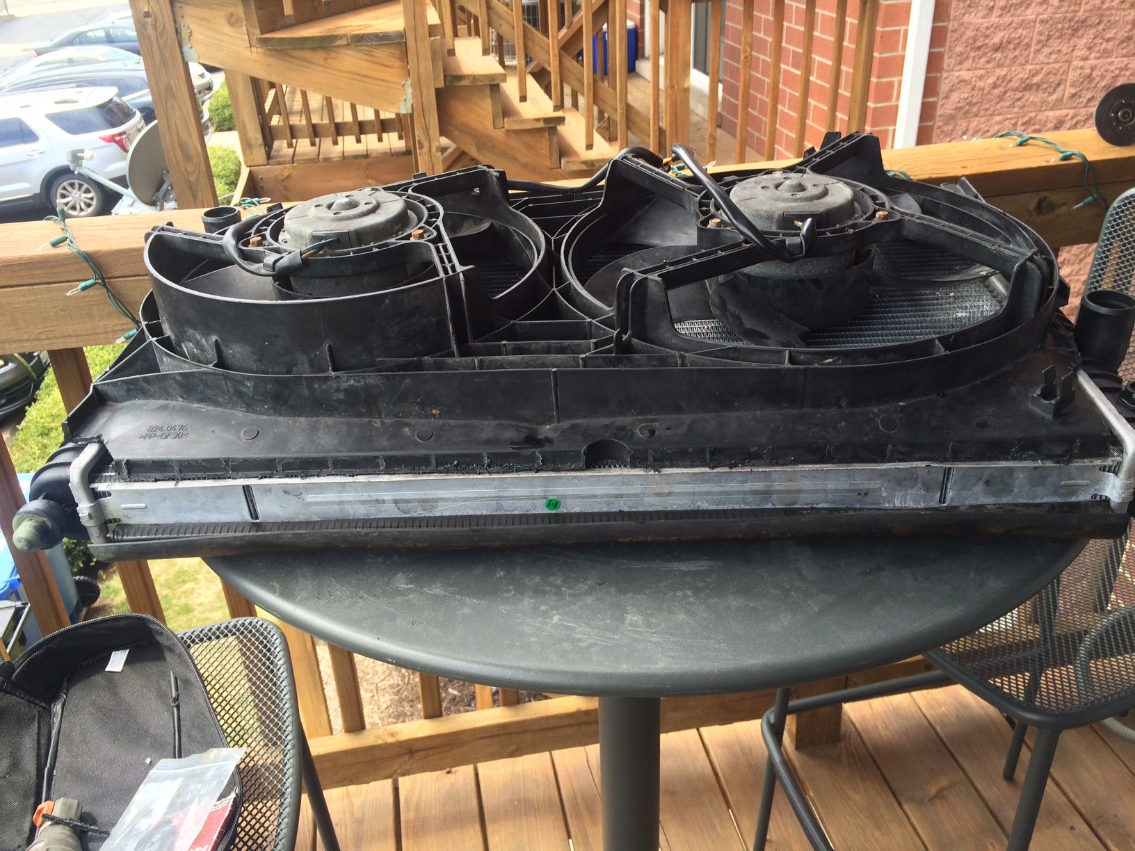

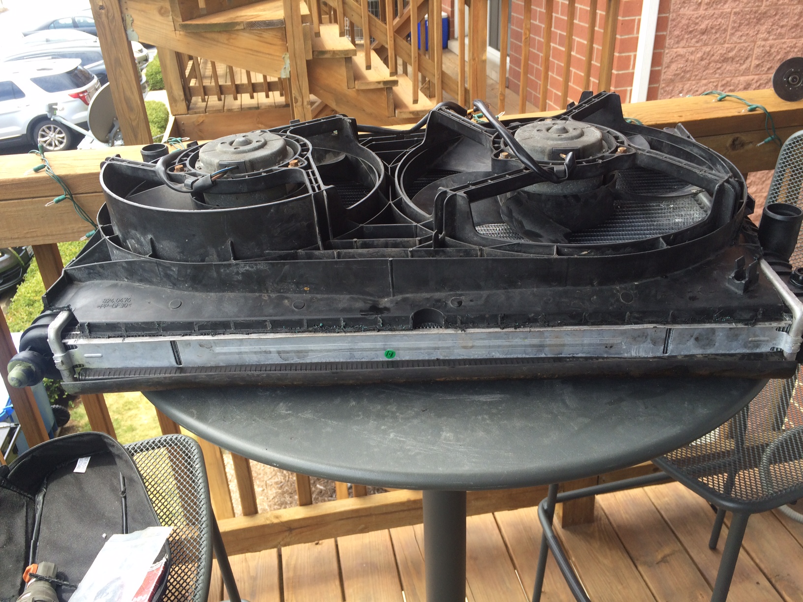

Here are some pictures. I trimmed the sides, top and bottom quite a bit, as well as the inside. I used an oscillating blade and it was easy. if you take out the radiator before trimming it would even be better. I tried to install with Radiator installed. Bad, bad idea.
This fan was off a 2005 with 23,500 miles or so.
Attached Thumbnails Flex-A-Lite 180, Motorad 180 Thermostat, Evans Waterless Coolant experience-gto-3.jpg   Flex-A-Lite 180, Motorad 180 Thermostat, Evans Waterless Coolant experience-gto-4.jpg   Flex-A-Lite 180, Motorad 180 Thermostat, Evans Waterless Coolant experience-gto-2.jpg   Flex-A-Lite 180, Motorad 180 Thermostat, Evans Waterless Coolant experience-gto1.jpg

That's a lot of fan. The controller seems the way to go. I bet this set up works great. Are you keeping the pusher fan?

I am left over with a Taurus fan, and the flex a lite 180 set up. I installed the 14" flex a lite slim fan which is my a/c fan and that will stay of course. It really kicks air, a little loud but nothing I can't live with. An s bladed fan may have been quieter.
