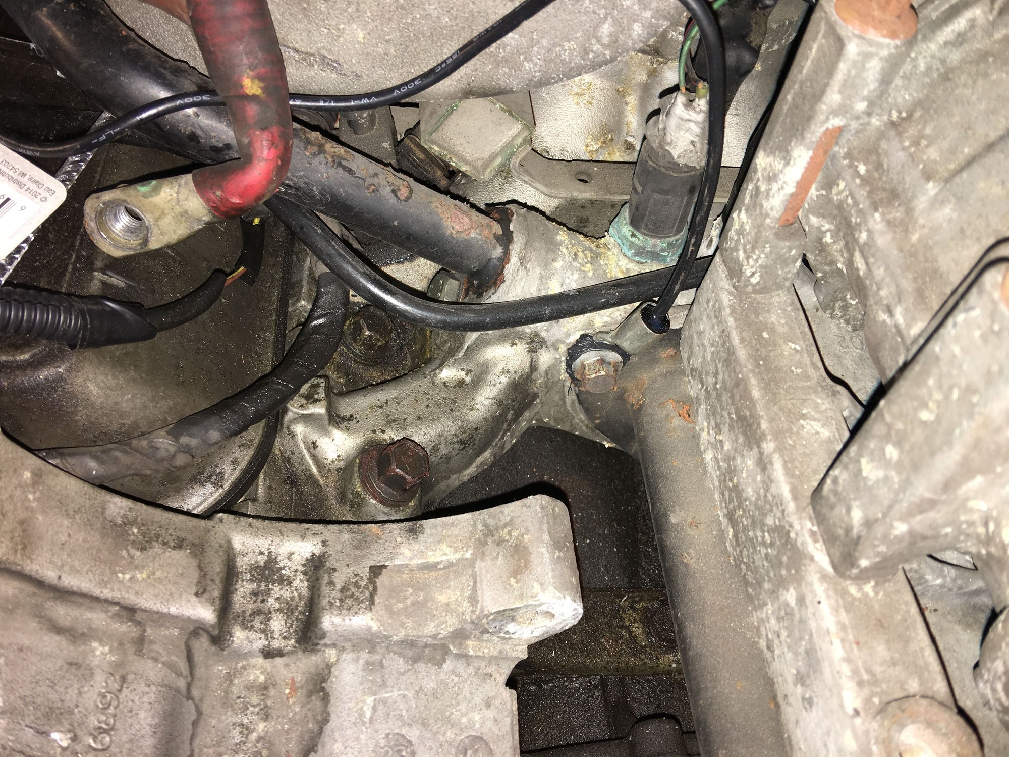

Finally able to reinstall the GTO fan. I used a Ron Francis ar99 controller, and it is in every way superior to the flex a lite controller. Here are some pics.
This is the unit's temp sensory it is right by the temp sensor.
Pics of fan on radiator.
Interior photos. I installed it on the abs ECU/BCU Bracket.
Still need to do a long test drive, but very happy with how it turned out
