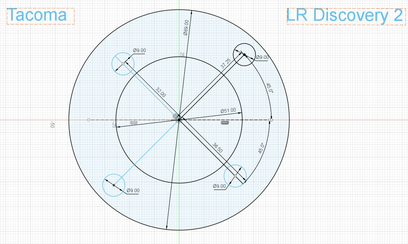

Pretty easy to make the crank pulley tool, I drilled 2 sets of holes to use it on my Tacoma too. Check the crank for wear, you might need to get a speedi-sleev

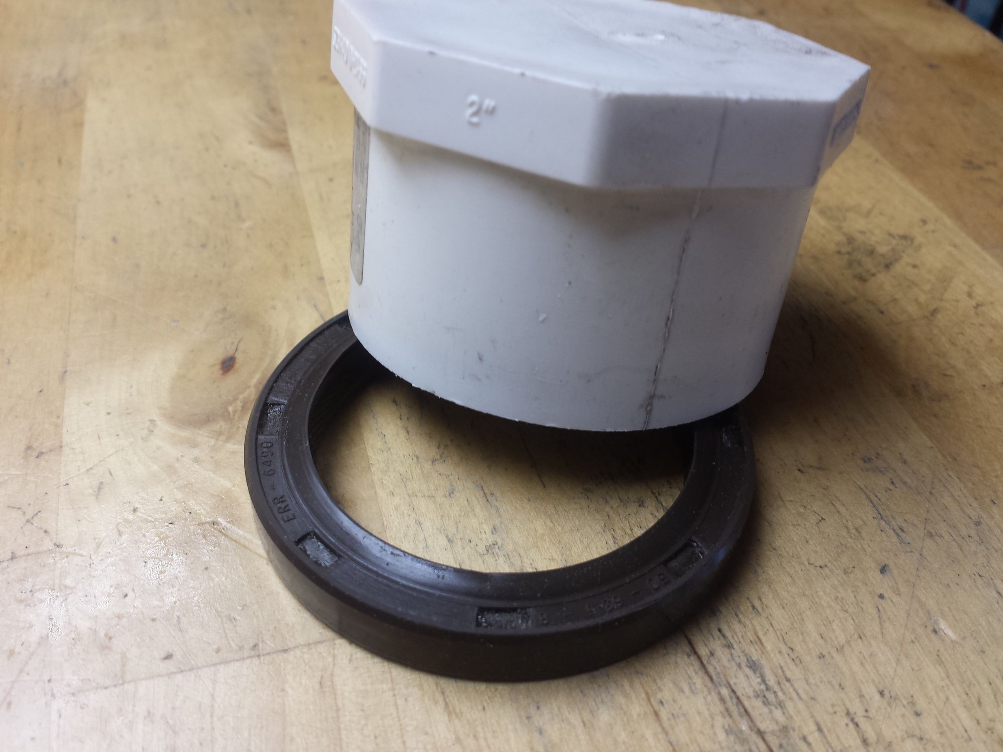

I had the same issue and I found out that the shaft was worn. Put on a sleeve or get a new pulley. I did not use any special tools. PVC fitting from the hardware store for $2.39 or something like that to push the seal in and air impact wrench to get the nut off. Tightened by blocking the flywheel.
