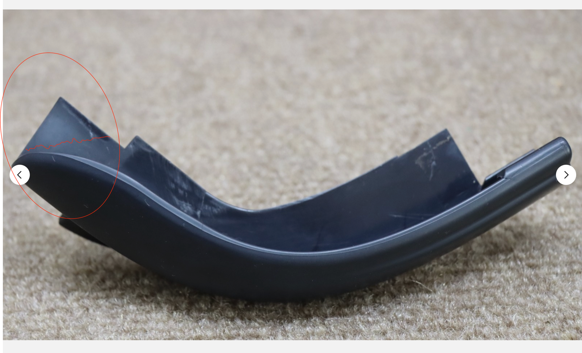

Also just now noticing that not-broken drip edge finishers have this end part fully covering that hole. Mine were apparently snapped off long ago but I didn't think this wasn't normal.

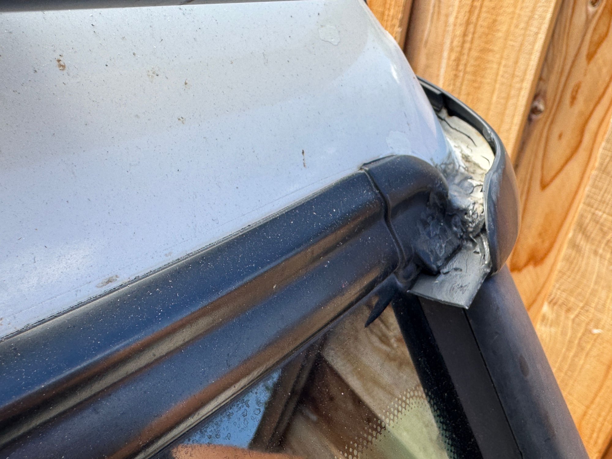

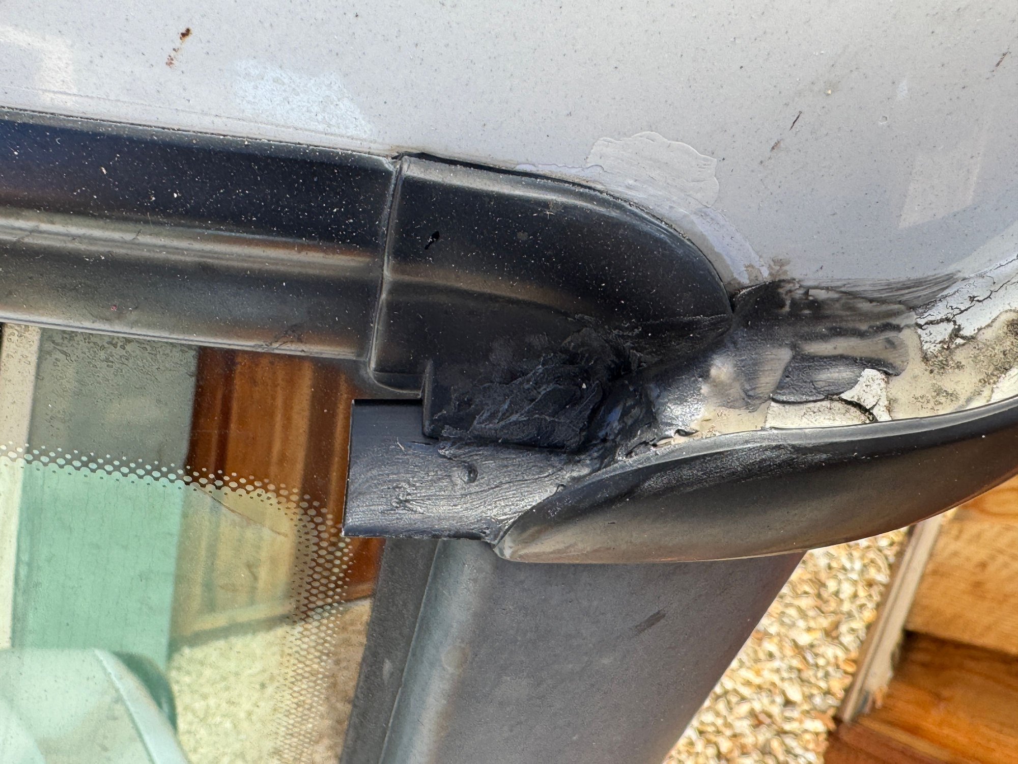

Yeah I had a new windshield installed, which solved a ton of water ingress issues, and had them install a new weatherstrip along the top. Just as a patch for now, I just cut two pieces of black plastic pipe strap hangers, slipped them between the metal gutter and drip rail finisher, and used black caulking to adhere it. I'll figure out a more elegant solution later but for now this should do the trick.

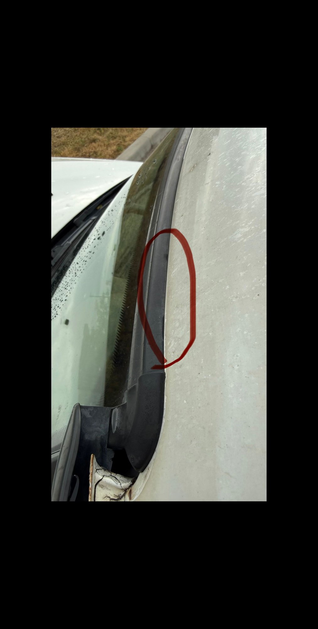

Just did a water test outside. And I checked first the part I circled in yellow. Then the lower cowl.
Nothing.
then did this spot in red. And there’s the leak. Cause there is a small opening where the weather strip meets the windshield, about 4 or 5 inches I see now.
1. Ok to put the silicone etc outside the strip?
2. Best way to look professional? I’ve never done and rather it not be a gunky and not straight.
I read apply a piece of tape the entire way , calk it, then use a smoothener tool?
any advice I appreciate. Thanks.

Smal amounts of water, by design, can get into that area from new, it just runs down inside the A-pillar and drains out the bottom. The problem is the amount of water. And the seam sealer gets chalky and breaks down in the 20 years since new. Seal it up with goop, yes.
