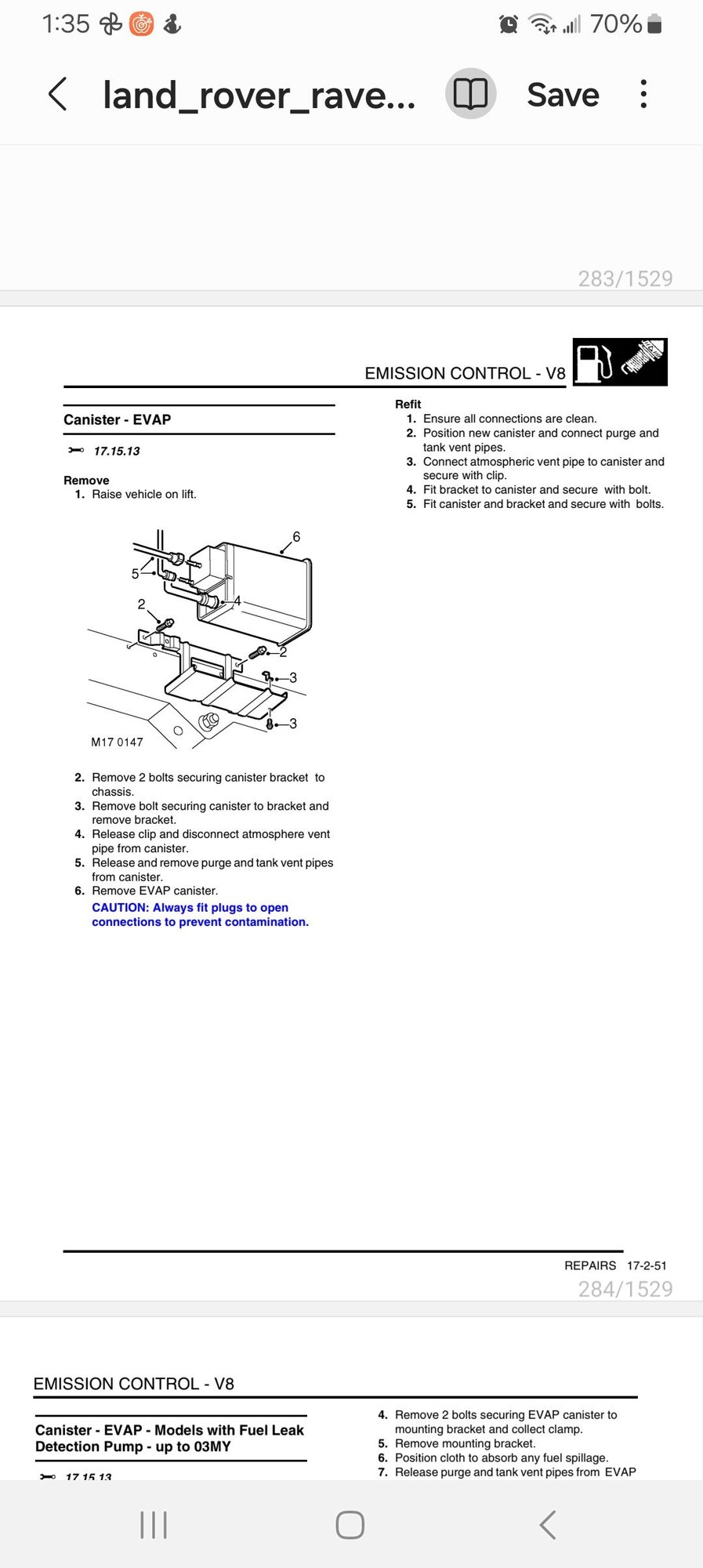

Climbed under my Disco yesterday to verify some things before buying parts to alleviate some codes. I have a 2000 Discovery and it doesn't have the leak detection pump at the canister like to 03-04's do but I'm getting the P1451 code for it. Also, I've noticed once the Disco gets about half a tank of gas it doesn't want to take anymore; could this code be for a plugged/bad charcoal canister not allowing fuel vapors back up to the purge solenoid? I did replace the purge solenoid yesterday because it wasn't operating correctly.

I replaced the vapor canister today and started the truck up and it didn't lag like before; I'm hoping it solves the issues but won't know until Friday when I go to fill up. The old canister was a bit heavier then the new one and the filter media to fresh air inlet looked plugged.
