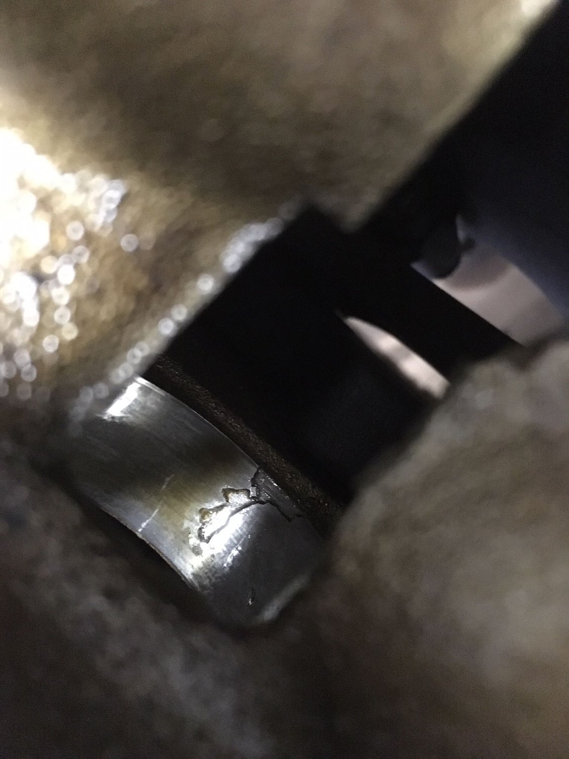

well, here is my cam bearing no. 4. The rest are good, especially no. 5. It looks brand new. So can I replace 1, 2, 3, and 4 and leave no. 5 in place?
I'm not equipped to pull the engine... all started with a ''simple head gasket job''...

and the other question, do all cam bearing tools work on a DII?
thanks

The cam bearing tool that I used had heads that expand like bulbs or balloons. Each was a different size.
They start off small so that you can isnert the tool inside the bearing. Once there, you twist a screw on the end of the tool to tighten, and then you twist the handle of the tool to expand the head/bulb until it is pushing pressure on the cam bearing.
Then you whack the cam bearing tool with a hammer and the bearing pops out.
The same head fit the first 4 bearings for me, but then I had to install a smaller head on the cam tool to pull the #5 cam bearing.
I have no idea if all cam bearing puller tools work the same.
