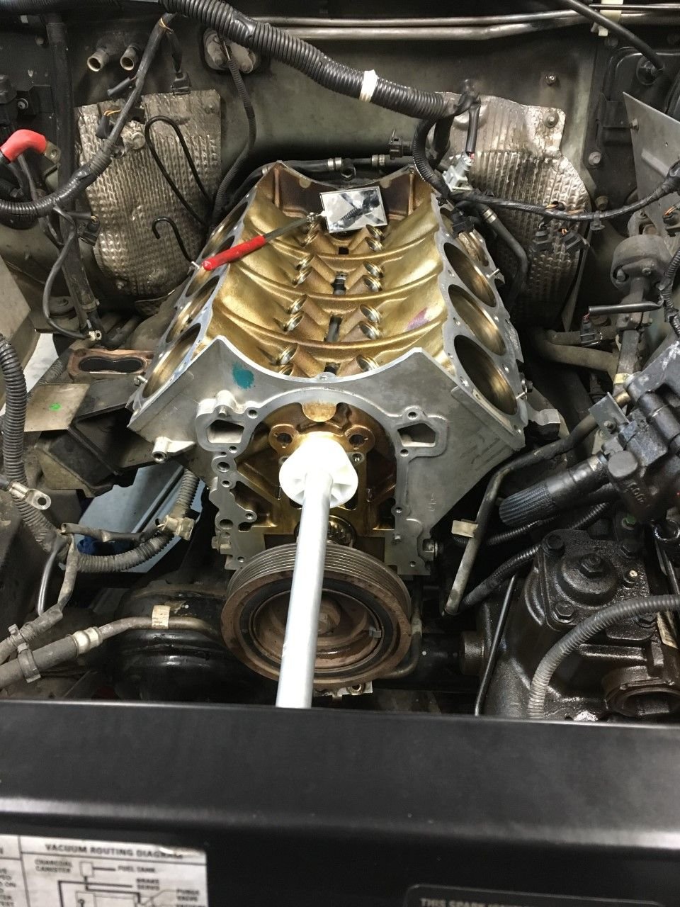

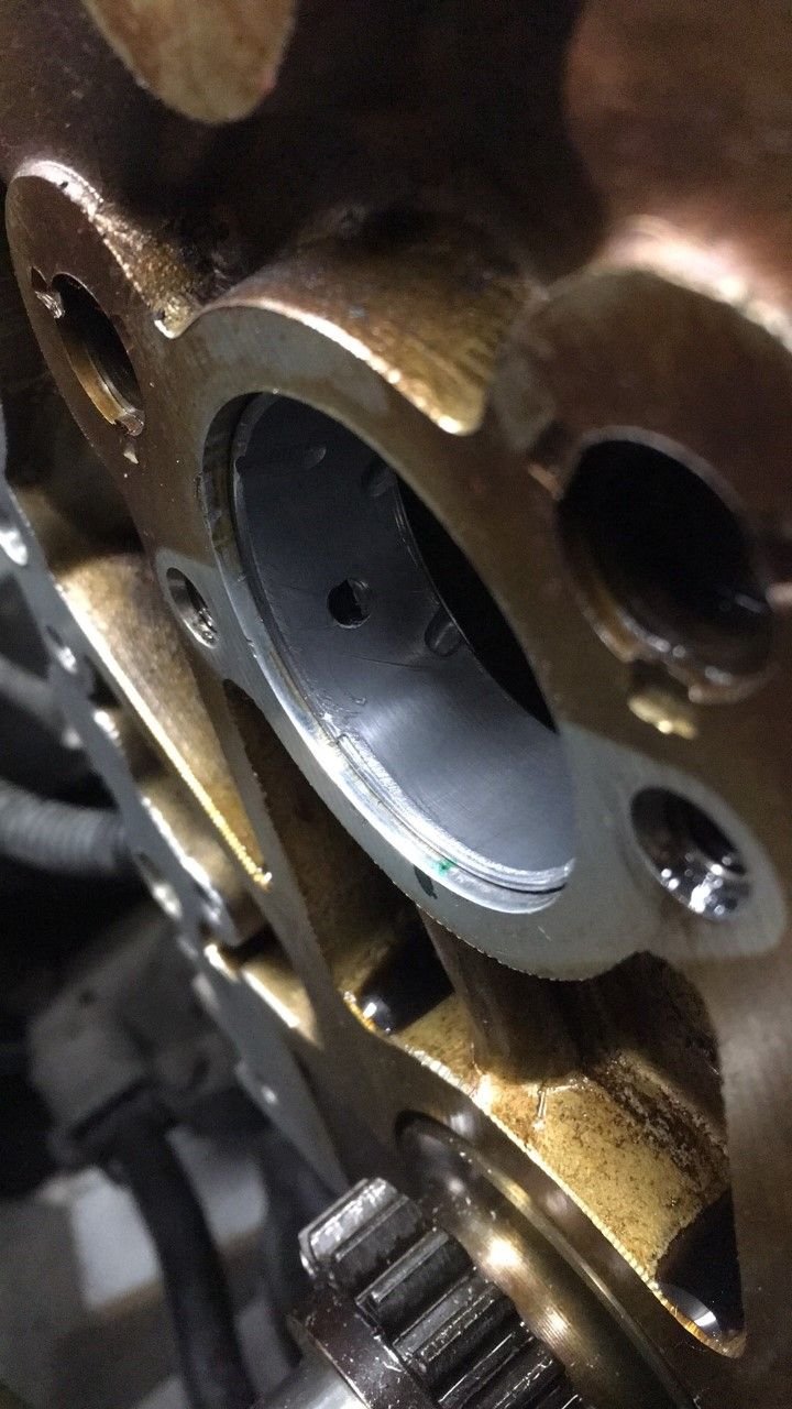

I was installing the new cam bearings (1 to 4) and I messed up no.1. Oh well live and learn they say I'm using the 8milelake tool (same as lisle)
I just ordered another set but you know what's going in my head now... do I pull it and strip the whole engine? This is my first rebuild. I'm a bit intimidated I have to admit but I made it quite far!

buff out the edge with some 500 grit and leave it.

makes sense plus the babbit material is so soft... any imperfection may just buff itself out once it runs...

I am in process of removing the cam with motor in. I will inspect the cam bearings. Most folks I have talked to (Rover mechanic among others) have said odds are very good my cam bearings are fine. Did you remove the condenser to install the cam?
Old Sep 10, 2018 | 07:42 PM
  #26
Llamasayswhat's Avatar
Joined: Nov 2017
Posts: 450
Likes: 81
From: Kailua Kona, HI
Condenser and radiator have got to come out. No way around it
Old Sep 11, 2018 | 05:20 AM
  #27
Roby466's Avatar
Joined: Mar 2015
Posts: 133
Likes: 12
From: Nova-Scotia, Canada
You’re right. I was reading somewhere that the condenser could be angled out but when I looked closely at it there was no way that could have worked. I pull the trans cooler (put rags down there) called a home AC guy and he pumped my refrigerant out for $50 and then I pulled the condenser. I replaced the dryer before reinstalling but I was later told it was not necessary. Be careful pulling the camshaft not to damage the bearings too much. I welded two head bolts together and screwed that on the end to act as a handle to hold the camshaft as I pulled it out.
