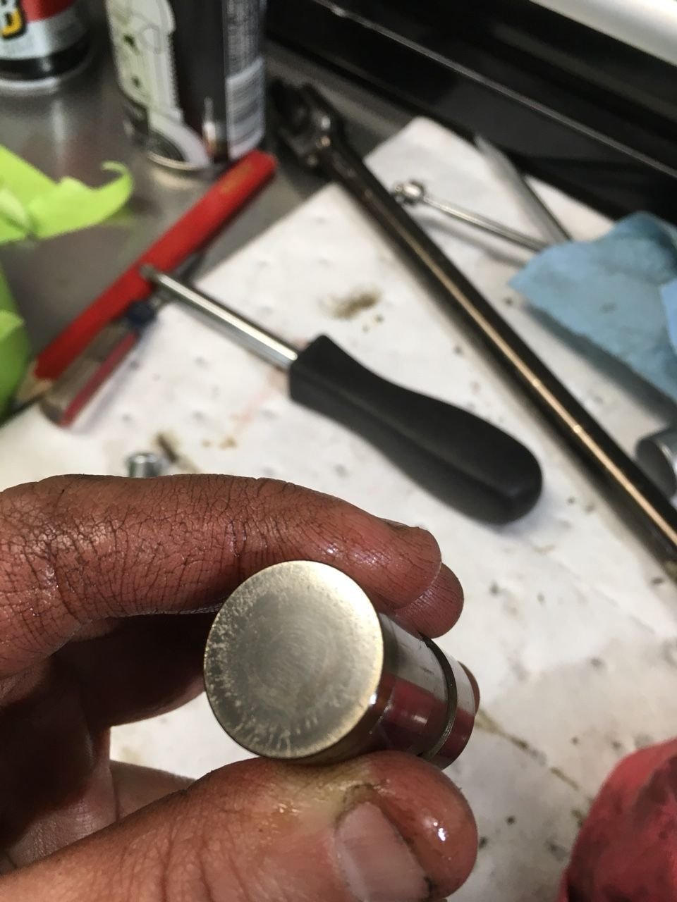

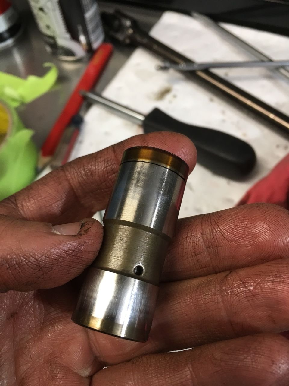

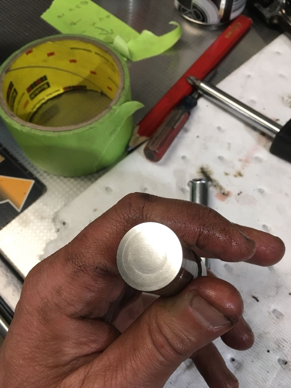

I started a head-gasket job job on the 04 Disco and just came to finding this last night (see pictures).
I’m really puzzled. All the worn lifters (and one appears to be pitted) are on the driver side and what do I do now? The pictures show the worst ones. The cam appears nice, I think the colour difference is just oil staining where the lobes don’t contact the lifters.
Can I just put new lifters on? Do I have to replace the cam? How do I do that with the engine in...

That is a surprisingly clean looking cam, but with the lifters being dished I'd worry about the wear pattern on the cam. A little aftermarket cam can be a nice performance bump from the factory one.
There are probably videos online about replacing a cam. Doesn't have to be Land Rover specific. You'll have to remove the radiator and AC condenser to don't in the truck. Front cover, timing chain, and retaining plate will have to come off. Someone remind me if I'm forgetting something.

Cam is easy...cam bearings, not so bad either, cam bearings in the truck, it can be done, but I would not want to have to do it.
It's been done, but the guys that have say it's a big pain in the ***, and I would agree.
I have my engine out of my 04 now, about to start reassembling the block.
I had the machine shop put in new cam bearings when they honed the cylinders. Looking at the block, the first 4 cam bearings should be no problem in the truck.
The last one, at the flywheel end, is the one people say is difficult, and it may be.
There is a freeze plug on the back of the block. Removing that freeze plug makes installing the last cam bearing easier...but of course you can't get to that with the engine in.
I also here good things about the Crower cam from several members. I bought one, so I'll find out soon enough.
Crower claims 20-22 hp and 30-32 lb ft of torque.
Regardless of actual gains, it should be noticeable.
So, you may want to consider it.
Otherwise, if the cam lobes look ok, you have no bearings walked out(remove oil pan and look up at them), then putting new lifters on a worn cam isn't terrible. It will be ok.
