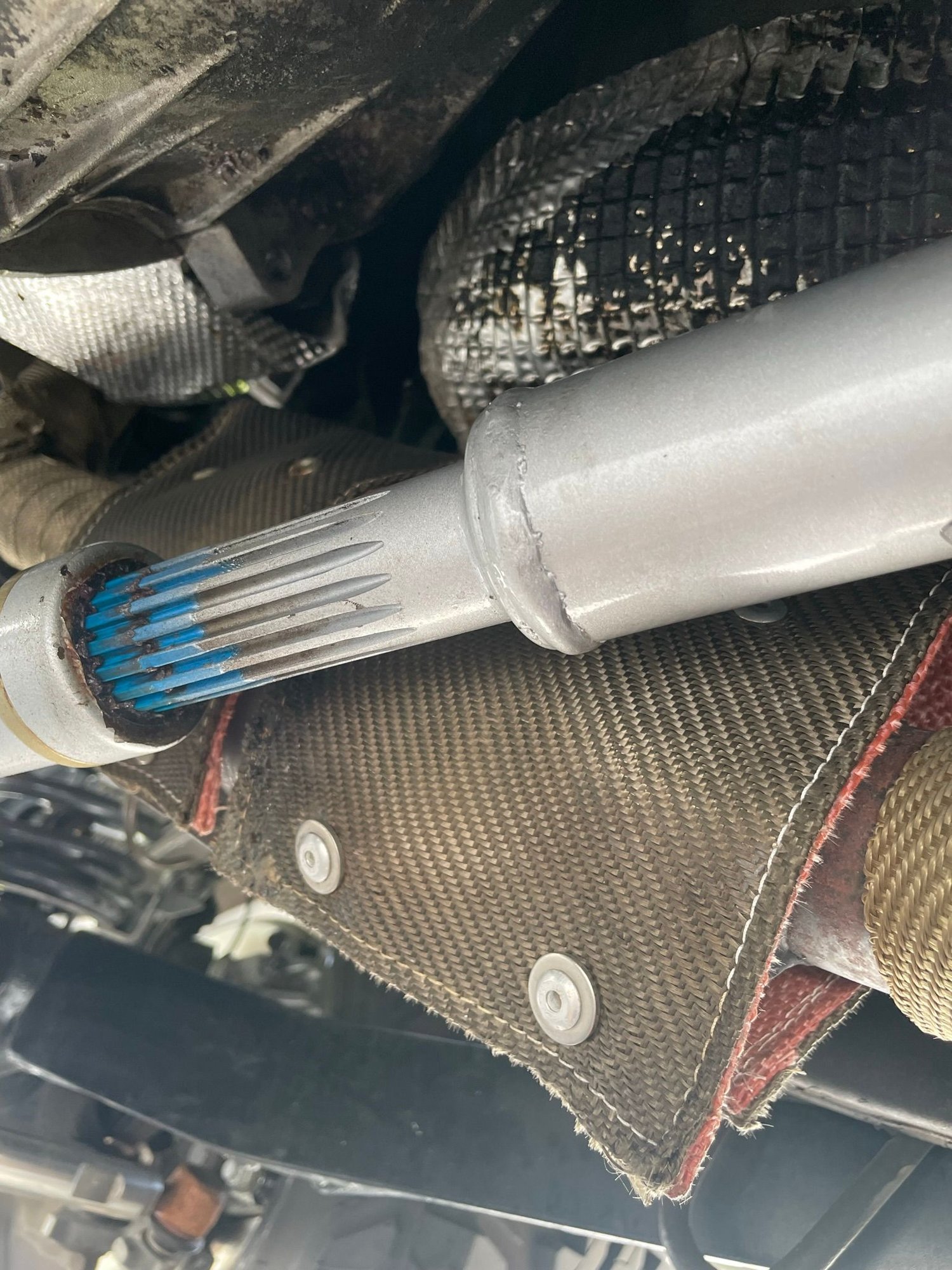

Here is another option. These are just fastened using stainless zip ties. No issues with loosening for a few years now.

XRAD, there are these tabs that the bolt goes through, then the metal strap (red circled items).
