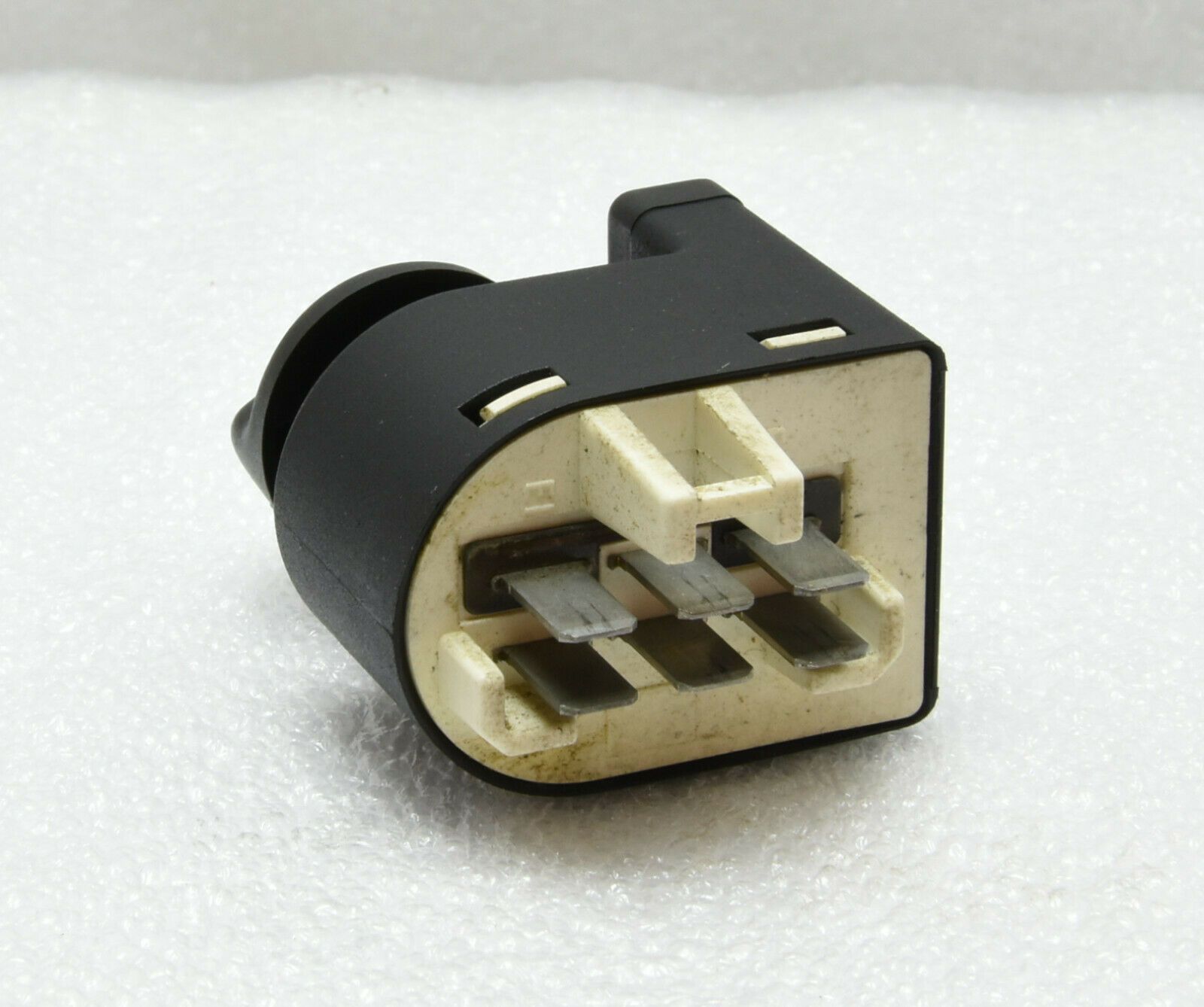

you will need the European headlights. I have the switch. You can find them on ebayUK. I don't know if there is a 'control unit' for the lights..... From what I have read, most EU drivers just leave them on one setting anyway......

I am ahead of the game then, I actually already have the euro-code headlights. Which, btw, are a fantastic upgrade over the standard US spec lights. I did not know that a non-projector headlight could have such a sharp cutoff. I just bought the switch, now to get my hands on the actuators.

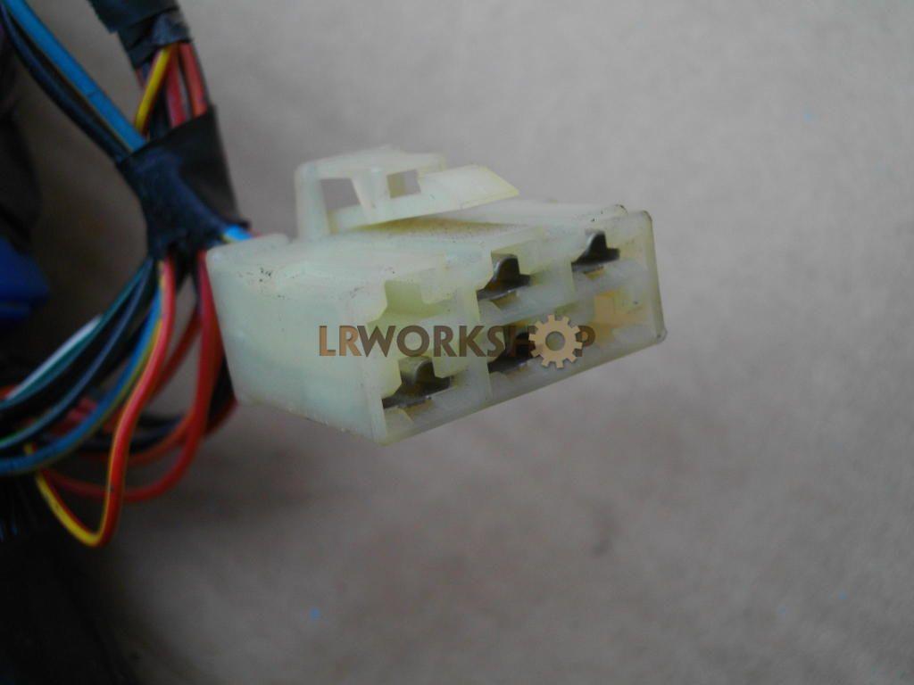

..... and you may need the connector (and therefore all the wiring) for the harness if you have a US spec vehicle. My disco does not have the wiring or connector. You can easily get the switches. I'm having difficulty locating an OEM harness connector but I can probably find one that works. Pretty simple spade female connector.... Mine got lost in the mail from england.....
