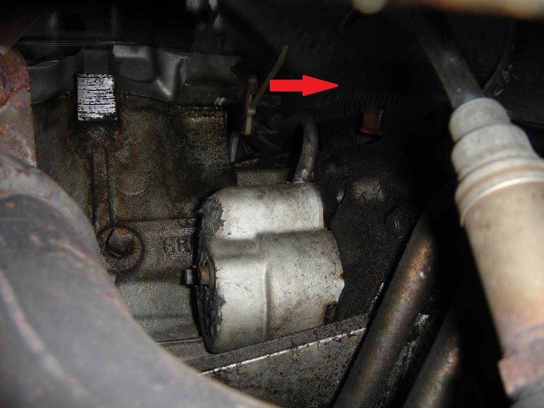

Originally Posted by LRDISCONEWBIE777
Found were the CPS is located. Took the Exhaust off and hell, my hands are still too big to work in that tiny space. Been trying for a few hours now. I've already got to experience the process of replacing the ignition coils and the old ones are still behind the engine block. I built the plug wires myself and the ignition coils were relocated on a bracket that a made myself. I'll try a new fuel pump first and if that does not solve the issue, perhaps I can find a way to bypass the CPS.
Whoa man, you really want to hack your truck up don't you?
Why didn't you just take the upper manifold off and replace the coils? And a CPS is way cheaper then a fuel pump so I wouldn't go replacing it yet. You can't bypass the CPS so you'll just have to figure out a way to get to it.
The CPS plug is connected to a bracket. You pry the plugs back toward the rear of the truck I believe. That should release the plugs (still connected) from the bracket. Then with one hand, reach up to the top plug and press in and hold the locking tab on the plug. Then with your other hand, gently pull down on the sensor and they should pop apart. It might help if you take the sensor off first before you try and unplug it. That way it might hang down a little further and give you something to pull on after to press the locking tab in. Hope that helps.

I did notice how condensate drips/runs onto the CPS. So, when I install the new one, I'll make it water tight.
