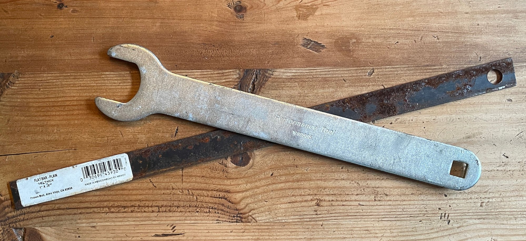

Here’s what I did instead of buying a fan clutch tool.

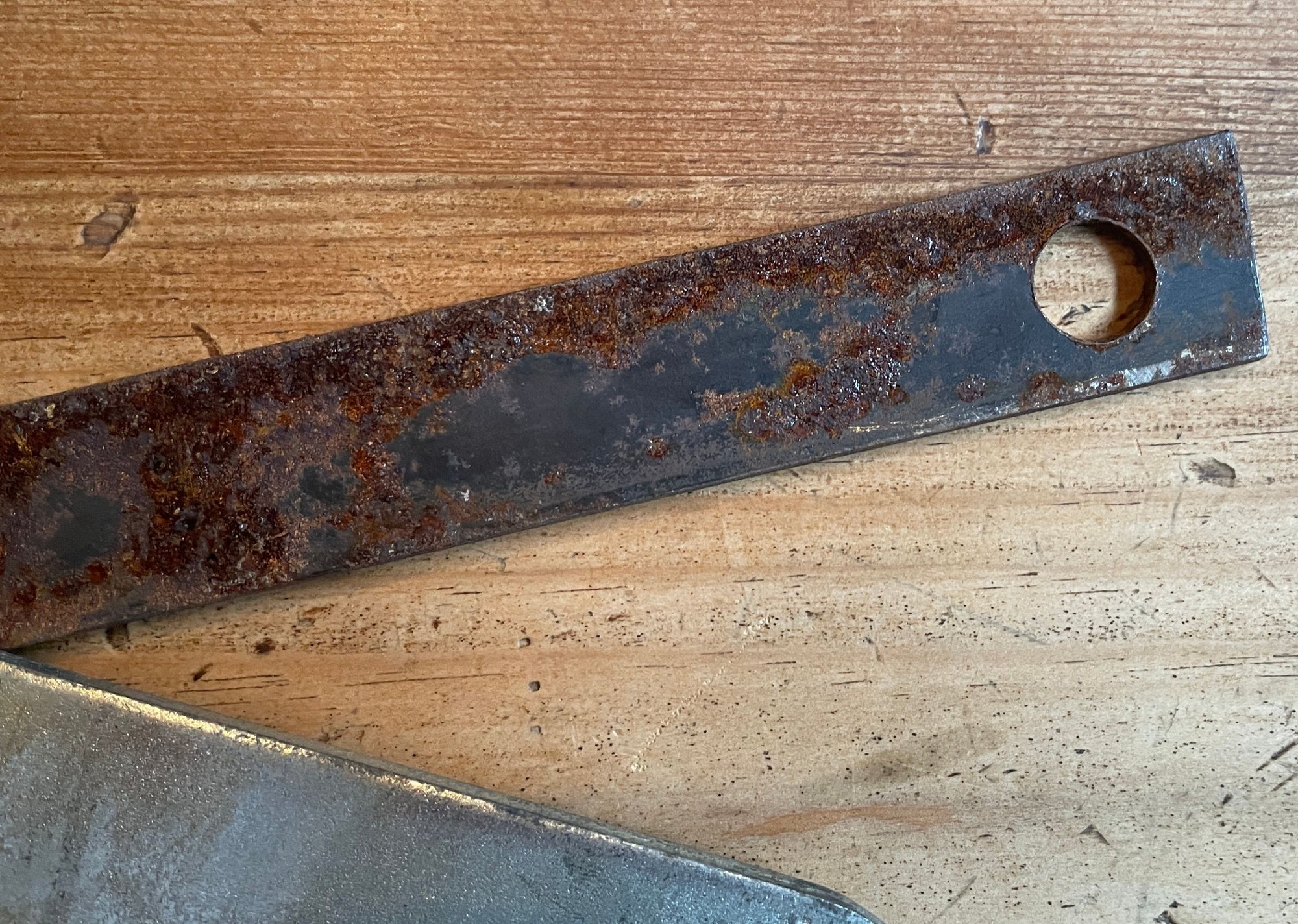

I had a piece of 1” steel bar stock from Lowe’s lying around. I drilled a 3/8” hole near one end.

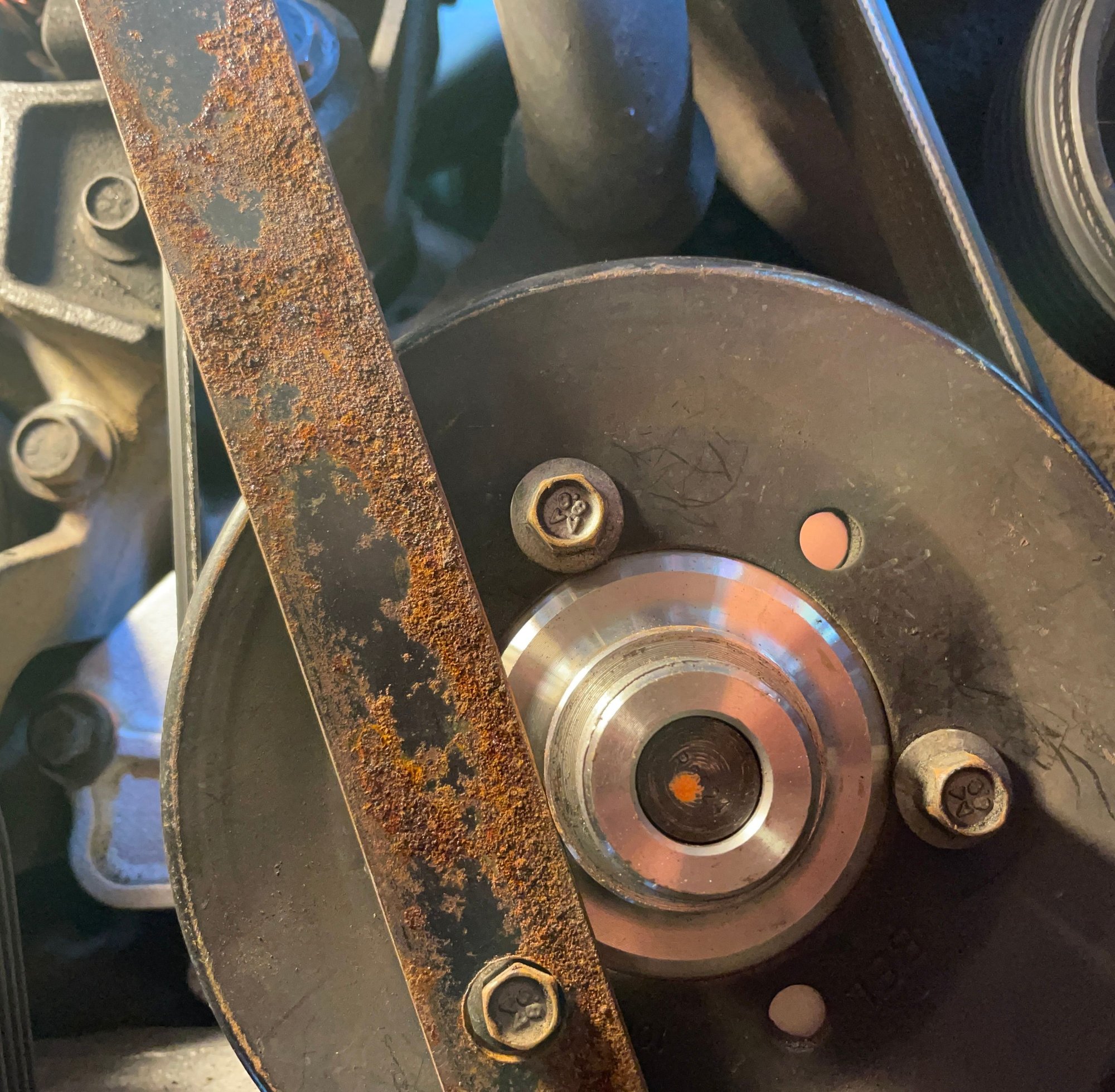

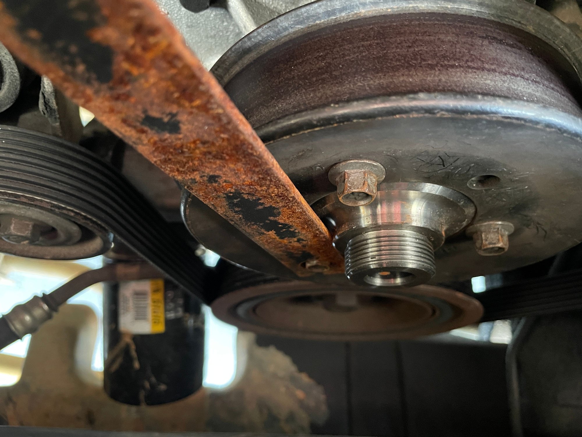

I slip the hole over the head of one of the pulley bolts at about the 7 o’clock position as viewed facing the engine from the front, as pictured. (I removed the fan to make it easier to make the photos.).
I “lean” the tool toward the right against the water pump hub to provide clockwise resistance to the wrench turning counterclockwise.
Inexpensive. Easy. Works great. I hope this helps someone.

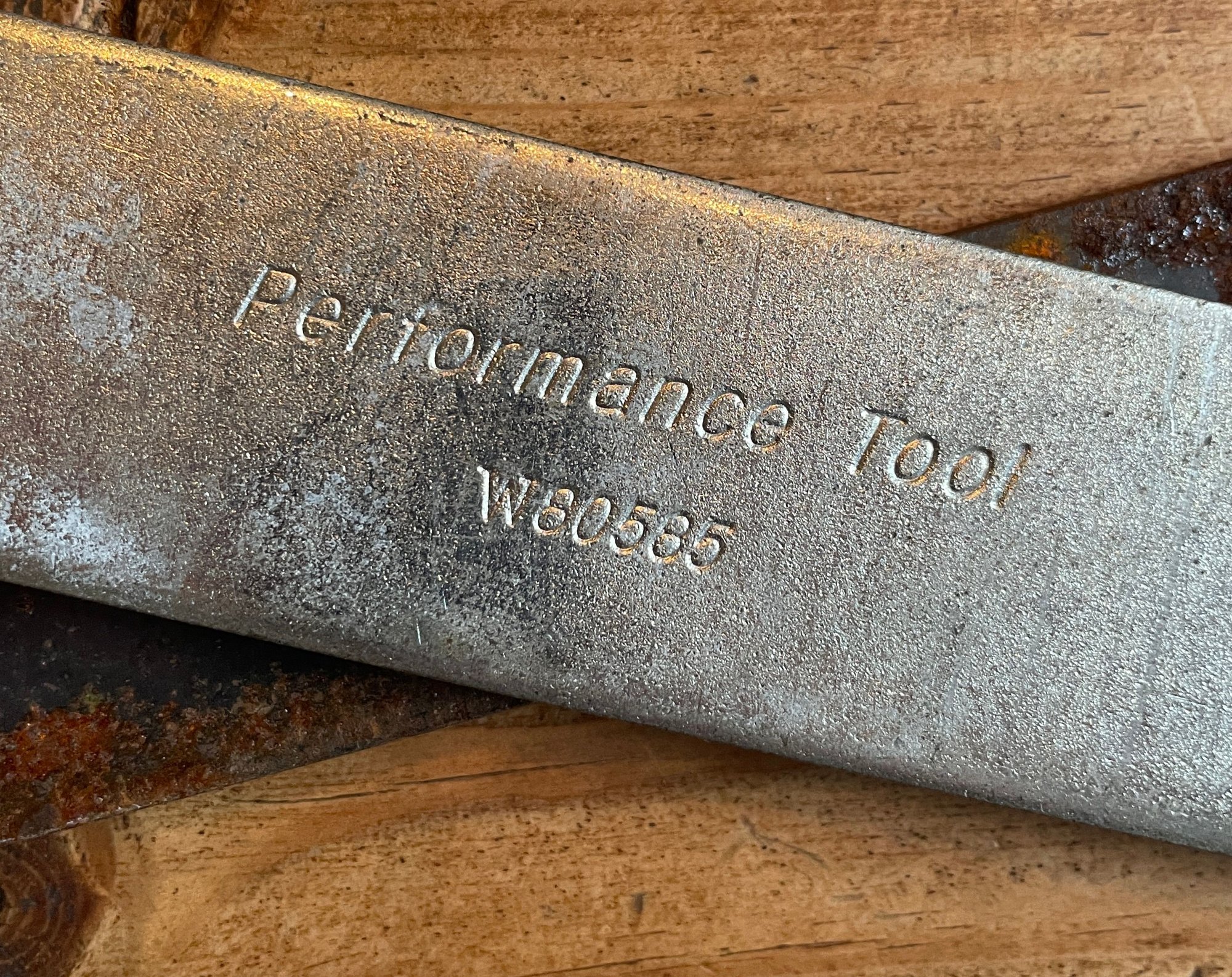

I don't recall where I bought the wrench. It was a few years ago. I didn't have a Crescent wrench that would fit.
BTW, that's not rust. It's patina.
