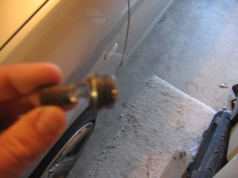

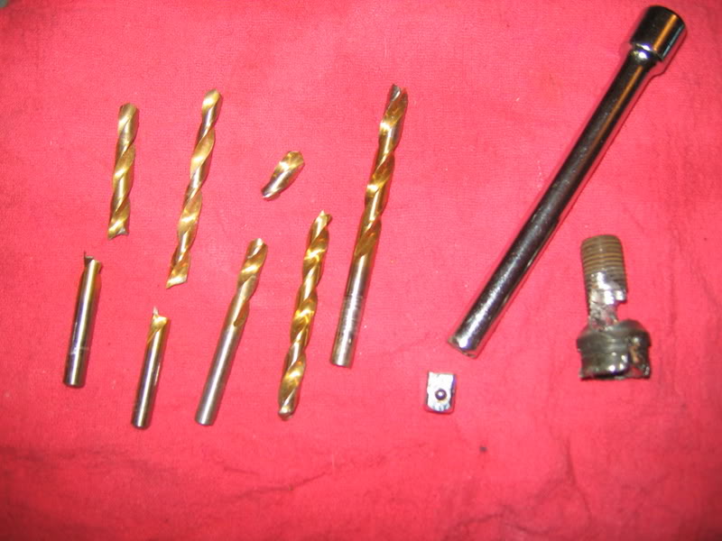

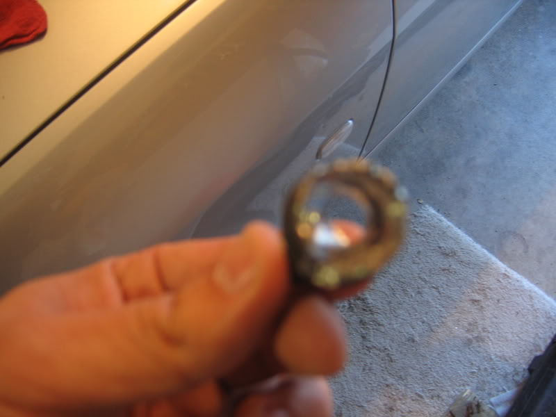

I've used a few things, but prefer WD40 actually. Spray inside, spray the bolts and all good. All you need it is to displace water and prevent rust. I've learned the HARD way twice and never been screwed by WD40. Also apply it to the back of the hub. Without that, especially after a winter with tons of salt, I spent an hour with a rubber mallet knocking it off. I have had two bolts also stuck. One in the winter, and the other after a track day (more heat produced in one lap than the Rover will see in a year on those bolts!). You either go two ways at the track with the intense heat and pressure... sometimes you need to re-torque the wheels, or they get welded on there. I used a brush on anti-seize with that one that got stuck. Stuck with WD after that Here is the carnage after rounding out the punk ***...
This was my previous Audi 2.7T. Spent 2-3 hours carefully drilling it out to not damage the wheel:
