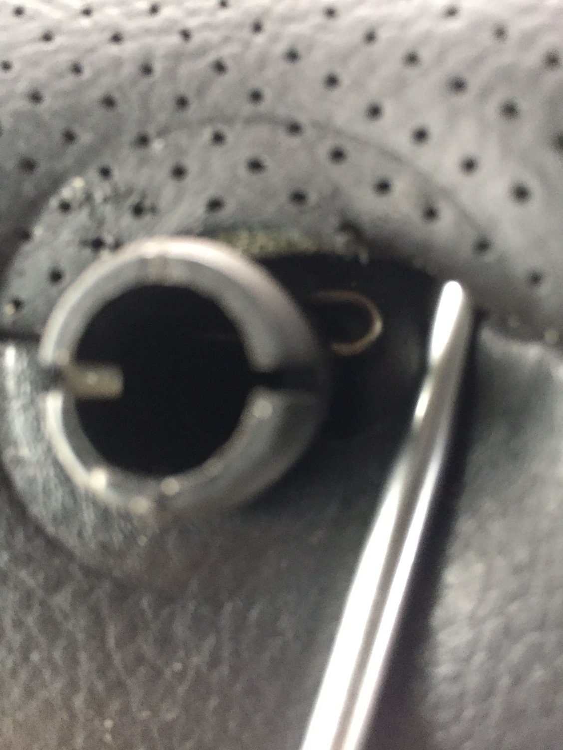

Start by removing the headrest and seat mounted grab handles (2 per seat). Slide a small screw driver under the headrest post cover to pop a plastic snap finger and release the post cover
Once you've released the plastic post cover, push on the metal clip to release the headrest post. I took this picture after I removed the headrest to get a better view.
