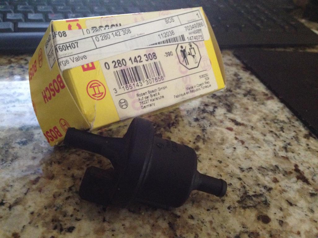

Old Sep 4, 2014 | 04:00 PM
overover02's Avatar
Joined: Mar 2014
Posts: 97
Likes: 12
From: Atlanta, GA
Originally Posted by Fast951
Thanks. I'll wager your Bosch valve has 0 280 142 308 printed on it, so I'm going to pick one of those up for $40 online and give it a try. Seems to me the BPUtah part and this one are the same. We'll see.
And yes it does... I wanted to make sure that I was getting Genuine Bosch in a retail box (made in Czech Republic and NOT China). Too many things peddled as something they're not out there. Hopefully you'll be able to score the same for less.
