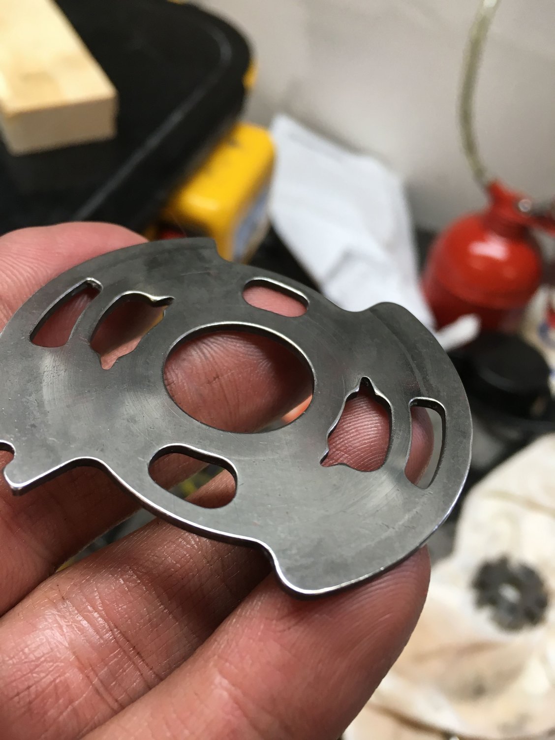

Well it didn’t work. If I don’t want the drag it doesn’t seal (at all). I inspected and when it ran dry at first it wore some grooves in the plate. You can see from the picture. I suppose that makes the extra drag and too much leak by. These pictures are after I polished the plate a bit.
I ordered a rebuilt one by A1 Cardone.
Cheers
