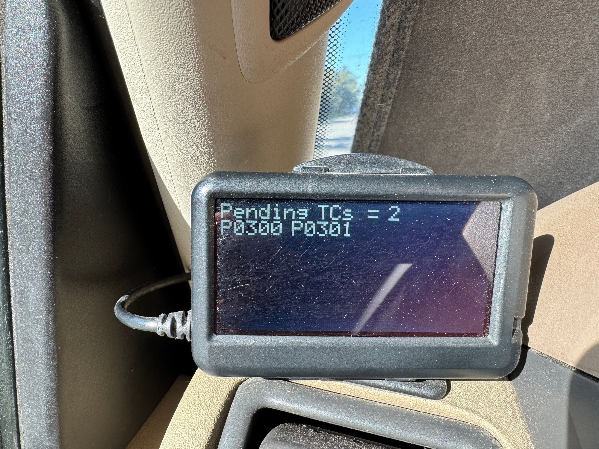

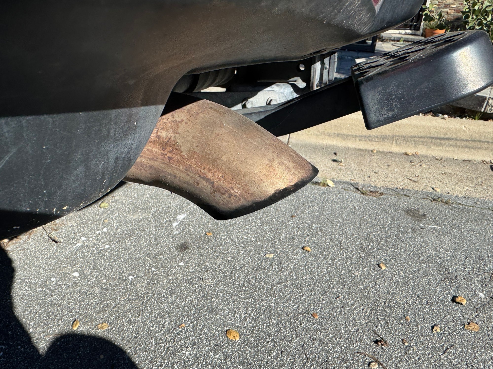

Disco has been running like a well tuned beast the last year or so, but very recently I started noticing a lot of soot accruing around the tailpipe tip. Then I got a P0300 and P0301 as pending codes today. The codes seem vague, but perhaps with the sooty pipe that might point to something more certain? MAF and O2 sensors were replaced in 2014, and 75K miles ago. Wonder if those might be where I start looking?

Maybe focus on cyl #1 (P0301). The random code (P0300) is often generated when any single cylinder is misfiring. Check items mentioned above, but always a good idea to monitor O2 trends.
