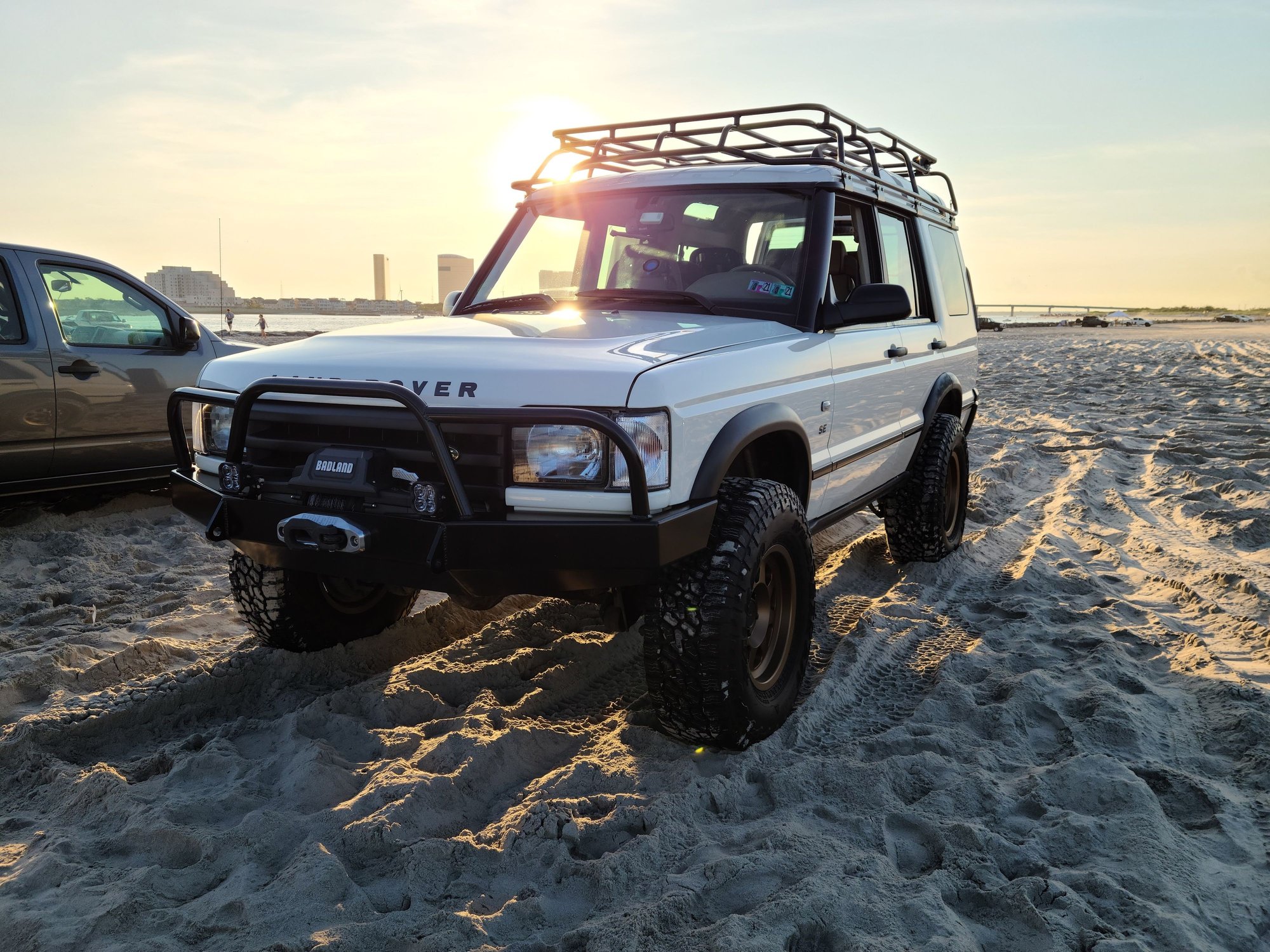

Bought this truck right before the pandemic started bone stock with 59k miles.
5 months later here she is on 33's. OME HD lift springs, 1" spacers, and fox shocks. No rubbing.
