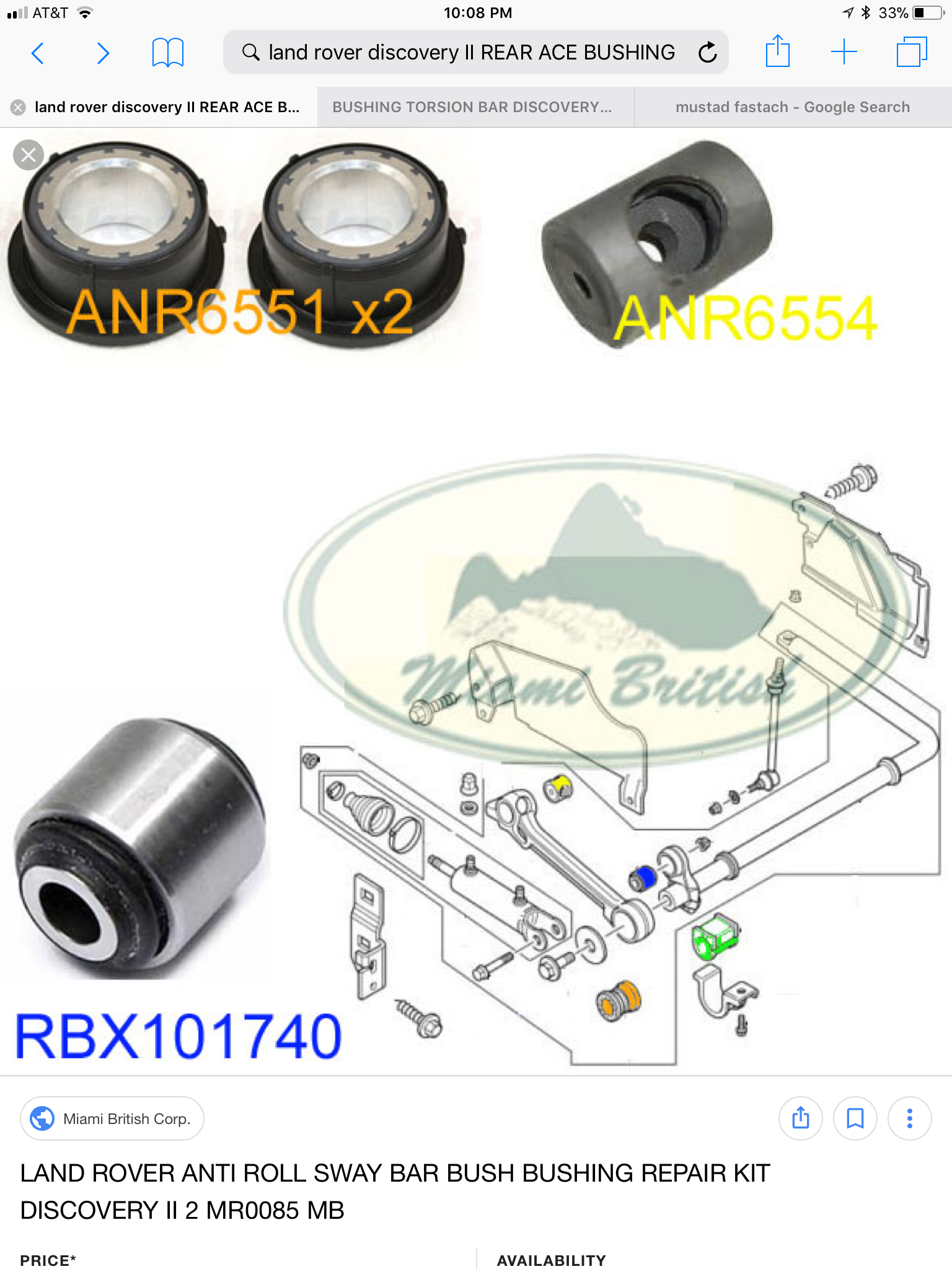

On the top of the rear ACE piston there is a bushing where is connects to a bracket. I can now say that it’s the source of my clunk.

Could be, but climb under the rear and take a look at the bushing in blue.
Attached Thumbnails If you have the clunck when you get back on the gas, I found the culprit-41130d51-8076-439e-8daa-15229a4e748e.png
