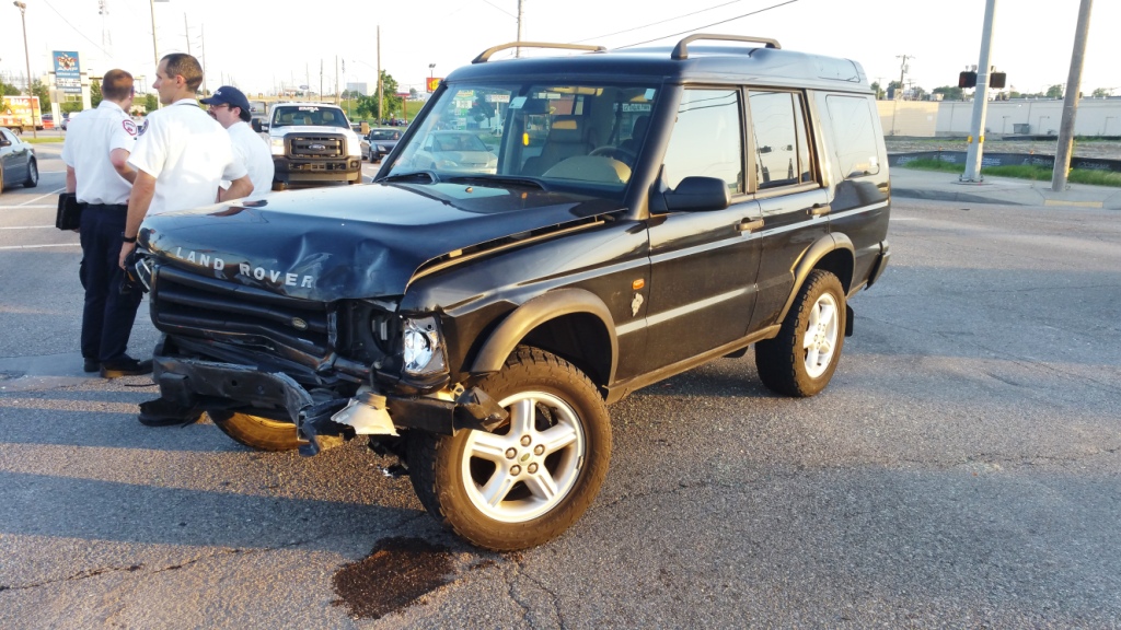

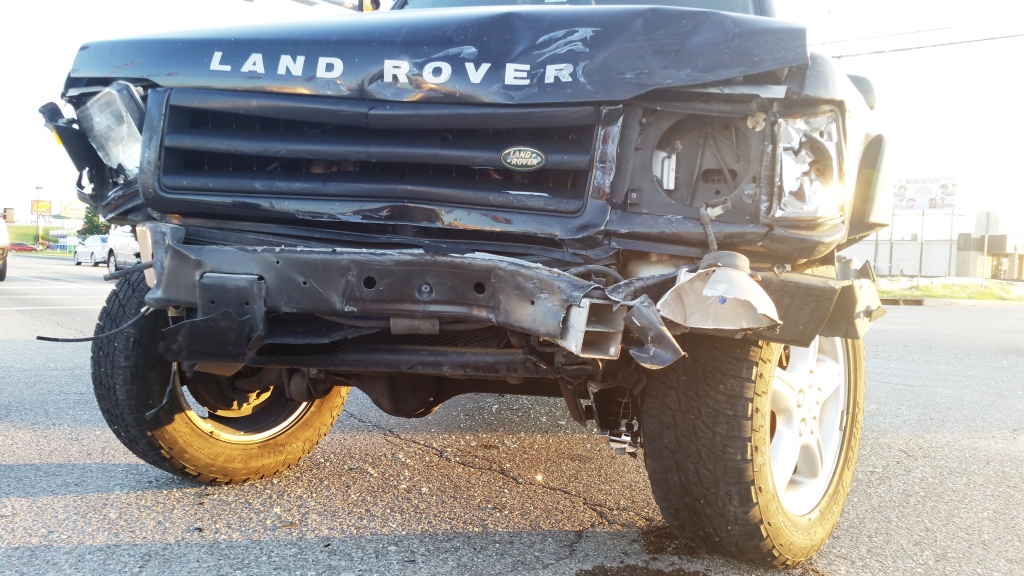

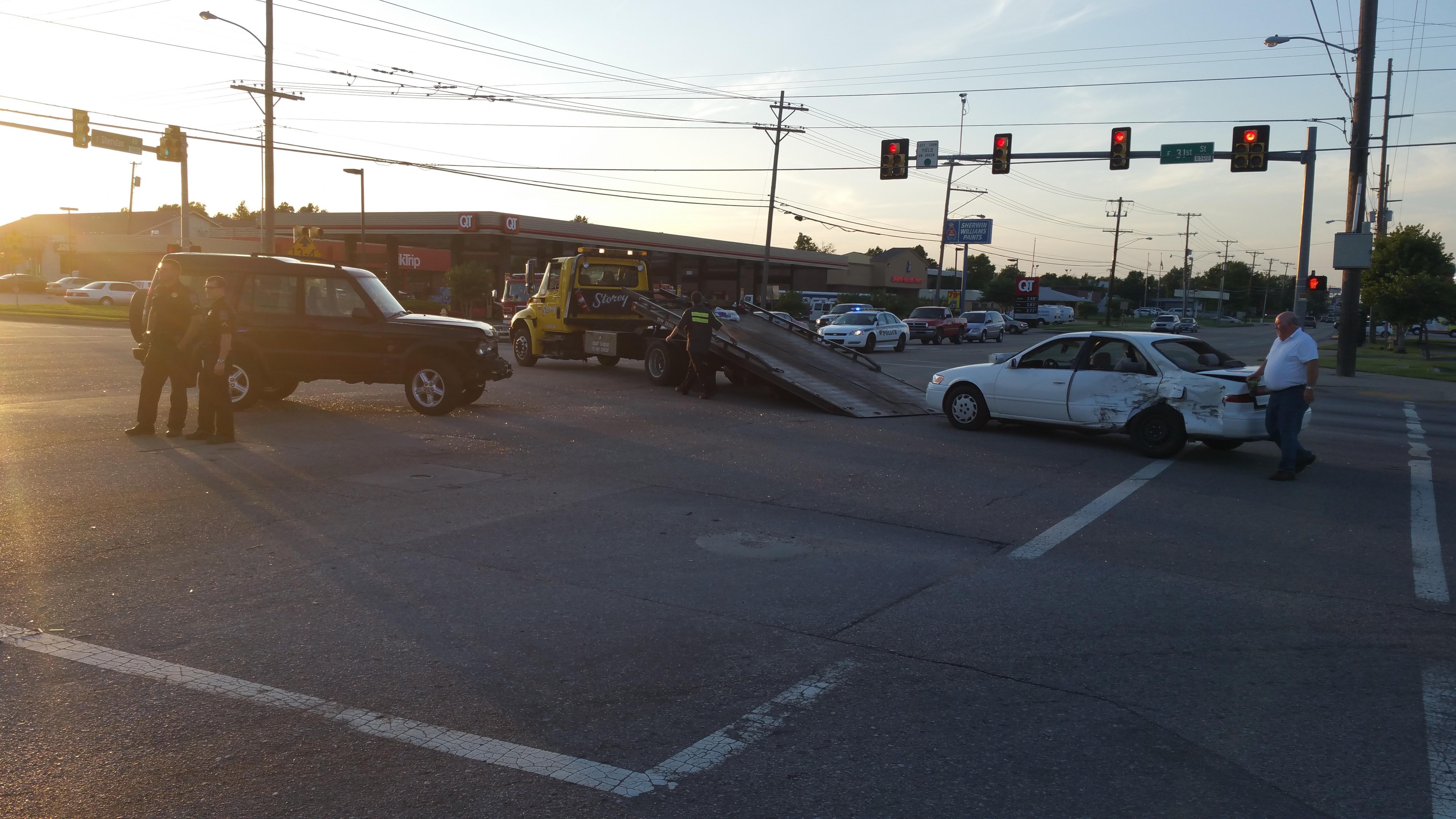

Oh, by the way... this is what crush cans are used for... This happened to me last night at 7:30... lady ran a red light trying to "shoot the gap" in traffic and I smacked her doing about 30-35 mph.
Attached Thumbnails That jeep bumper is the tits.-20150625_201517.jpg   That jeep bumper is the tits.-20150625_201307-2-.jpg   That jeep bumper is the tits.-20150625_201316-2-.jpg

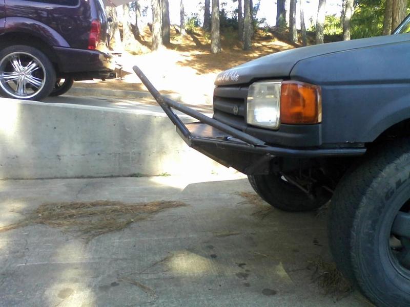

Originally Posted by RoverMasterTech
O.k. Mr public works guy, tell me how many lbs. angle iron will hold before it fails.
So I was right, it is angle iron. The the mounting is even worse that I originally thought.
The weight doesn't have a lot to do with it. Very lightweight angle iron can handle a lot of stress in a well engineered assembly designed for the types of expected stress.
Those mounts are not well engineered for the stresses a bumper can encounter.
I'ts obvious the frame will rip apart before welds or bolts would fail
True
[QUOTE[]we're past that.
Not really, since you appear to not be really aware of or are forgetting how welded joints behave.
In a good weld joint the base metal will nearly always fracture before the weld will. That does not make it a good joint design.
In your mount you have a weld along a thin area of base metal.
In a bolted mount the bolts pass through not only the thin chassis material (that you welded to), but also the heavier reinforcing material the chassis engineers added to support bumpers being mounted.
The thin chassis rail is not designed to have bumpers mounted to it.
It's also obvious you don't really understand, or are intentionally ignoring, how the dynamic stresses in a recovery work.
In a kinetic recovery not only is the recovery vehicle applying force, but the strap or rope itself, by design, is applying tremendous force by it's elasticity to extract the stuck vehicle. If the strap can apply enough force to a 4,000lb truck to get it unstuck, it's not going to have much trouble moving a bumper weighing a couple hundred pounds.
