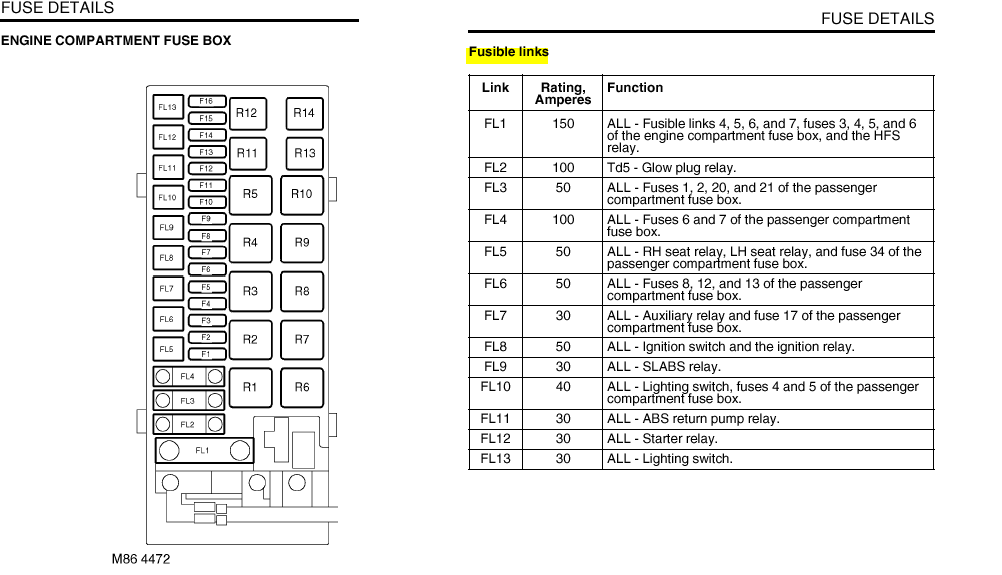

Did you check the 150A fusible link?

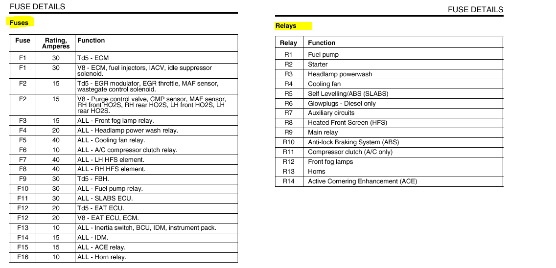

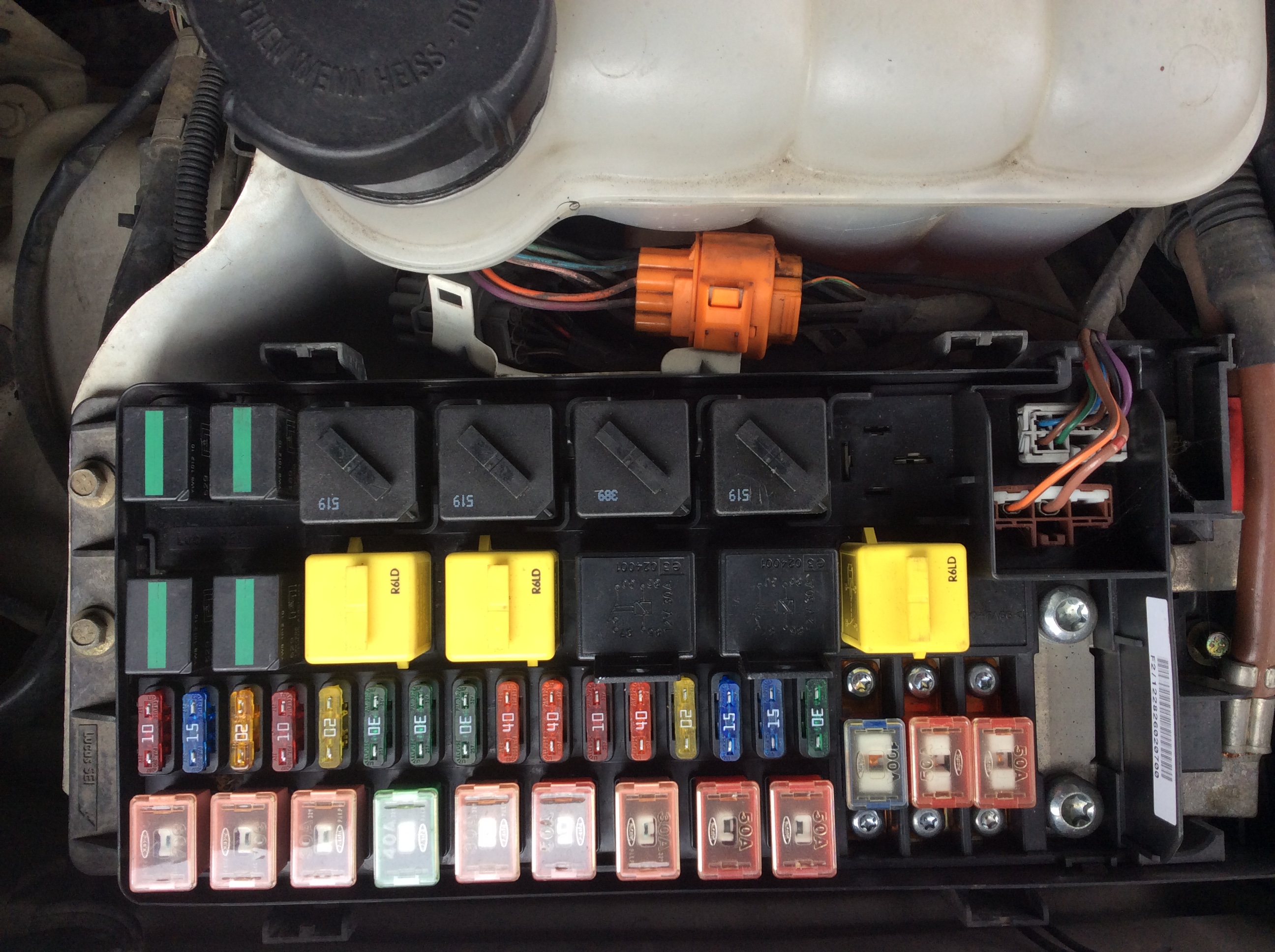

Where is this link located? There are none marked 150A under the hood. See picture.

Old Dec 1, 2017 | 01:27 PM
JUKE179r's Avatar
Joined: May 2016
Posts: 3,969
Likes: 859
From: Britainistan, UK
It's the silverish one on the lower right. It looks good but still check your cables and connections.
