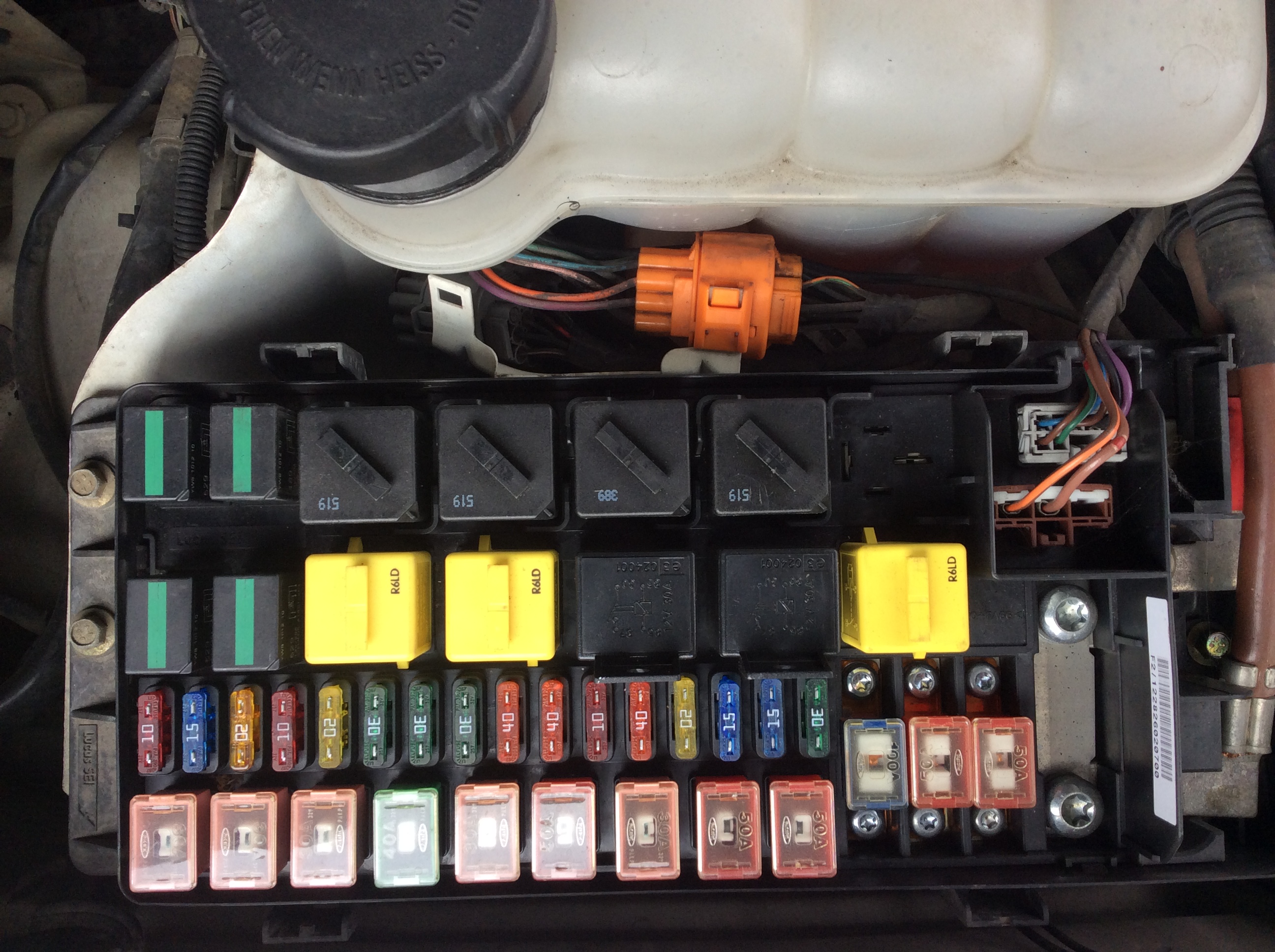

The mega 150A is the metal strip in this picture, correct?
Attached Thumbnails Jumped off truck and did - to + . I already knowi a-image.jpeg

Mean jumper wire for switch. Don't forget doing basic TS first.
FL1 is metal strip.
