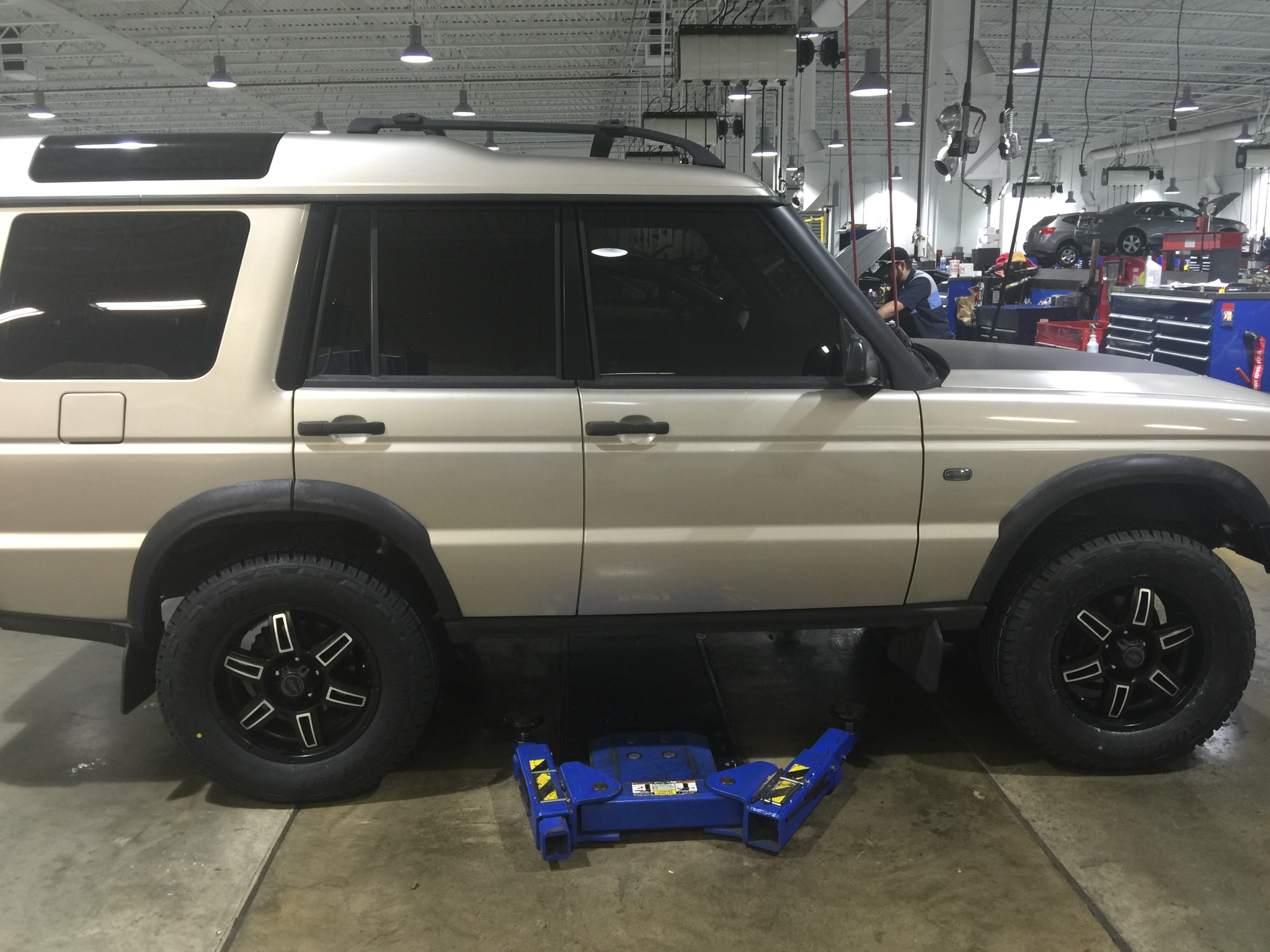

Alright so it's been a week, truck still in the shop. You guys were right about coil, the number 8 wire on the new set was cut! So we swapped out and it runs and sounds amazing! However, long story short, a power steering suction hose and the radiator nipple are broke. Parts ordered, hopefully done by next Saturday. While in the shop I did swap to some new tires that fit the lift better. 275/65r18 goodrides, cheap I know but they are doable.

Here it is with the tires.
