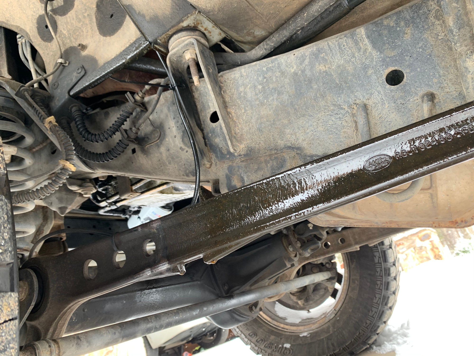

Hi, I’m an owner of a new-to-me Disco2 and experiencing a slow leak under driver’s side. Fluid is brownish color but can’t determine if Oil or power steering Or brake Fluid or.... It is dripping to ground off of front radius arm on drivers side but source is above that. Thoughts?

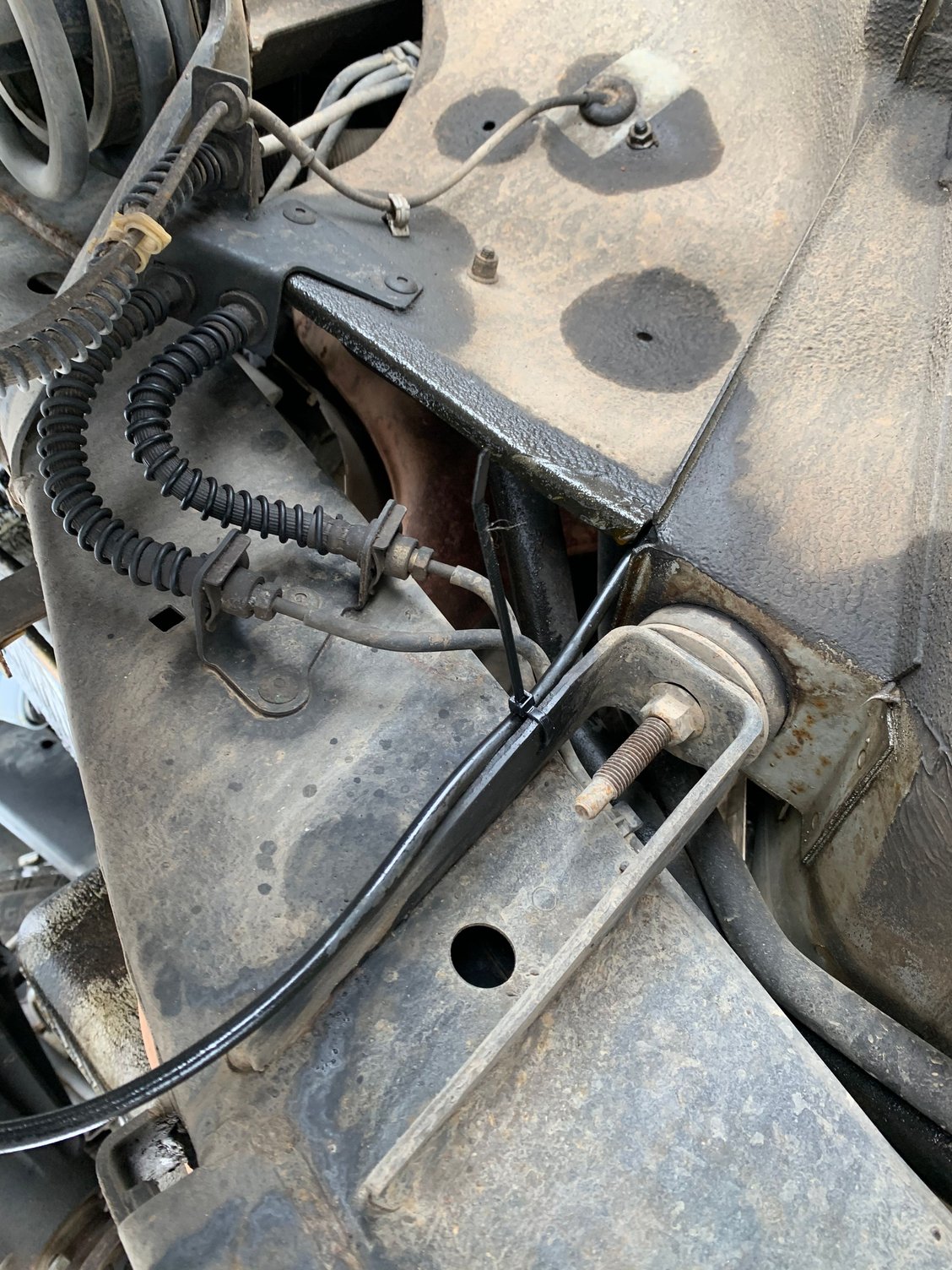

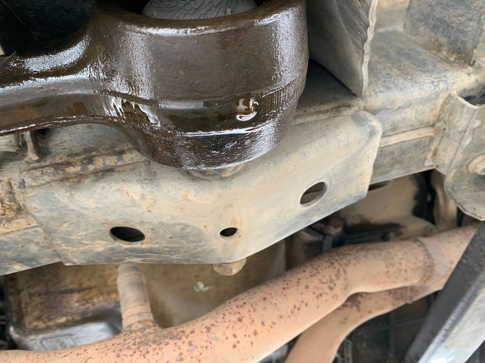

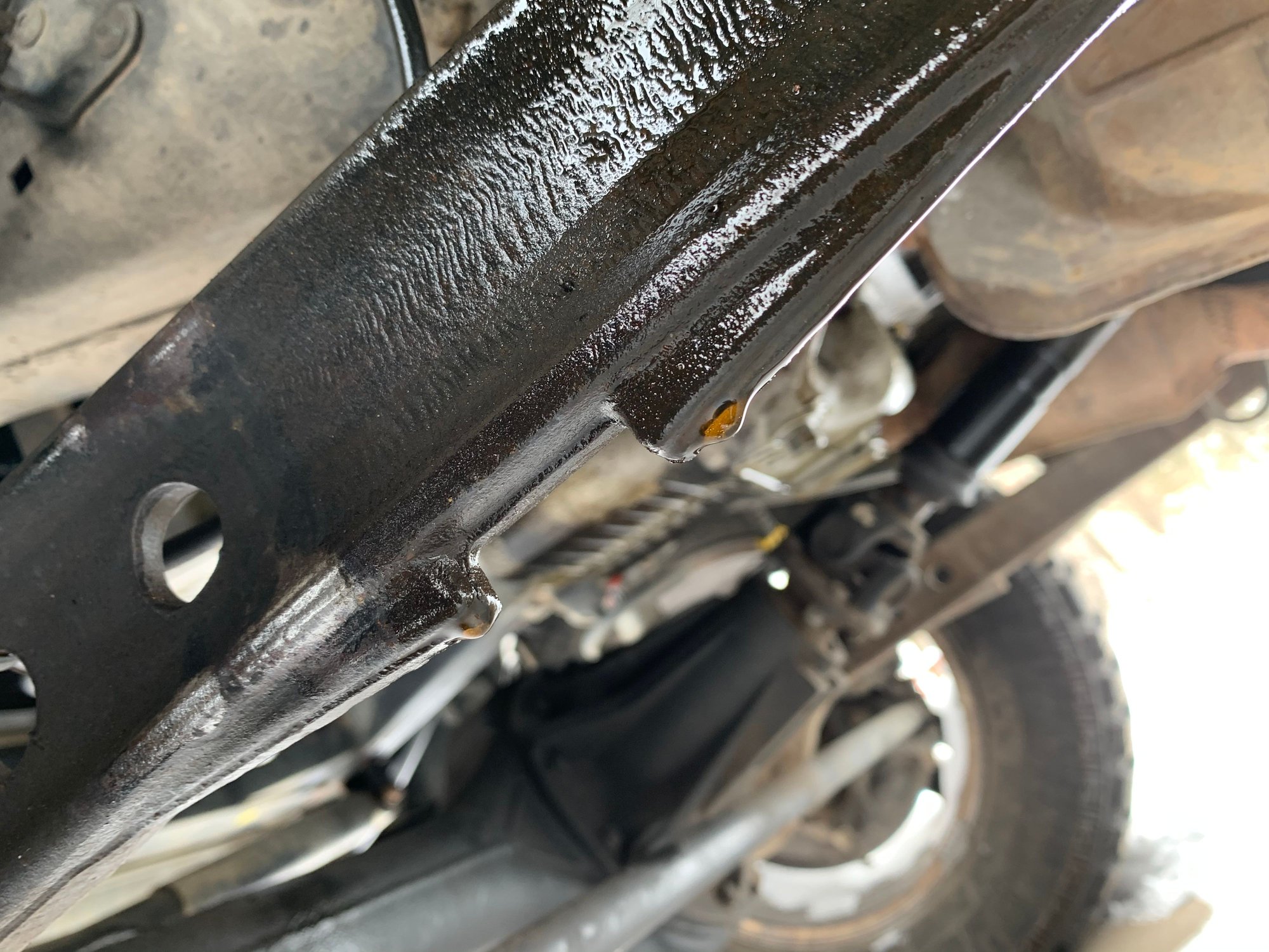

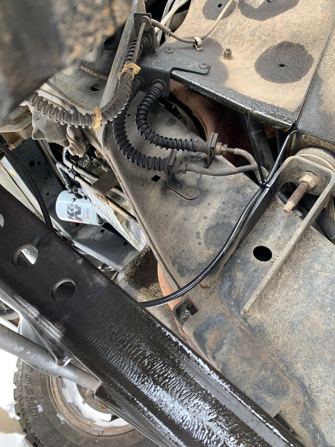

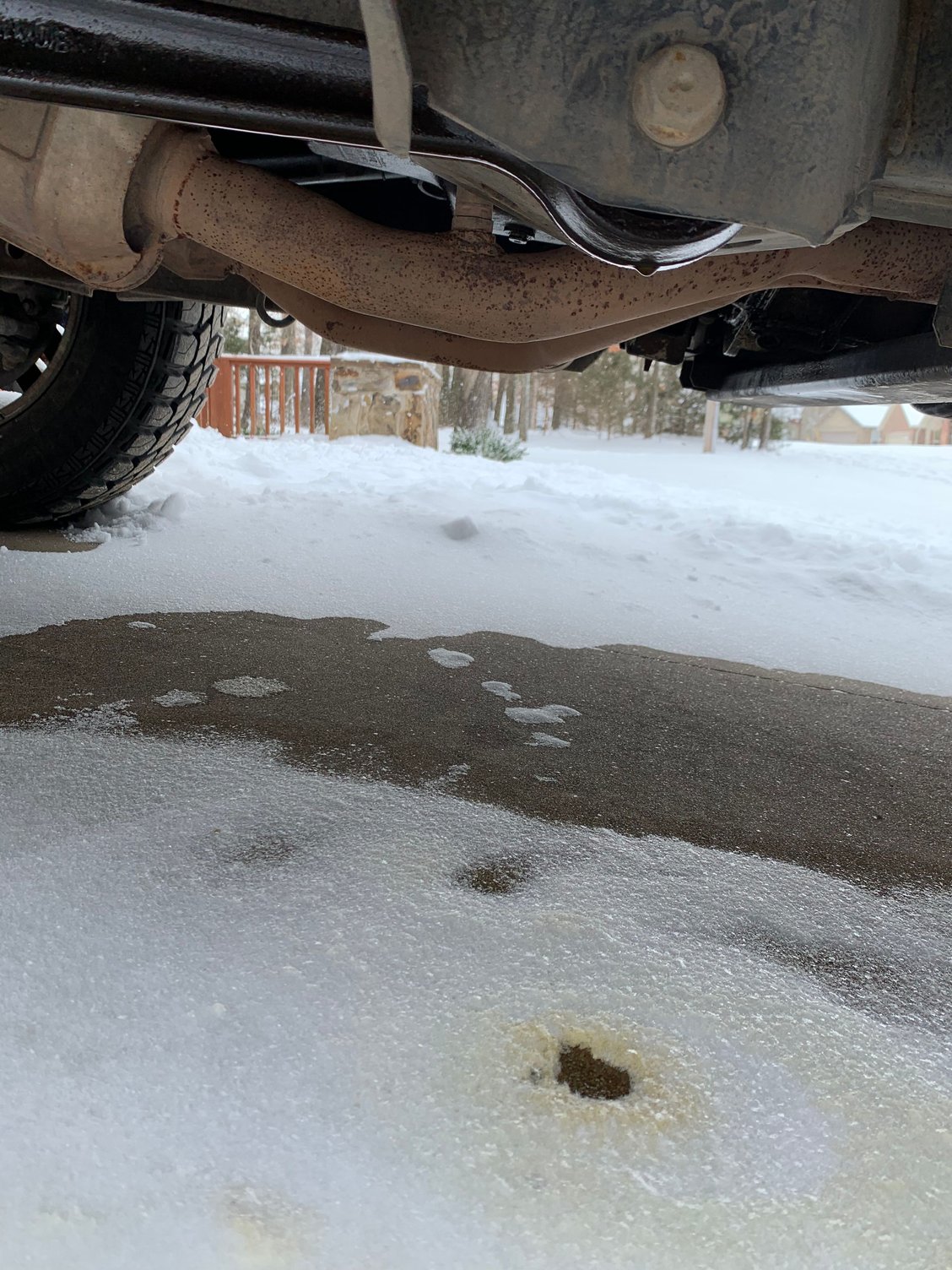

Originally Posted by DiscoID
Any chance of some engine bay and underbody pics showing the spots that you're seeing the fluid? Also, have you tried degreasing/wiping down any areas around obvious moisture locations?
Fresh snow helps to see leak
See attached! Do these help?

Sure looks like brake fluid to me

That looks like master cylinder to me. Brake fluid can be cleaned up with water easily, so give it a try.

Yeah, looks like brake fluid. Another good way to determine what's leaking...is to check fluid levels.
But yeah, wash down area, master cylinder and booster and underneath, let area dry, add fluid and apply pressure to brake pedal...and see if any new areas of moisture appear.
