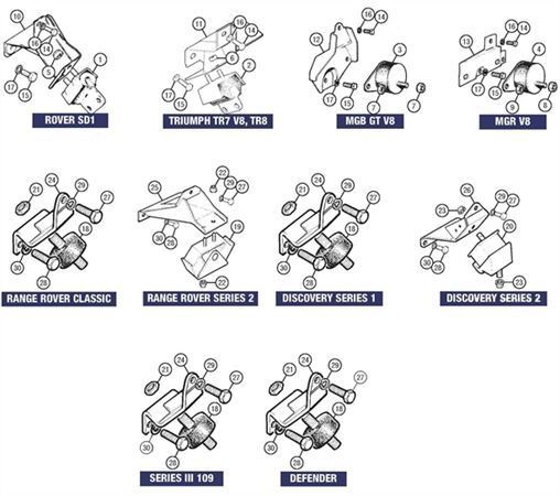

I was crawling around under my Disco today to drain the coolant, block drain, and discovered that the Left side engine mount bracket was missing a bolt and a 2nd one was about to fall out.. I've looked and can't find the bolts for sale... Is there anything special about them, can I just go to Ace Hardware and get some bolts (#3 7/16UNC x 1 1/8)?

Nothing special, just get Grade 8 or better.

Uh ... the motor mounts don't have bolts on a DII. The "bolts" are part of the mounts and nuts screw on to them.

It sounds like the OP is talking about the 2 lower bolts for the motor mount bracket ,and not the nuts for the mount.
Exactly

#28 and #30
https://rimmerbros.com/Item--i-GRID800033
