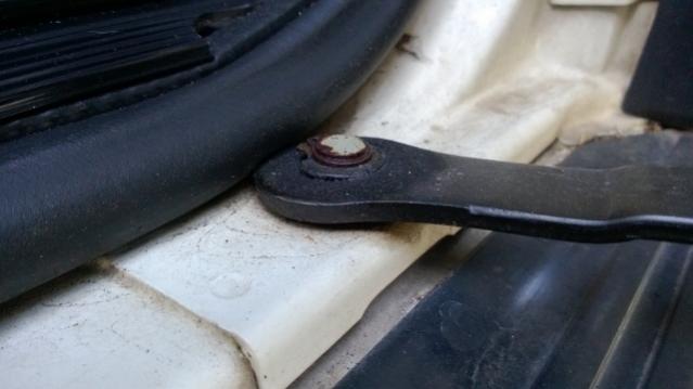

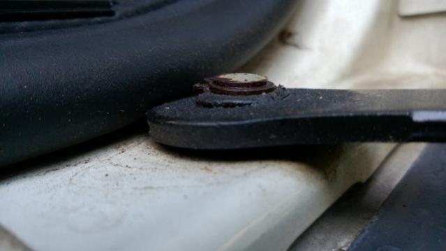

You may just need the circlip: CIRCLIP REAR DOOR CHECK ROD DISCOVERY II, RNN436, BYV100000 - Land Rover Parts | Rovers North

I'll try and get a pic, in the meantime look under the door and you will see how it works. That bit with the hole in it moves back and forth on a track that is bolted to the underside of the door. You will have to get the end to slide all the way to the left (towards the hinges) in order for it to have enough reach to get to the peg with the door open. You may also want to put some grease on the track while you are down there as well.

Photos:
Attached Thumbnails My rear cargo door opens all the way-doorstop-01.jpg   My rear cargo door opens all the way-doorstop-02.jpg

Oh its on a track, thanks CC and thanks Super and Zack. Funny how something so simple can become an issue. Zack I have a few of those so now that I know its on a spring loaded track it will be an easy fix. Thanks again everyone!
